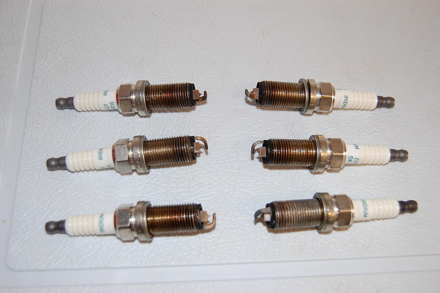

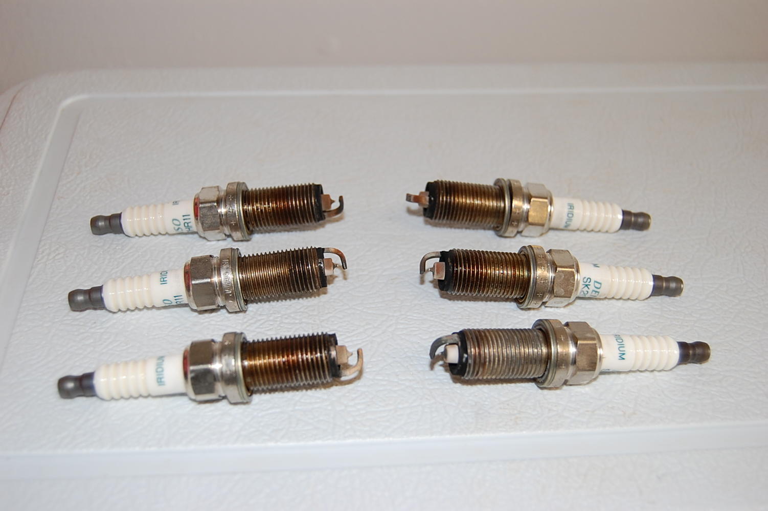

2010 5th Gen. Spark Plugs - 117900 Miles
Just changed my plugs in my 2010 4-Runner Limited with 117900 miles. Photos are included. The 2010 has no crap in the way to move. I think this is true until the 2014 with the "air-pump"? A few pointers:
1. Tools Used: Two long and two short 1/4 inch extensions, one 1/4 inch swivel socket, small screw driver, 10 mm socket, electrical tape and anti-seize and I used one new 5/8 socket when I extracted the plugs and an old 5/8 inch socket to install.
2. I taped my new plug socket on the long extension to ensure I didn't leave it behind. (I also glued the rubber plug holder in the new socket with guerrilla-glue so as not to leave it behind.)
3. Looking from the drivers seat, the photos are positioned as the engine cylinders line up.
4. The hardest plug, from the picture looking out is the bottom left plug. After that they are all fairly easy.
5. Hardest part was the removal of the clip wire on the top of the gizmo. Leave the 10 mm bolt in and remove this wire first is a recommendation from me.
That's all and I'm glad I did it. Took me 1 hr. taking my time, checking the gap, using anti-seize and test drive.
BG

Those threads look pretty clean, any issues with any of the plugs being hard to remove/break free at 118K? Sometimes things screwed together and heated to hell and back tend to fuze and become 1 big ol' part.
FWIW I used anti-seize on every spark plug I installed for the 16 years I made a living with wrenches. Always tightened by hand too.
