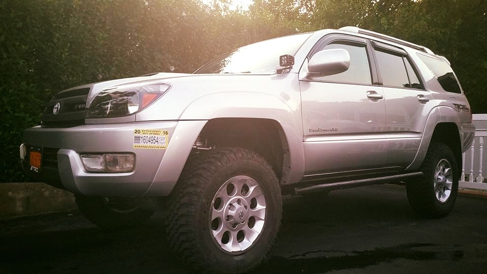

I gotta get rid of these baby 32's and the 285/75 is probably where im gonna end up

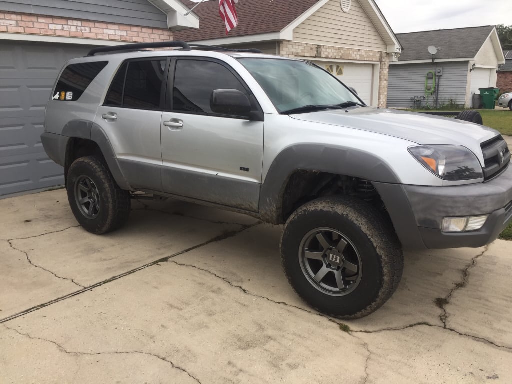

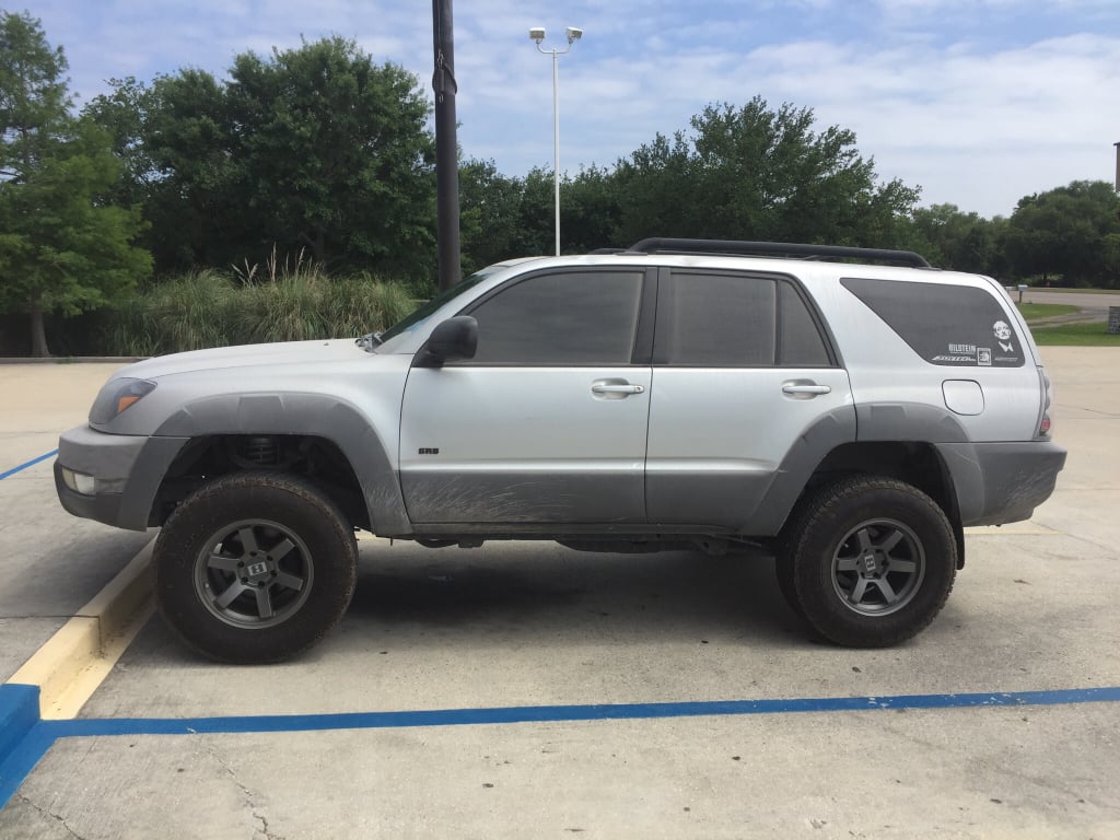

I'm running 285/70r17 Nitto Terra G2's on 17x9 -12mm level 8 wheels. 3/2 toyotec ultimate lift kit.
No trimming, just pushed the fender liners forward and zip tied.

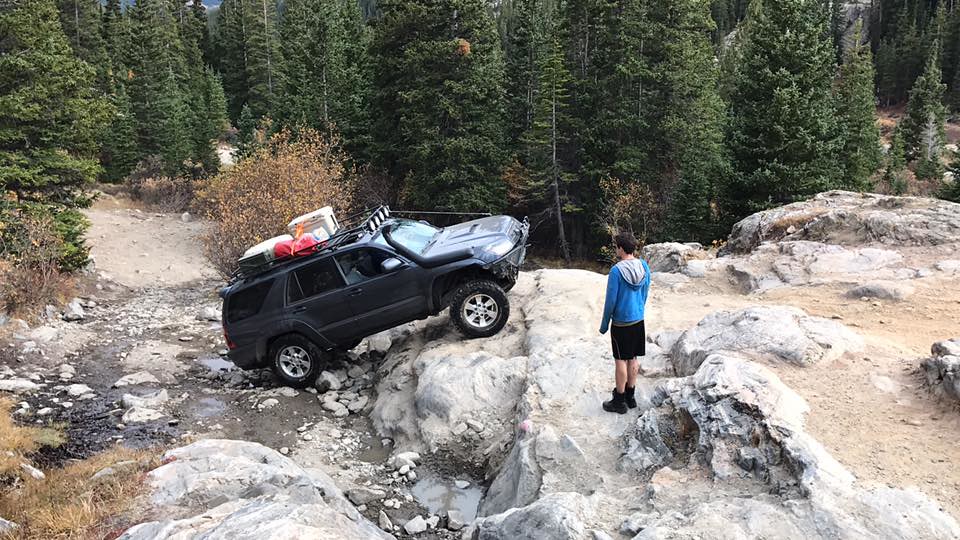

That's a very good, neutral tire size to run. Many different brand options! This photo was taken back when I ran that tire size with BFG AT KO2's.
