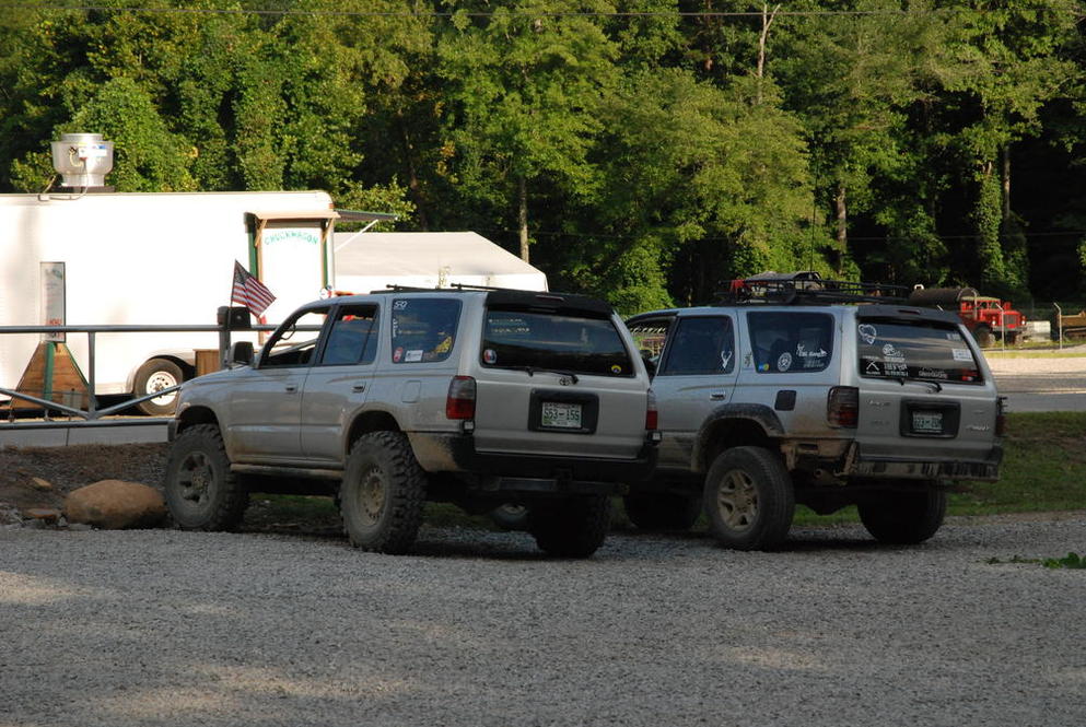

99 front, 906 rear, Bilstein 4600.

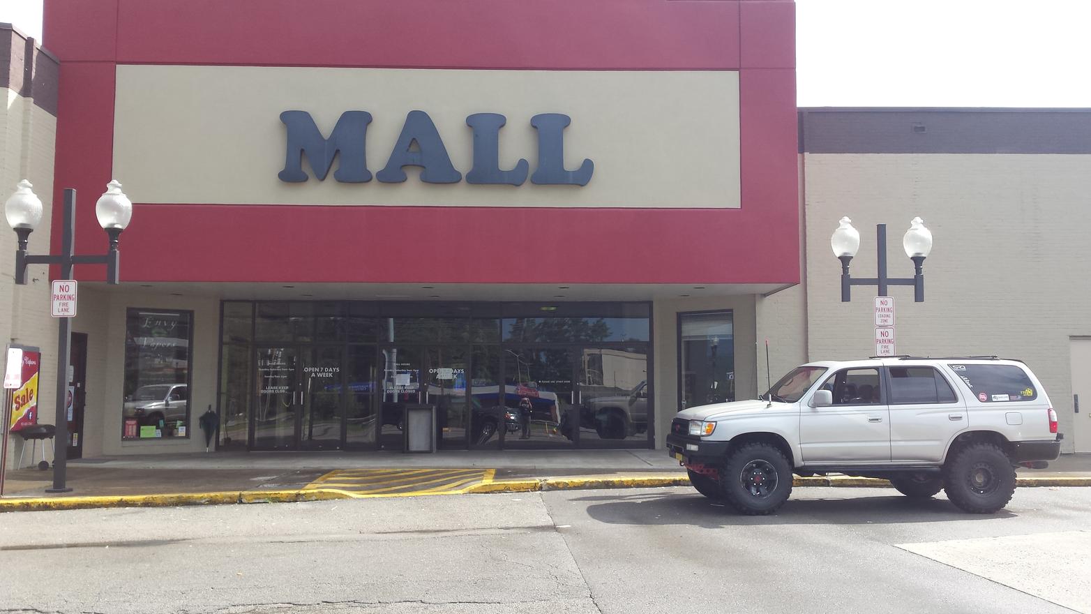

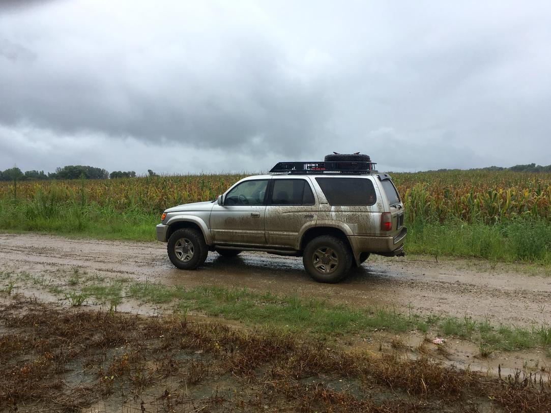

I have 99's up front and OME 890s in the rear. I have 1.5" of rake (if I remember correctly) and I love it

Looks Perfect that is exactly what I am after. I like the 890 setup as well I am just worried that little bit of extra lift in the rear will be undesirable for me. Thus planning on going with the 906's.
Thanks for the responses.
