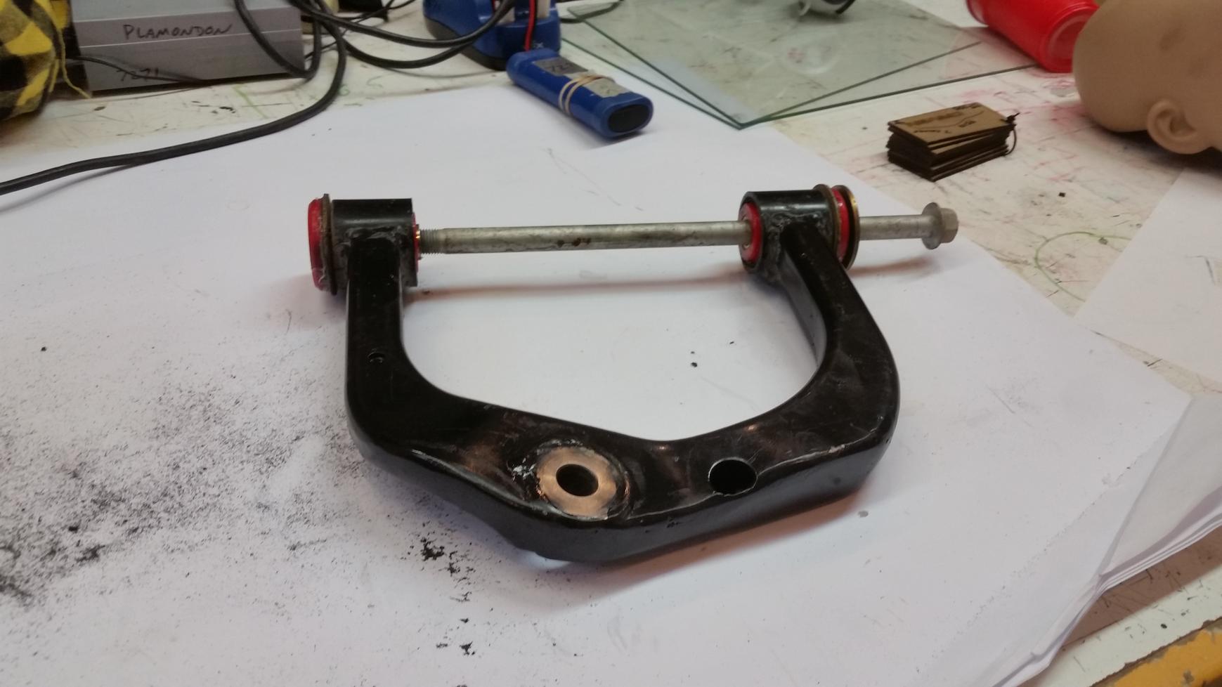

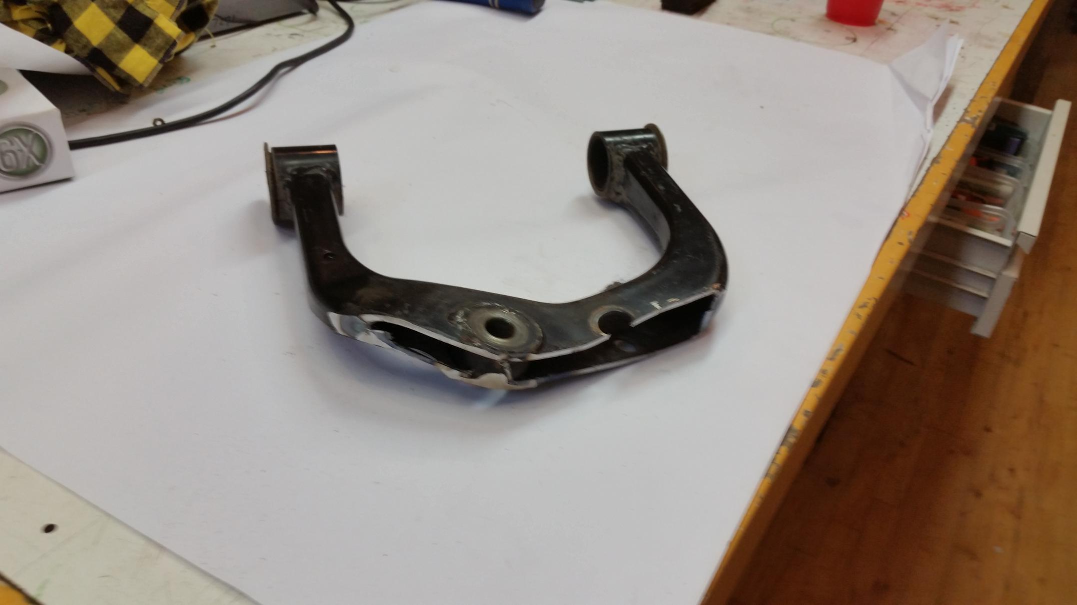

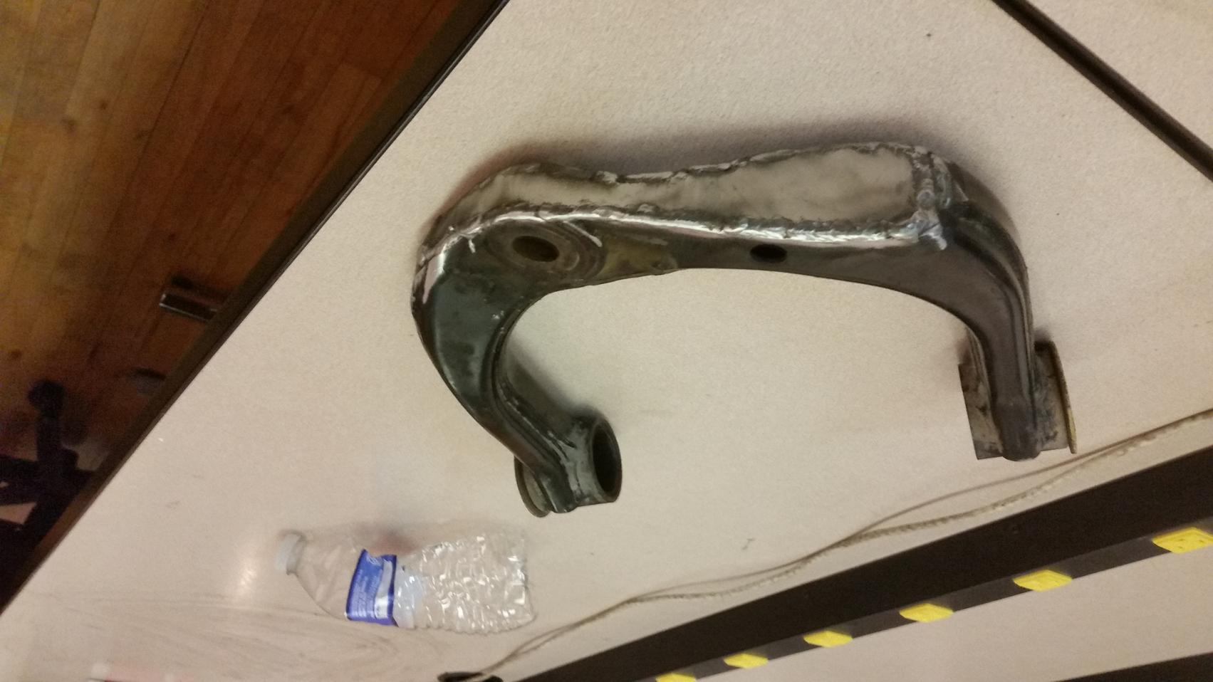

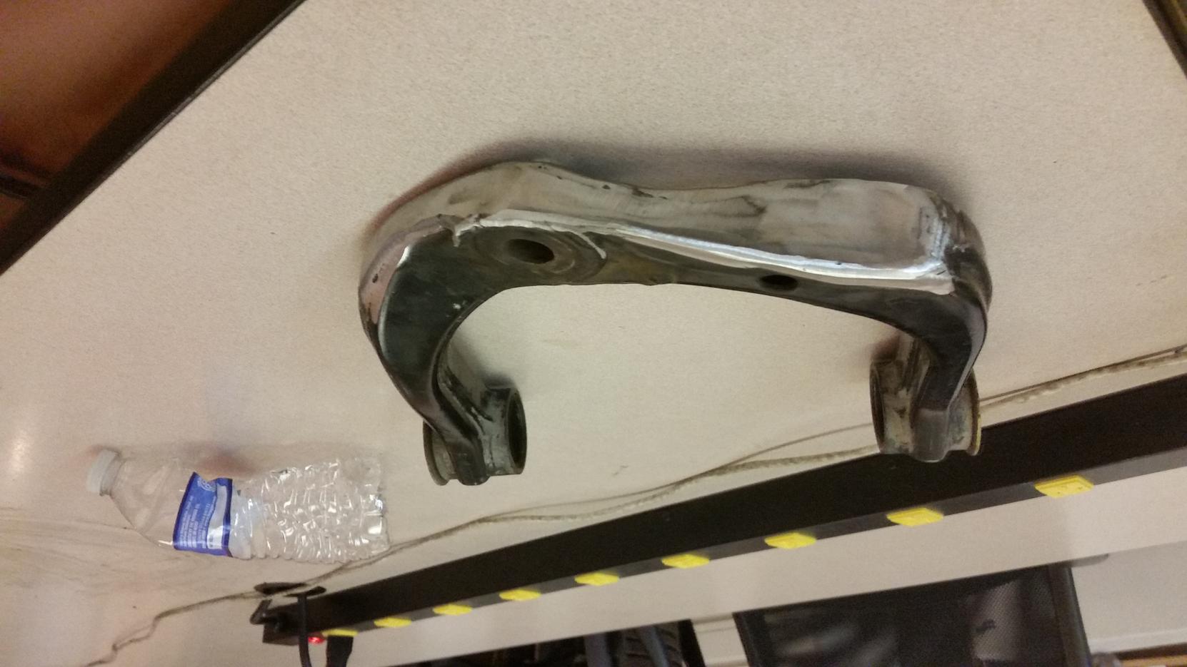

thread revival, I ended up shaving my uca last night, I thought about changing the position of the ball joint mount back, but this is my only vehicle and i didnt want to experiment too much. if I do though ill go and pull some from a junk yard.
anyways I cut all the way to the ball joint mount, and it turned out great. I also welded it all closed. [MENTION=52371]Gerdo[/MENTION] does this make me an expert welder?. I also put in poly bushings.
