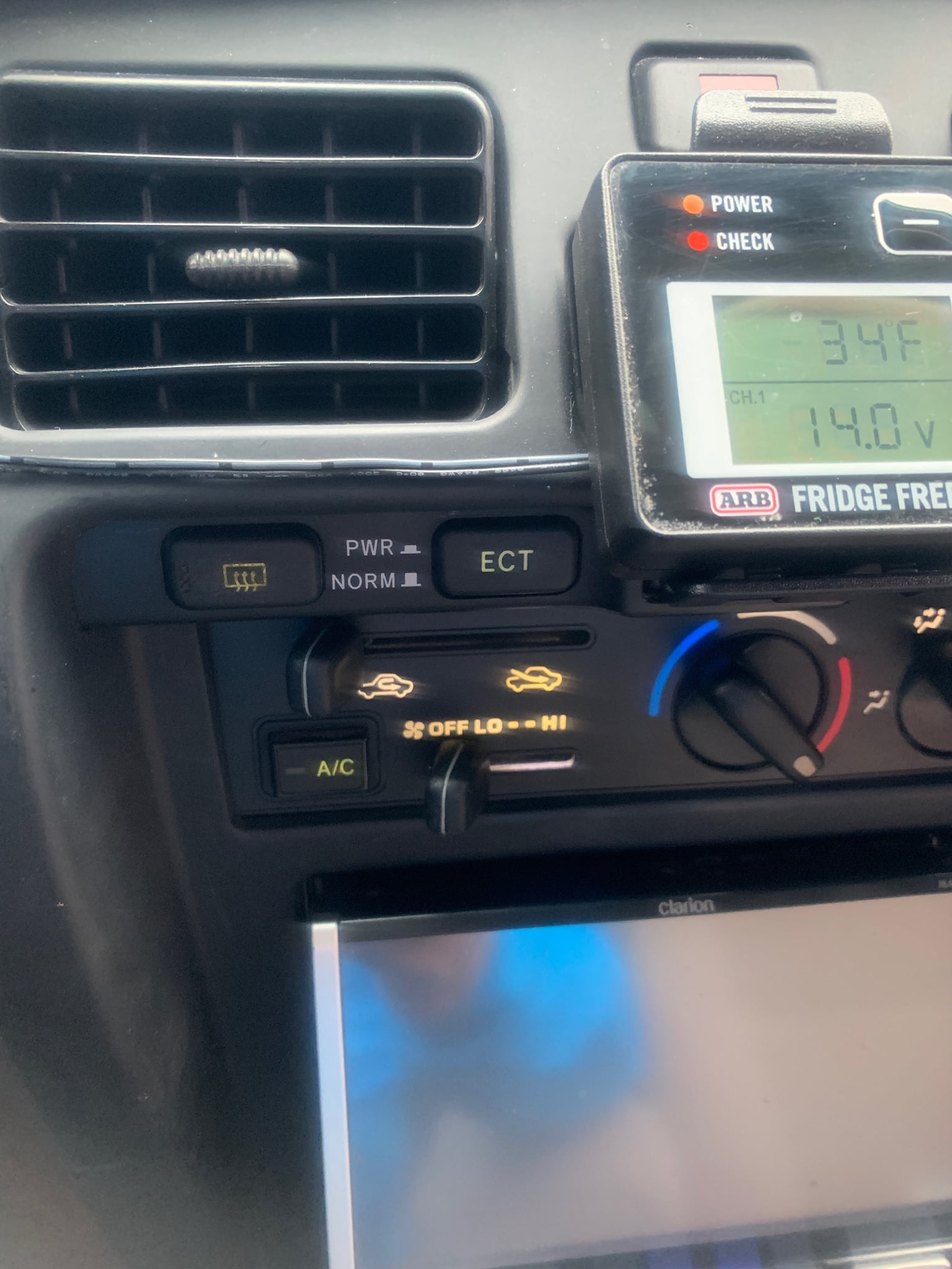

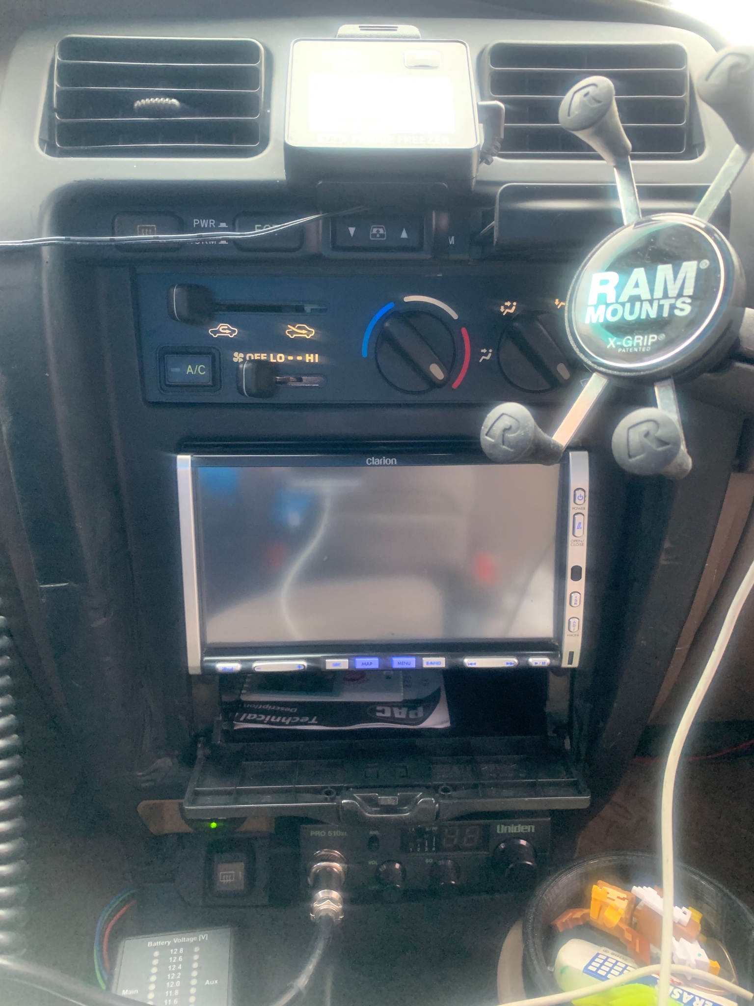

Brah, where were u 4yrs ago. Very great write up. [emoji1433]. I did mines in 2015 and I retrofitted a JDM 3 din to my 99-02 bezel. It’s not perfect at sum spots, but I made it work.

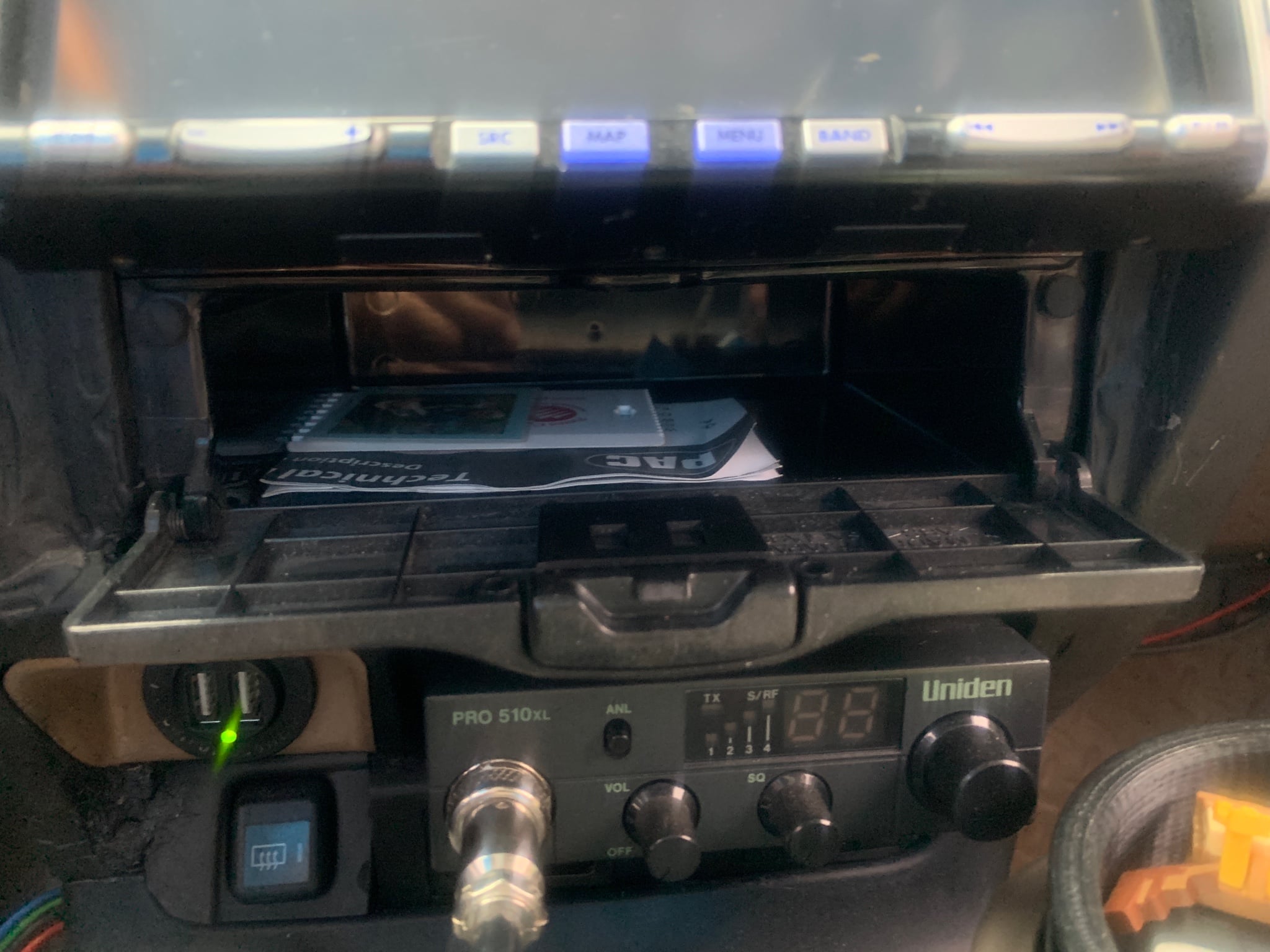

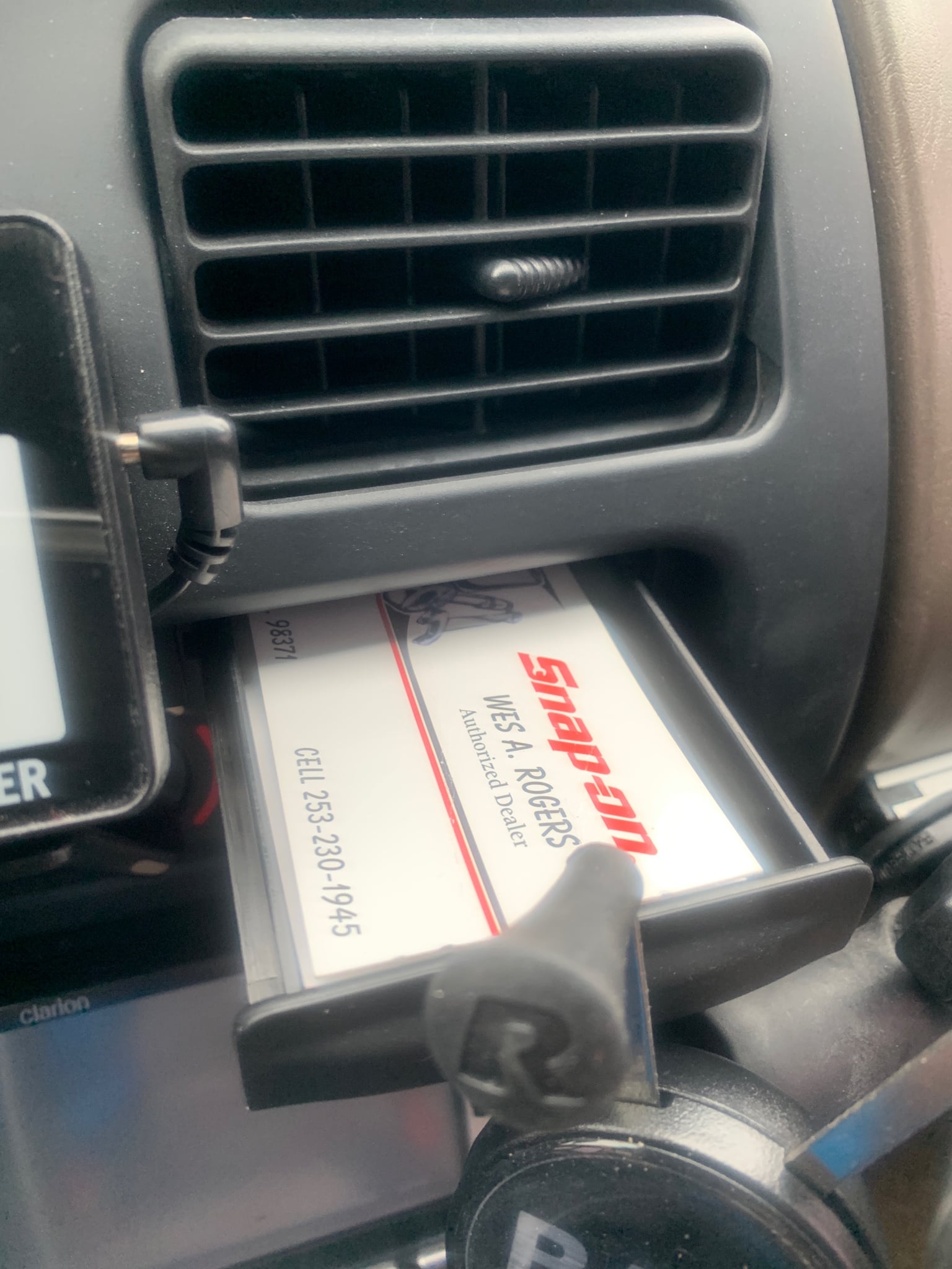

I did a hybrid to the top switchboard (defrost, ECT, and up/down rear window). I installed a secret compartment on the far R of the bar. It holds business cards. Well I think that’s what it’s for.

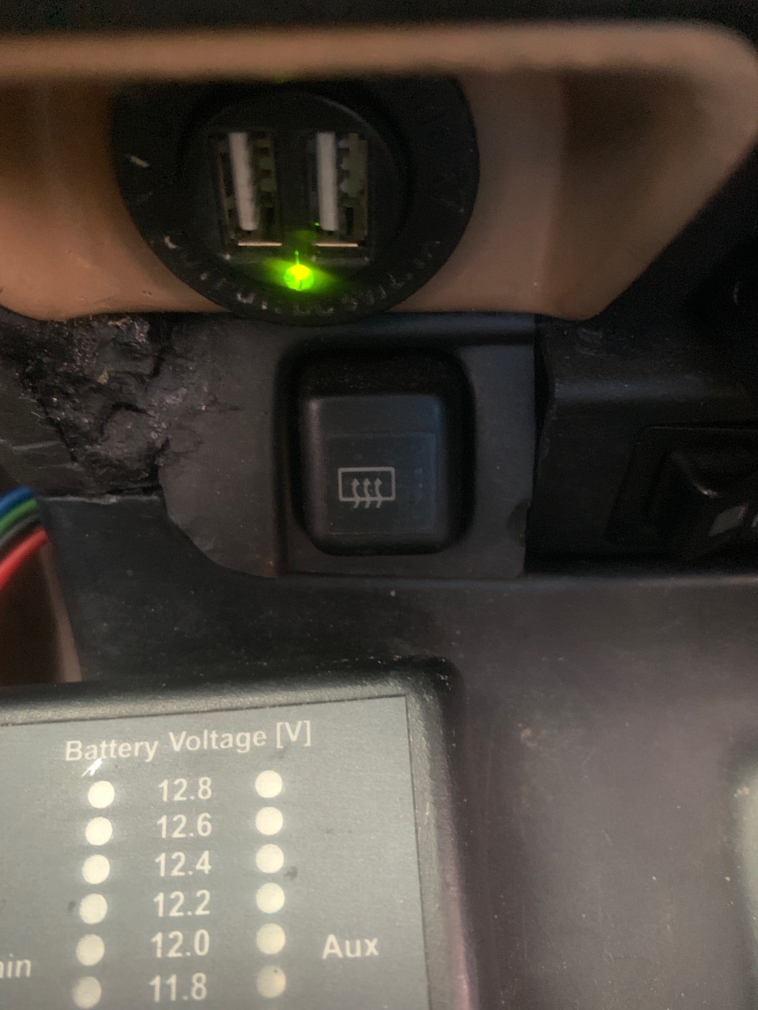

I also didn’t know how to do the defrost switch, so I just molded the switch housing on the bottom L corner
Here’s my other secret compartment. It’s taking the space of 1 din because I have a double din head unit.
