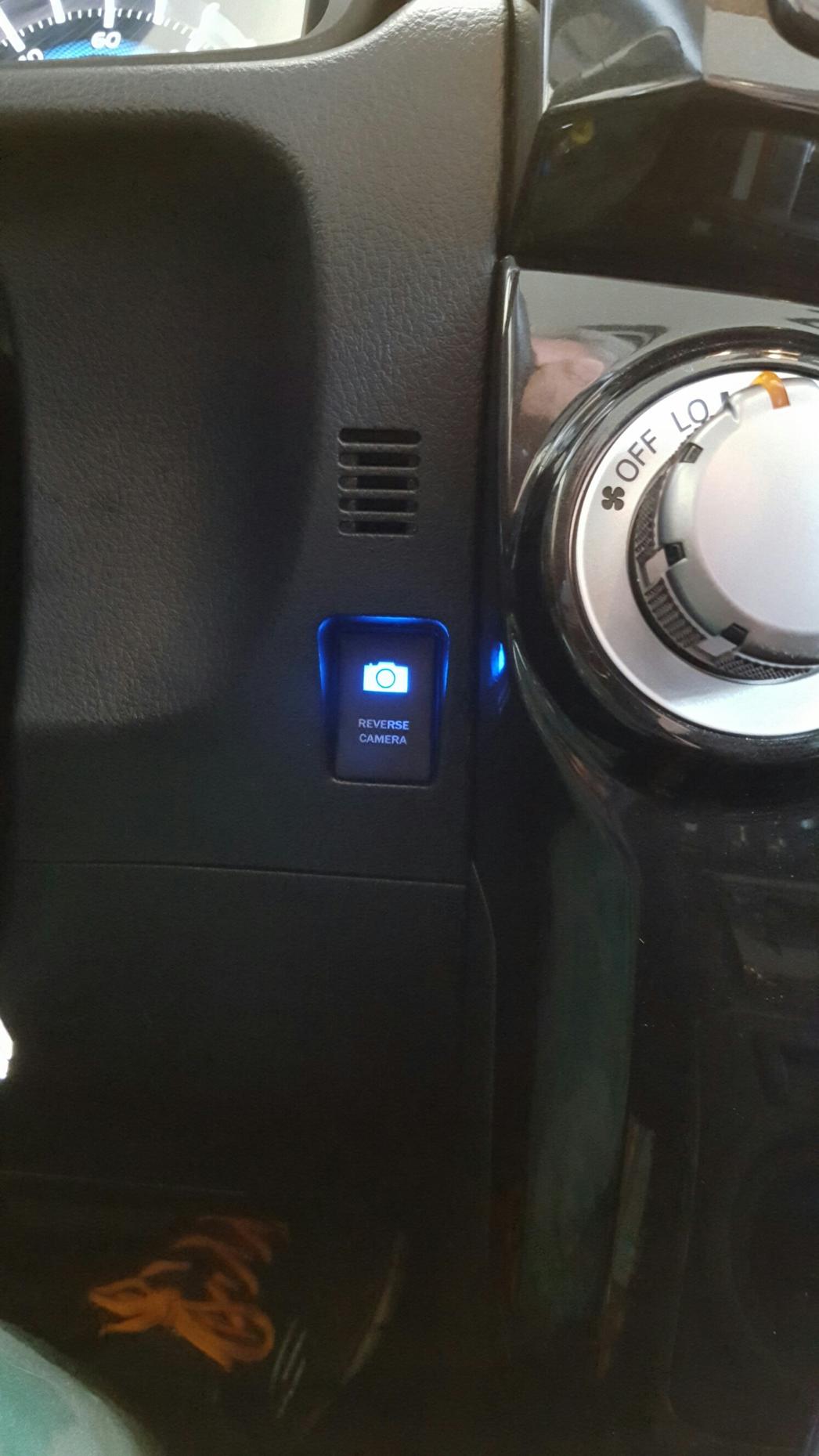

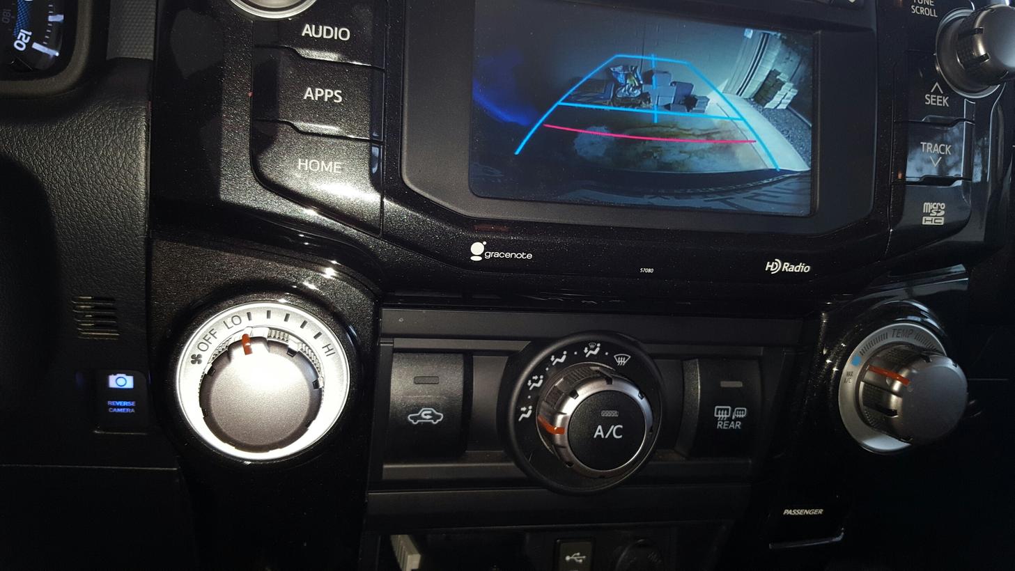

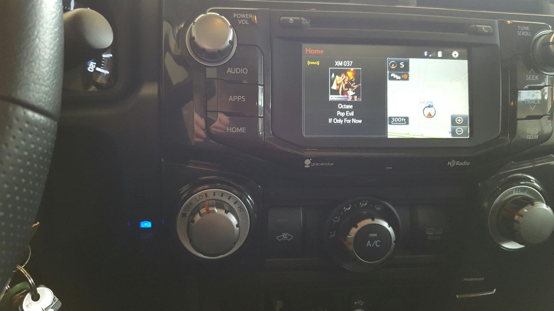

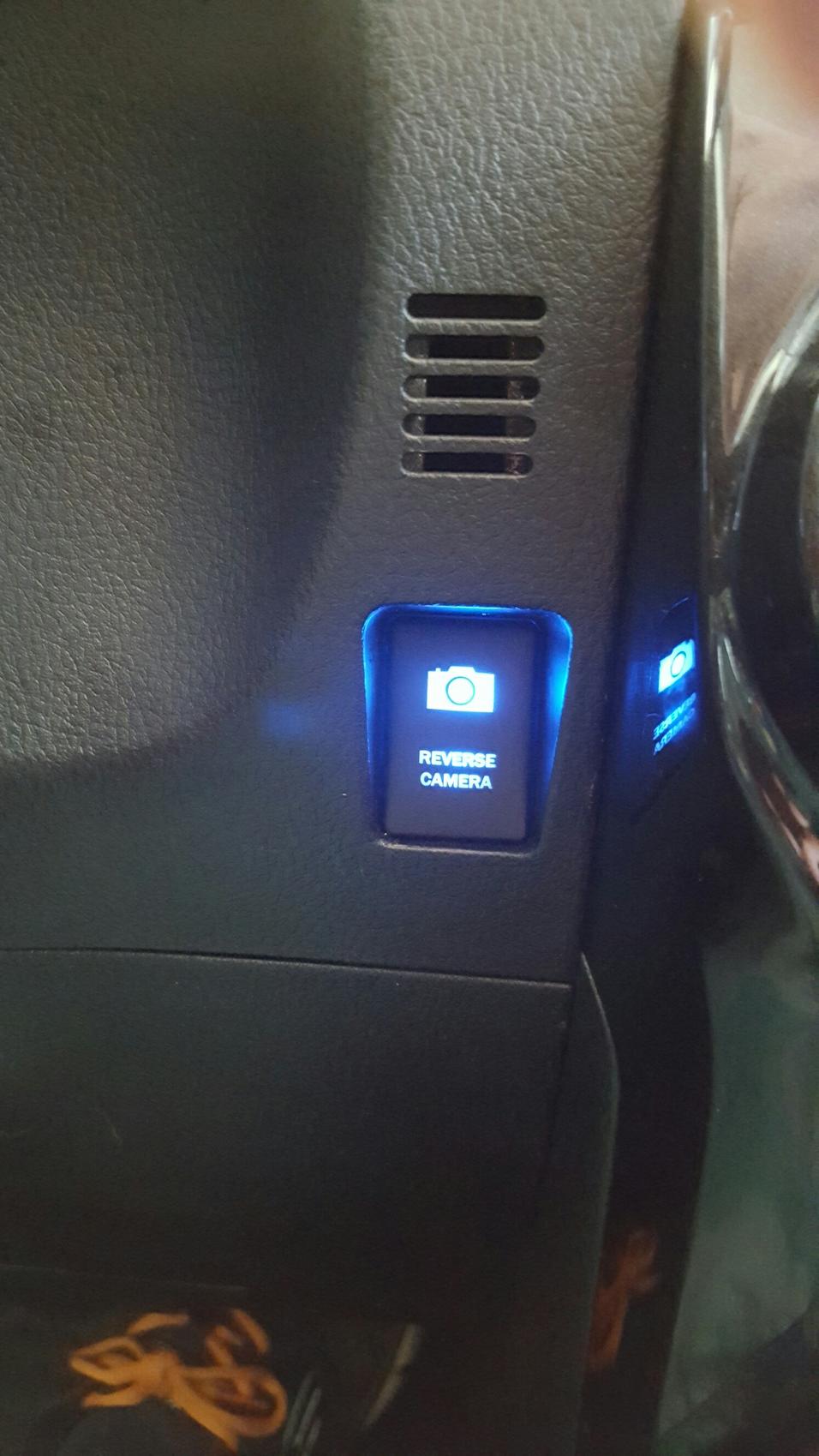

I installed mine today with AOB switch works great. I wired AOB camera switch it had 4 wires RED, Blue to the long Anytime Backup Camera long +12 v wire and AOB Green wire to Anytime Backup Camera wire.
And AOB Black wire to ground. Camera LED light is on when engine is on and when you push in switch to view backup camera bottom Reverse Camera LED on switch comes on.
