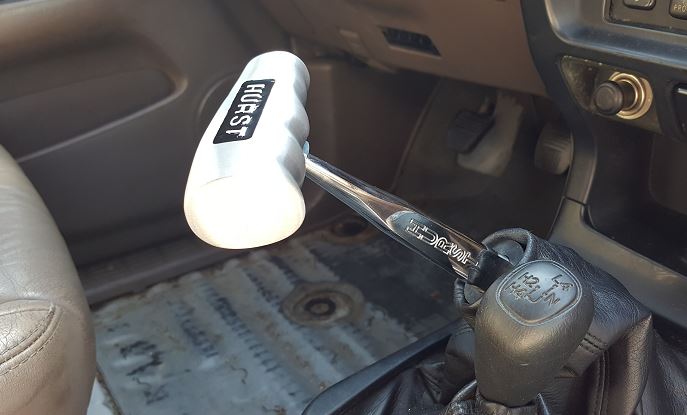

Mine was worn on the top where fingers hit it. I just rolled the top inside around a rubber stopper so worn area is hidden. I have a short throw Hurst, but you could maybe do something like this as an option. The OEM fit is best.
