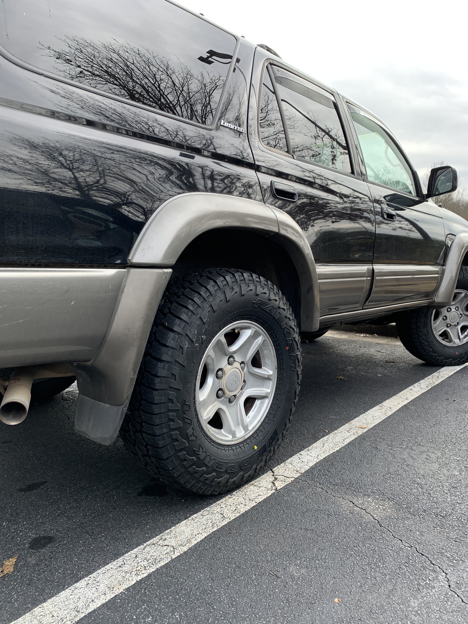

First thing I did was pull the running boards. Next I worked on the worn out suspension. New upper/lower ball joints, tie rods, and some stock struts/springs up front for the time being. After that was 265/75/16 Falken Wildpeak AT3W's.

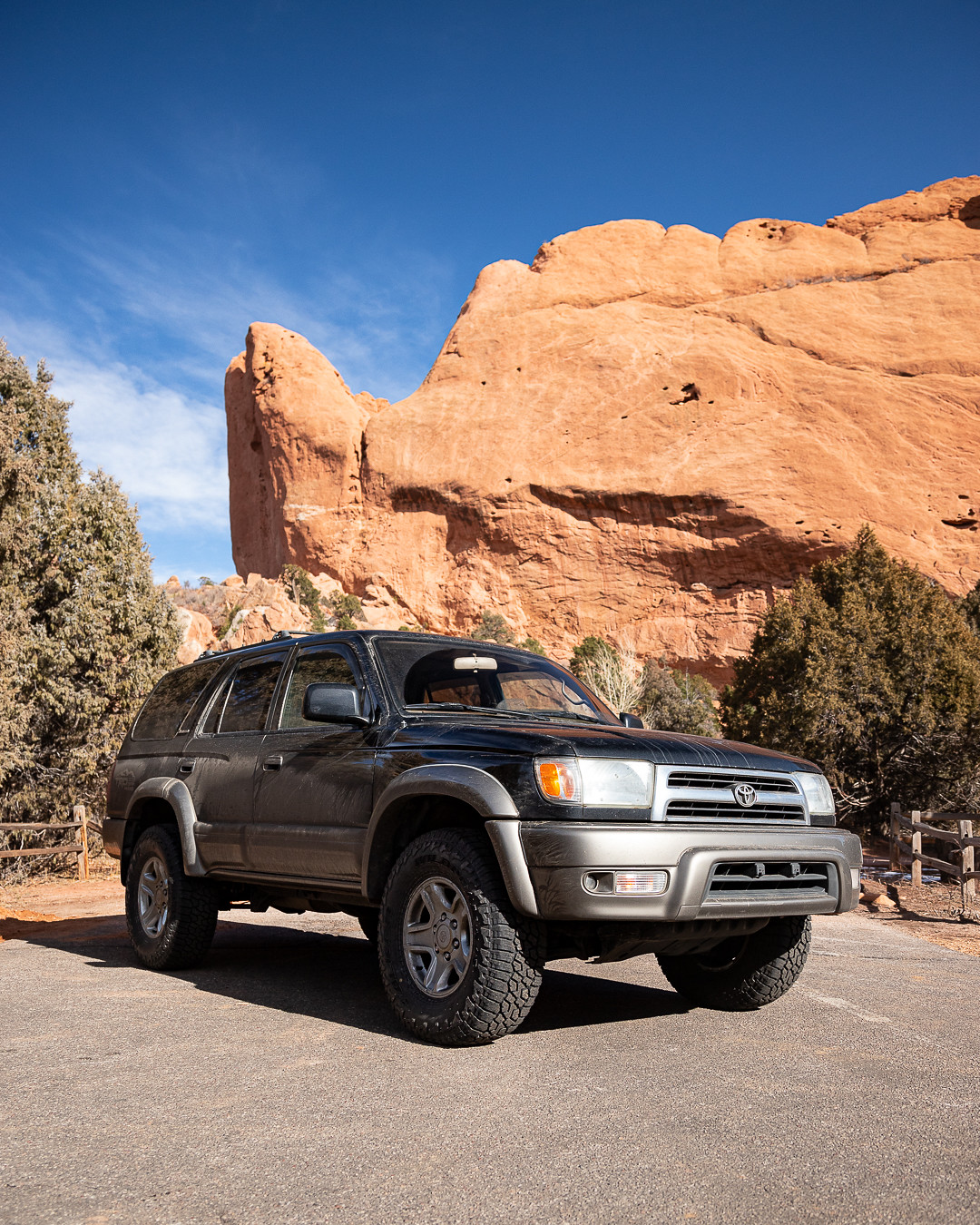

Garden of the Gods park:
_MG_0911 by Alex Perrucci, on Flickr
_MG_0907 by Alex Perrucci, on Flickr

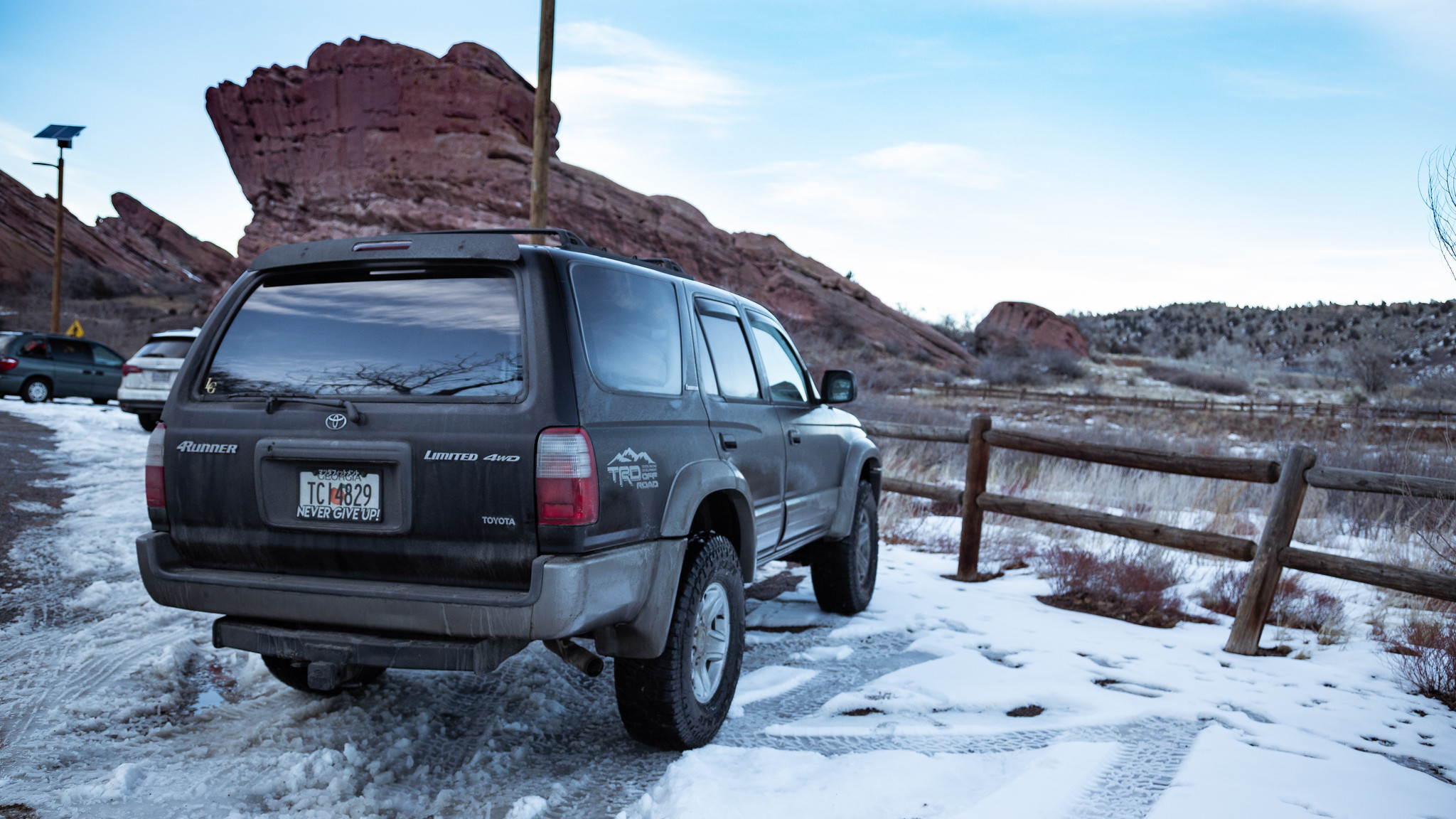

Red Rocks:

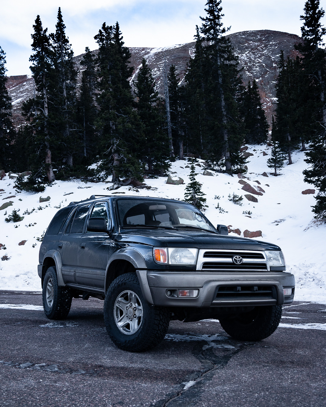

Pikes Peak:

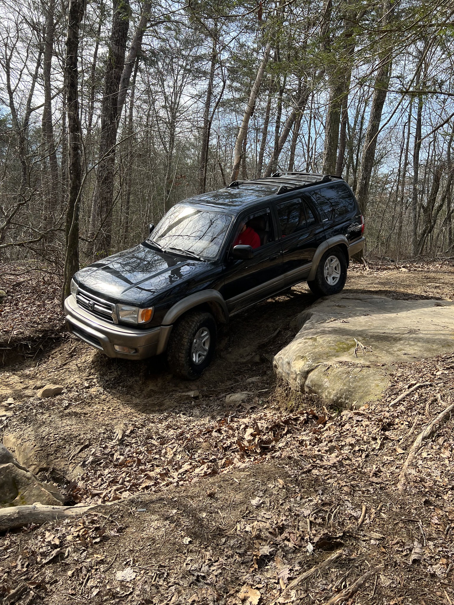

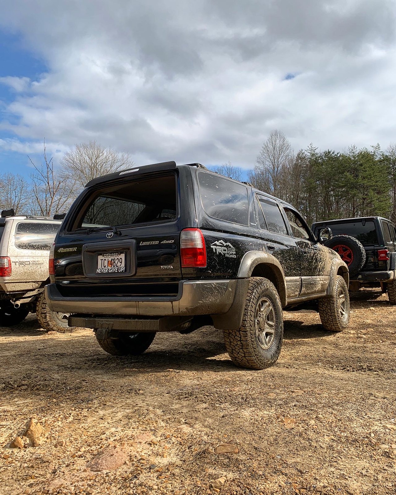

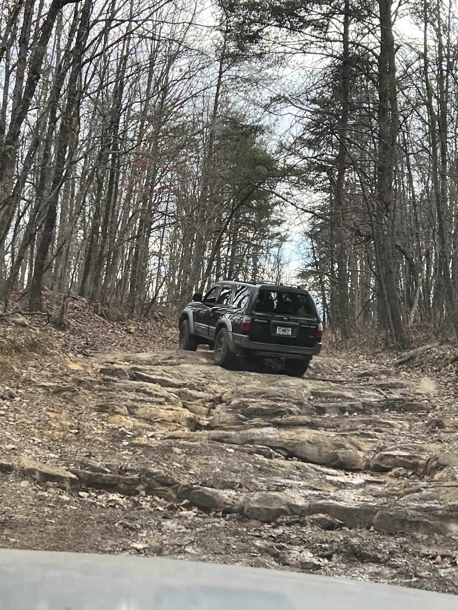

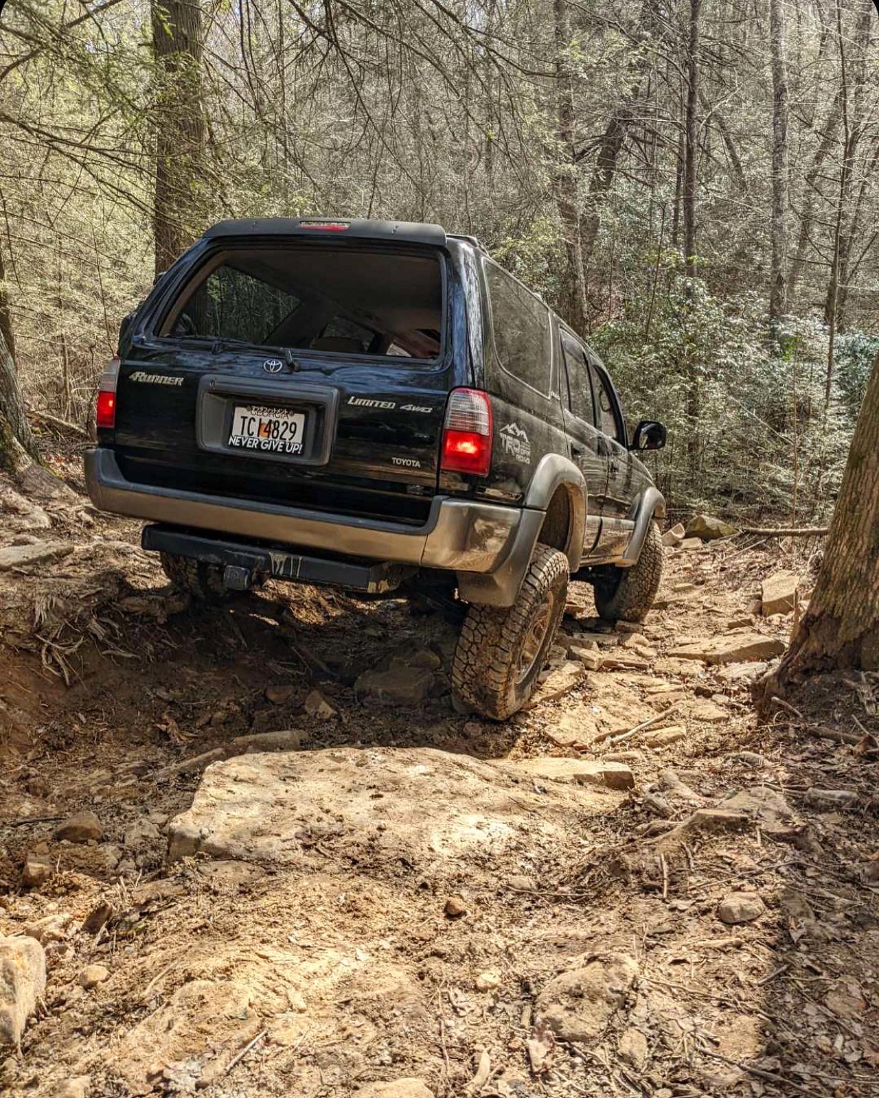

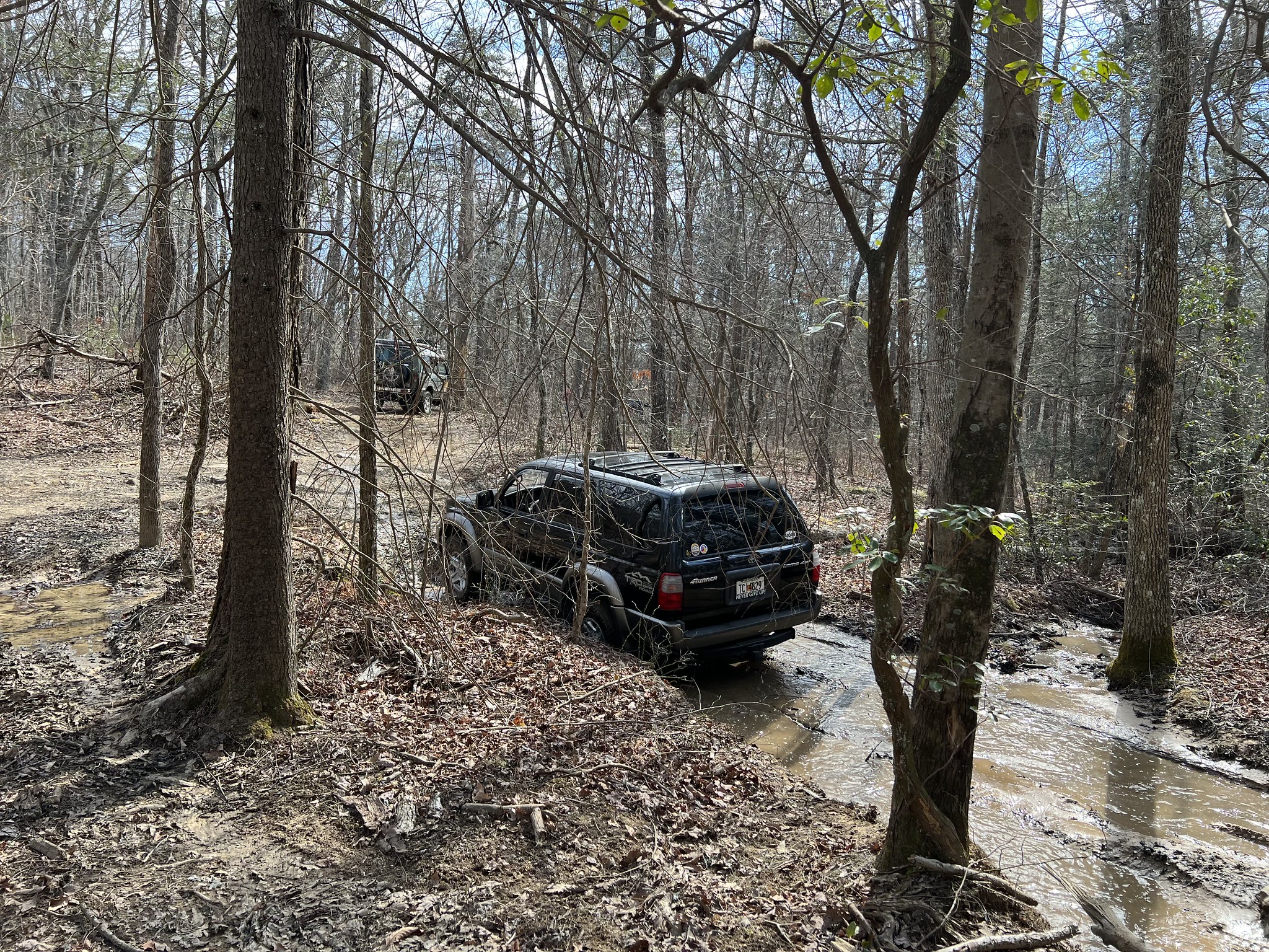

Got back from CO at the beginning of this month and took the 4Runner on my first wheeling trip. All stock besides tires and the truck did great! Wasn't sure how intense of trails we were getting into but I was definitely impressed at some of the terrain it was able to handle as is. Looking to do a lift and probably front bumper in the near future now.

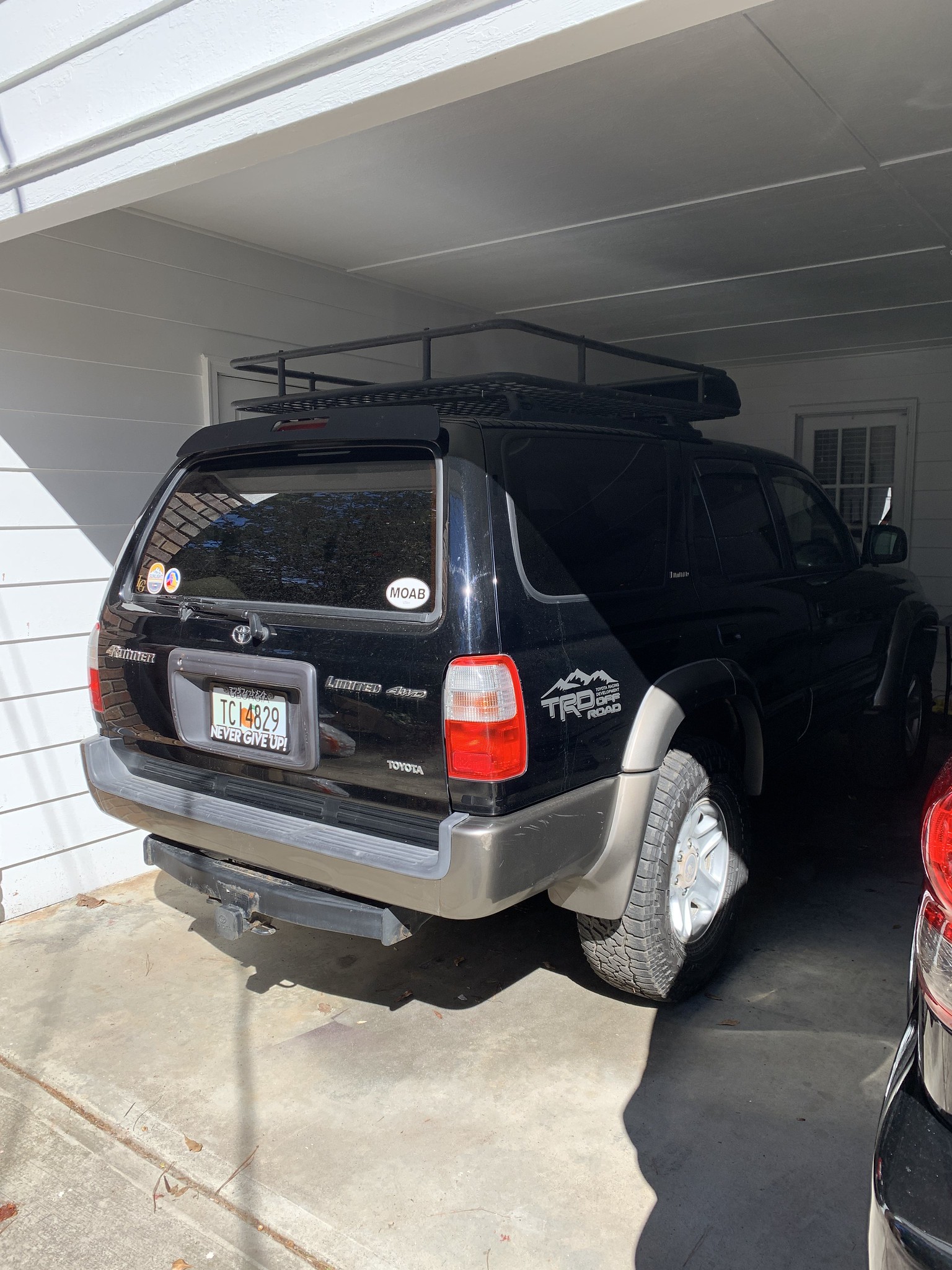

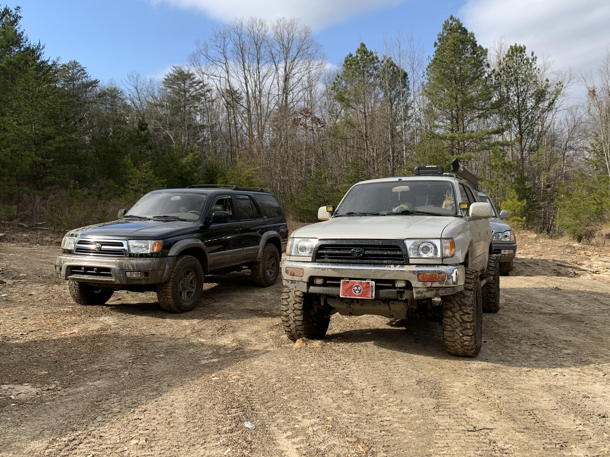

Most recently just added this roof basket from my buddies truck as he plans on building himself a roof rack.

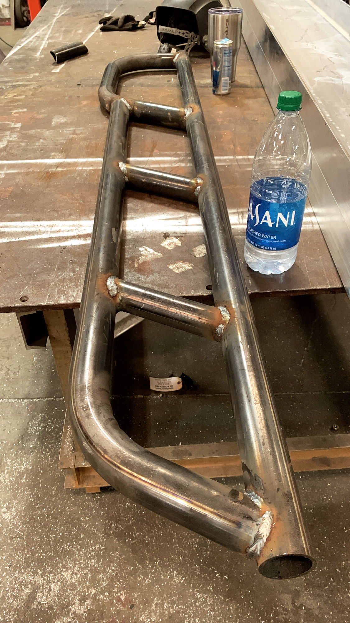

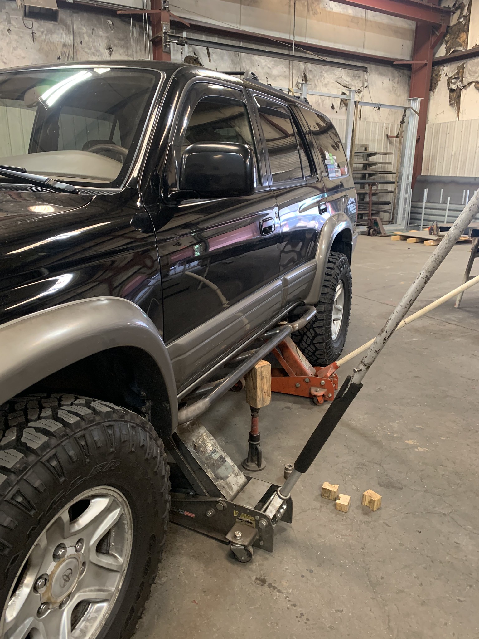

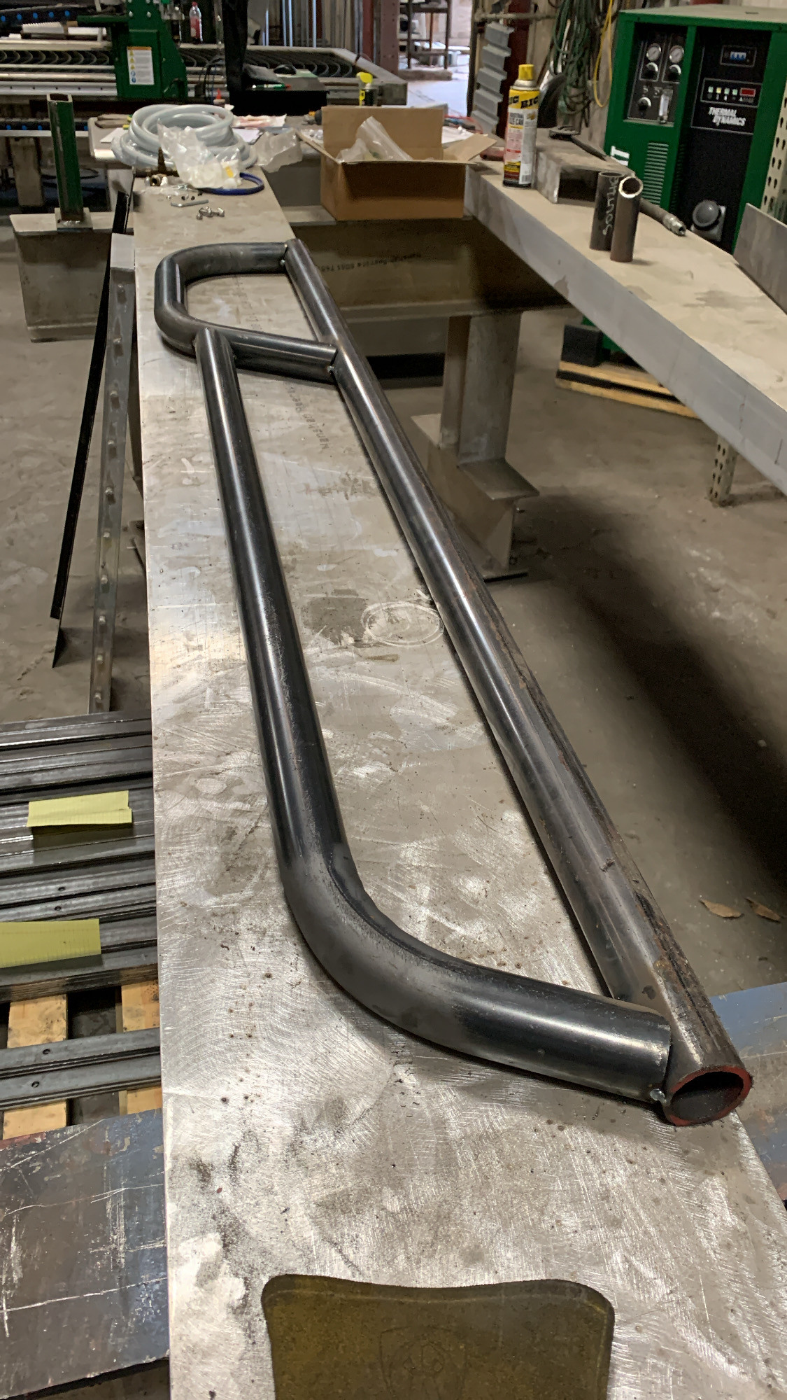

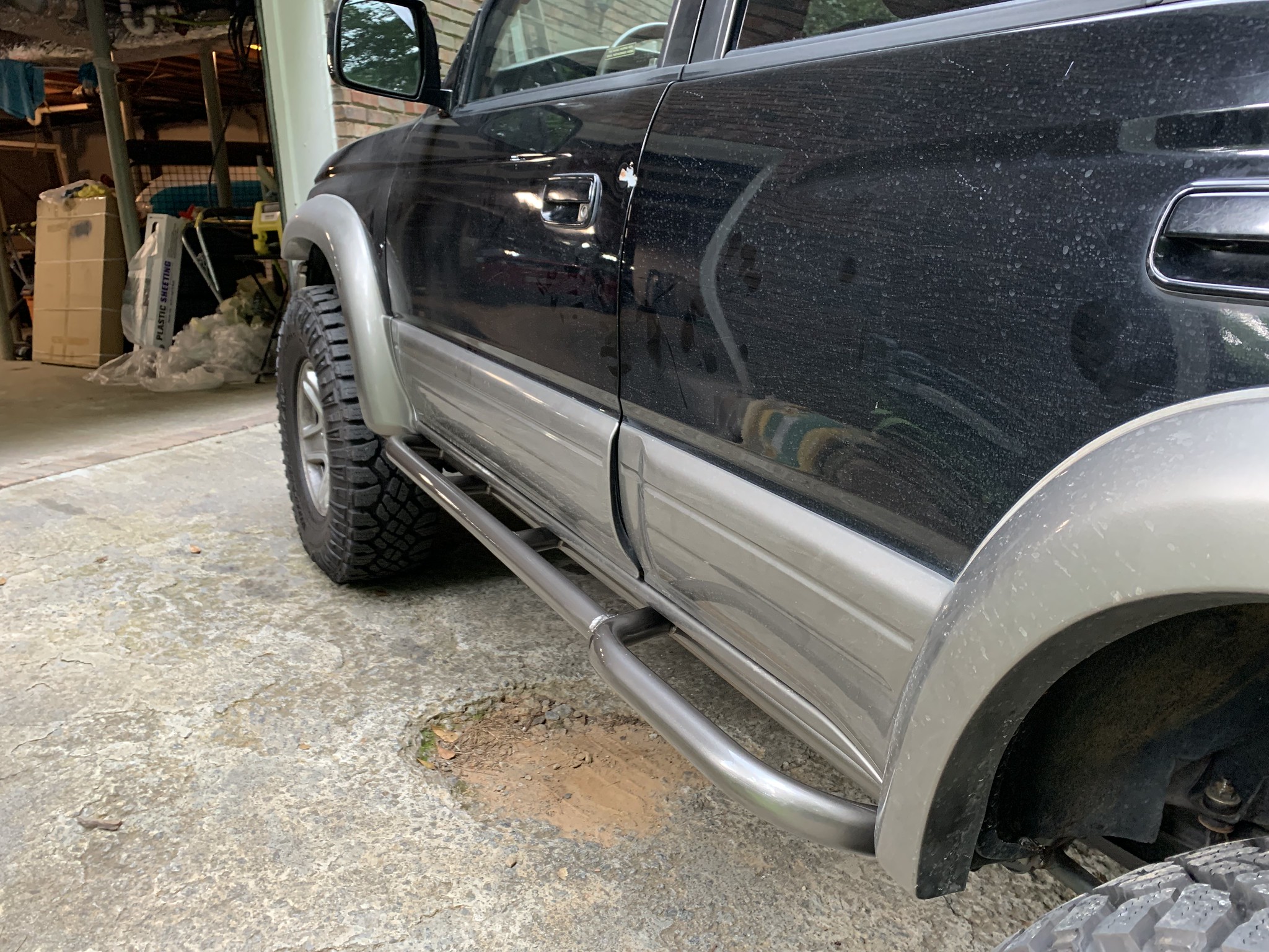

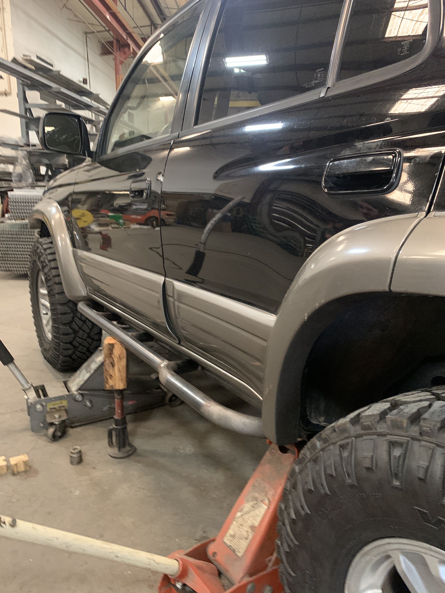

Started building some rock sliders for the truck today with the help of a friend. Got them mostly assembled and tacked together. Just need to add a couple of supports between the two bars and add legs/mockup fitment. Plan on painting them to match the cladding and then welding them to the frame.

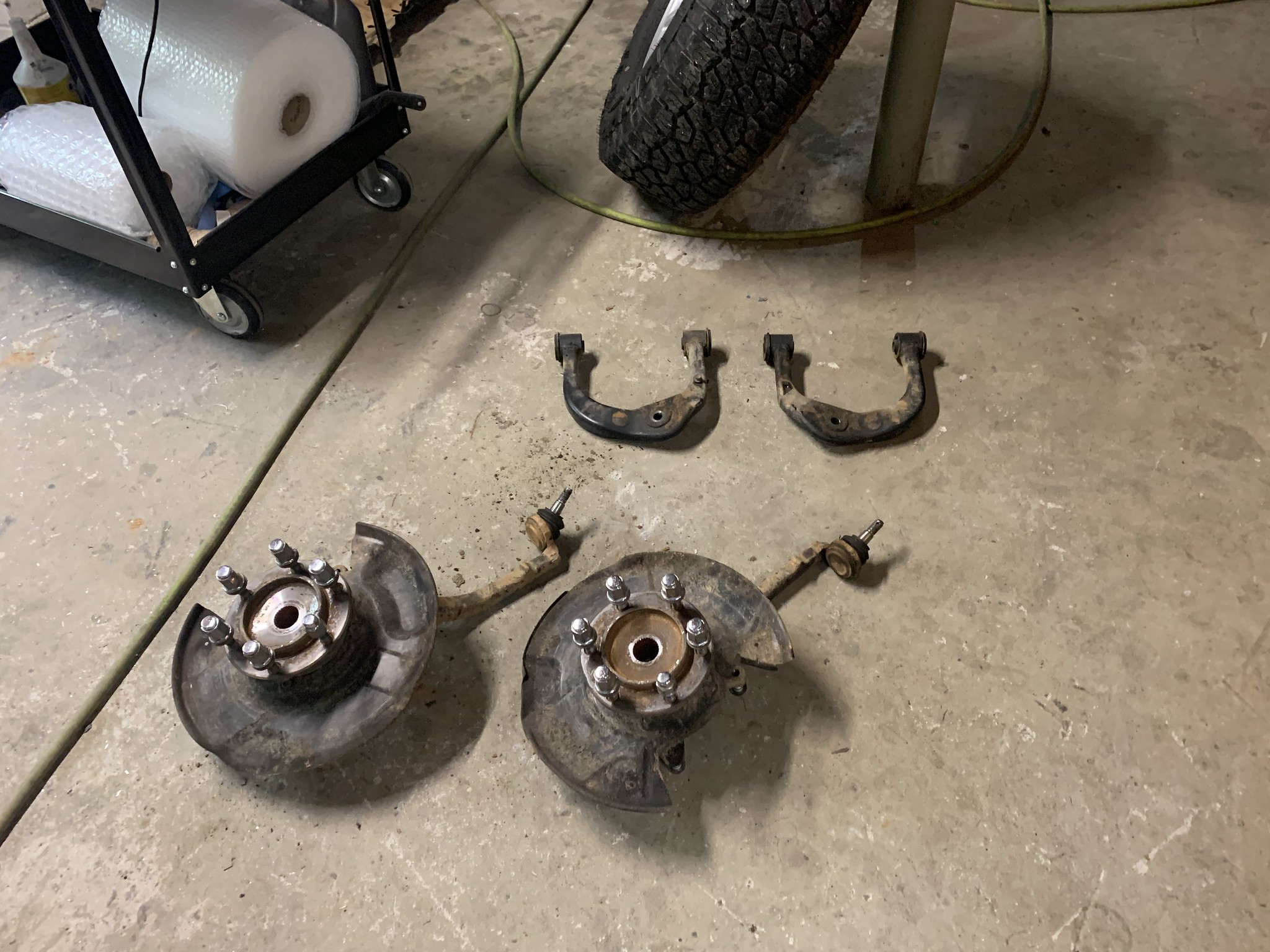

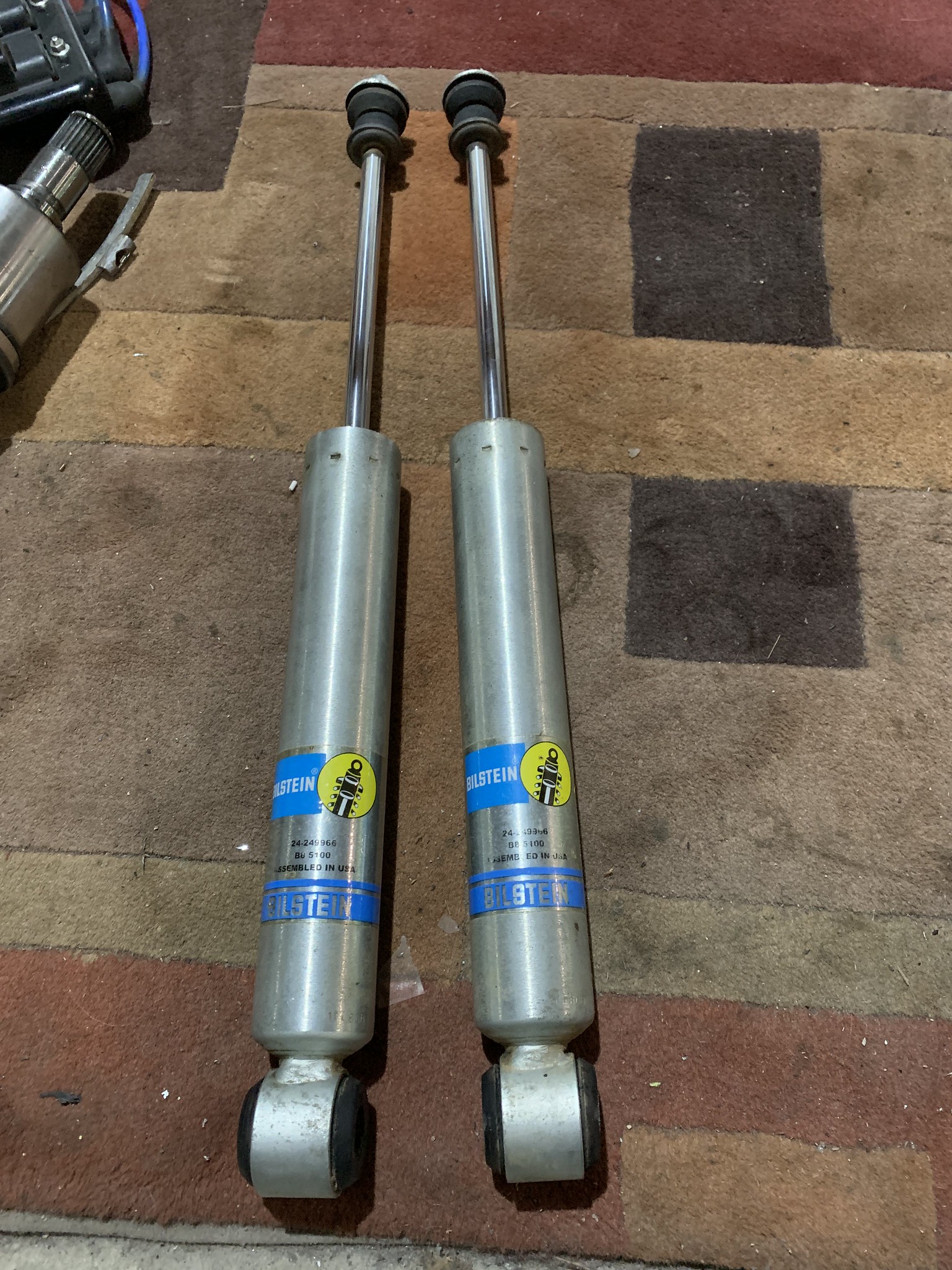

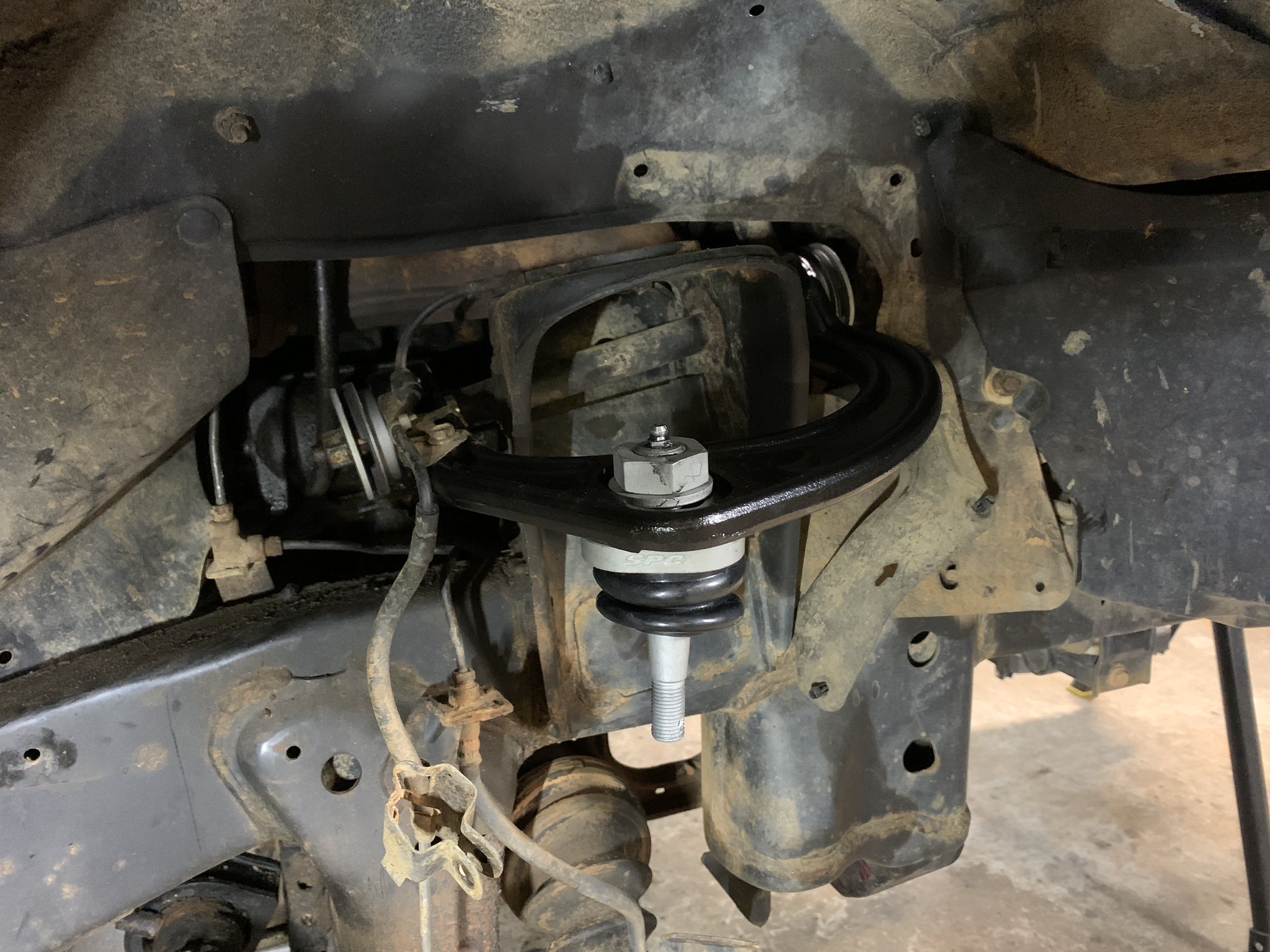

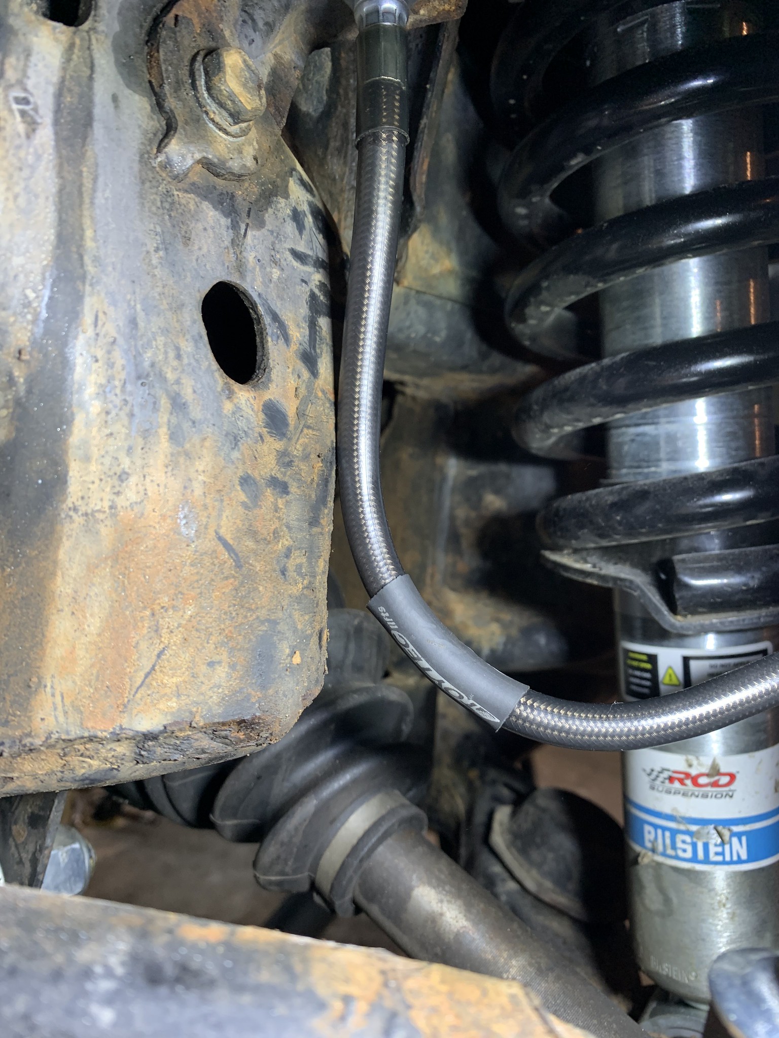

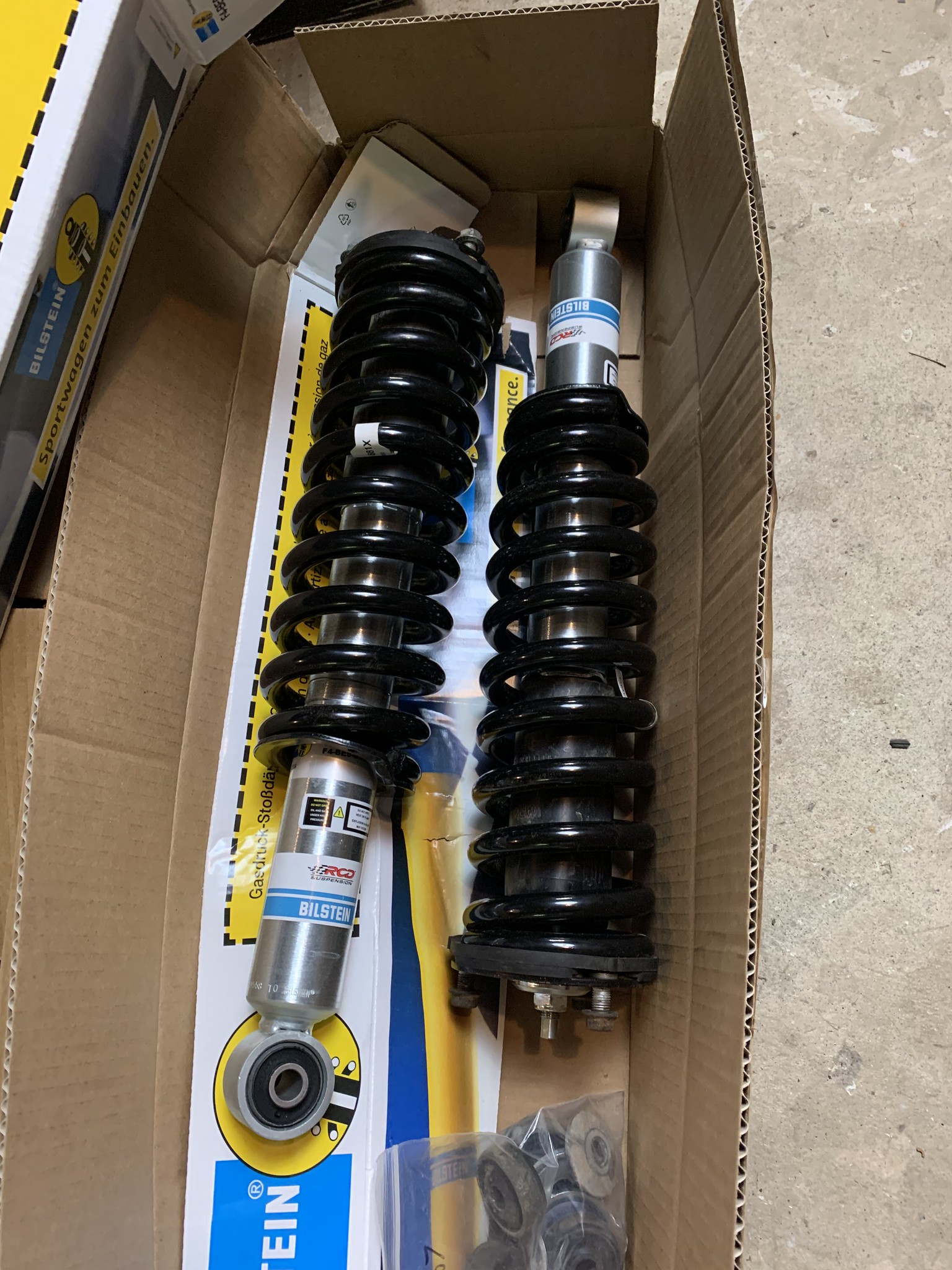

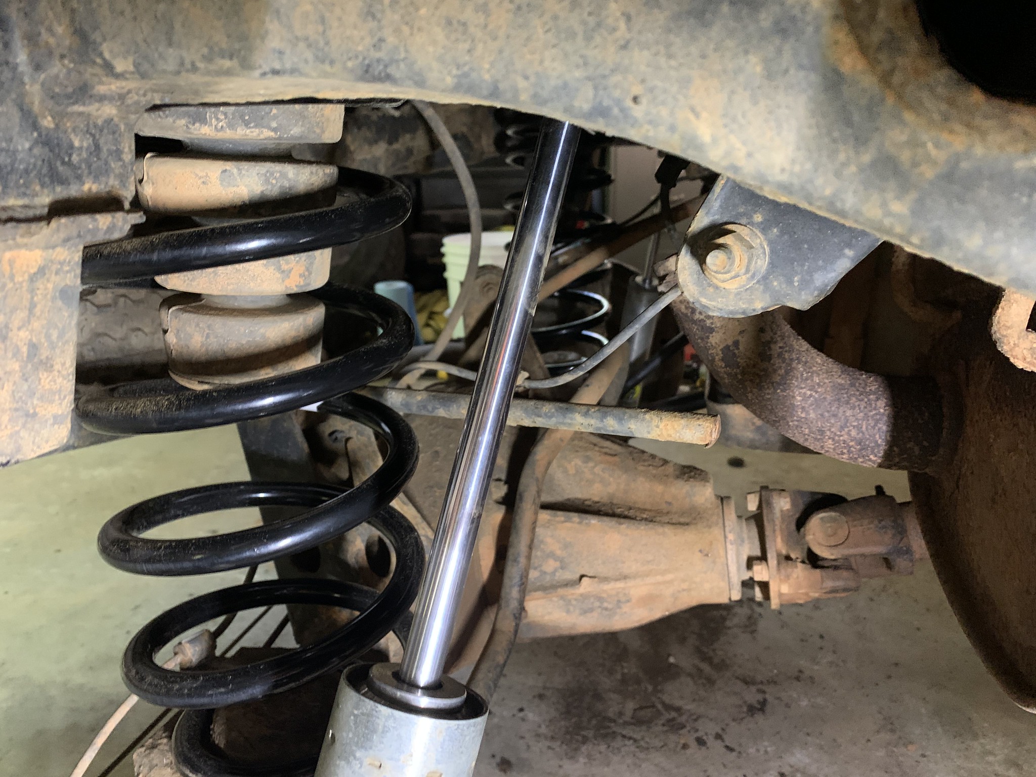

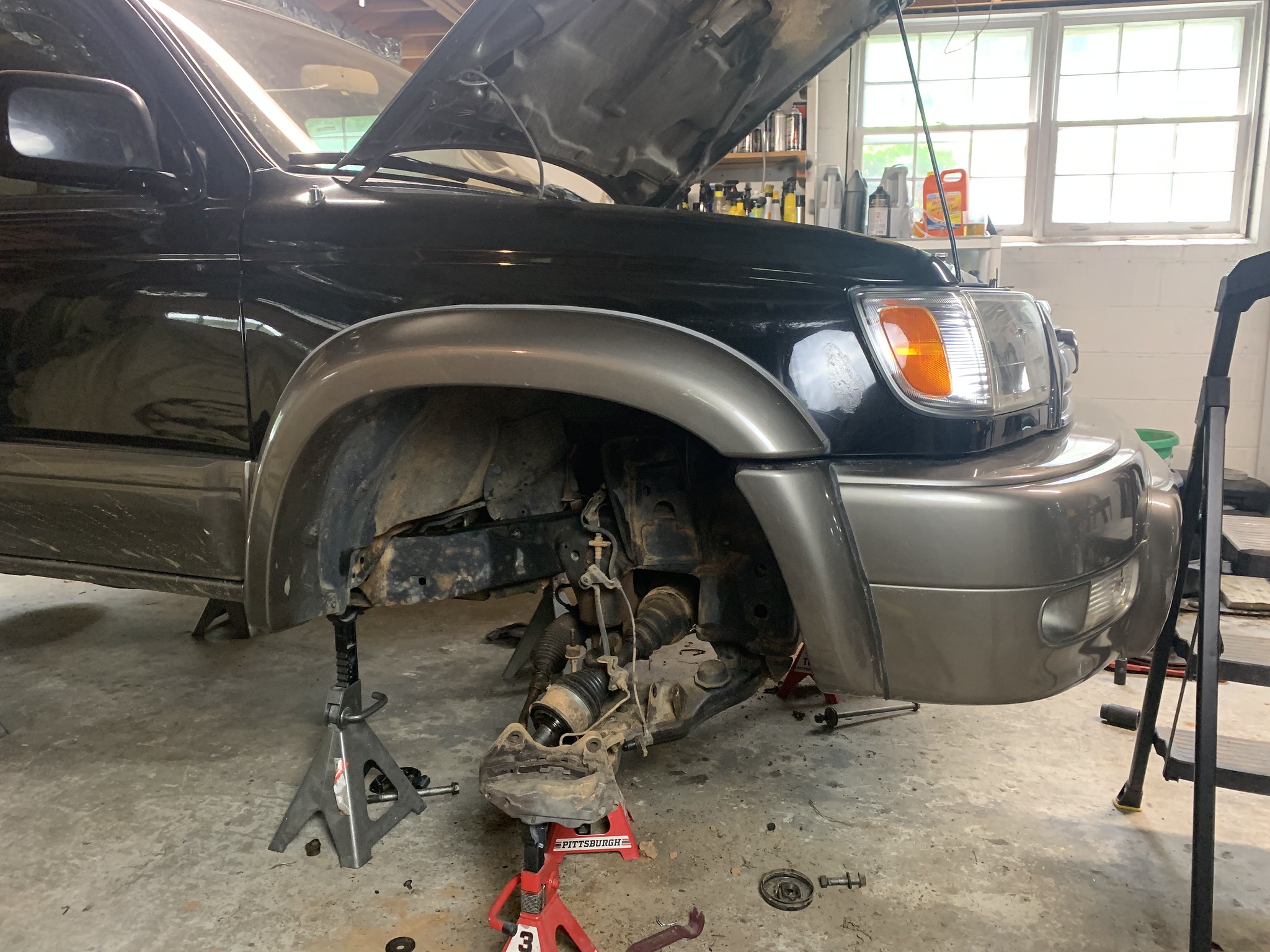

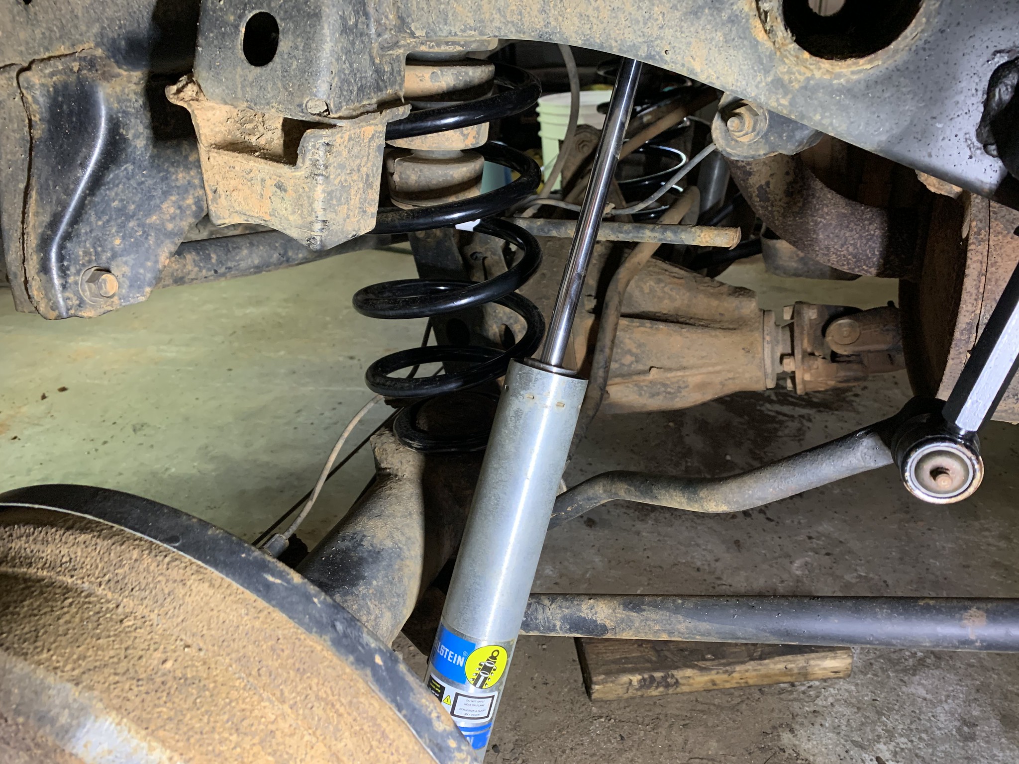

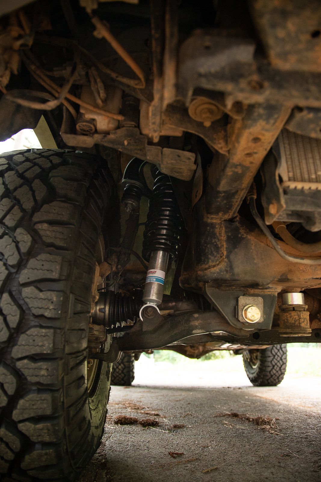

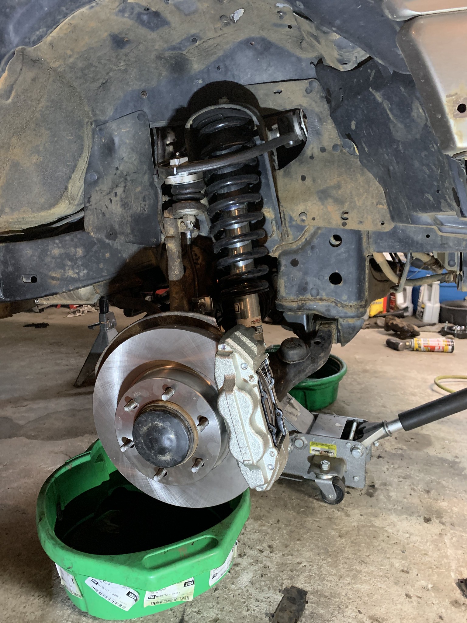

Tore the suspension apart for a much needed overhaul.
Currently installing:
Bilstein 5100's/OME 881, 890
SPC Upper Control Arms

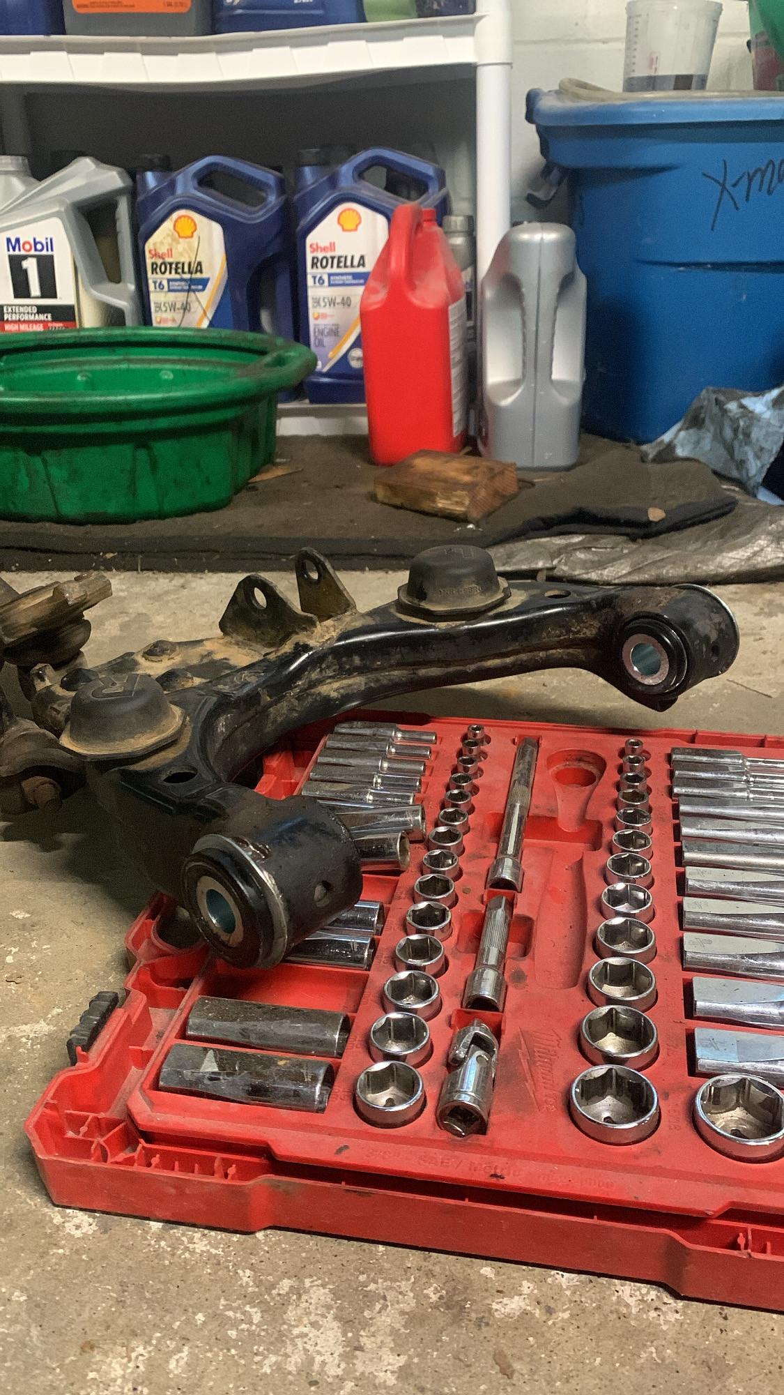

Whiteline Front LCA bushings
Toytec Diff Drop
333 Fab Cam Eliminator Plates
OEM Toyota rear upper control arms

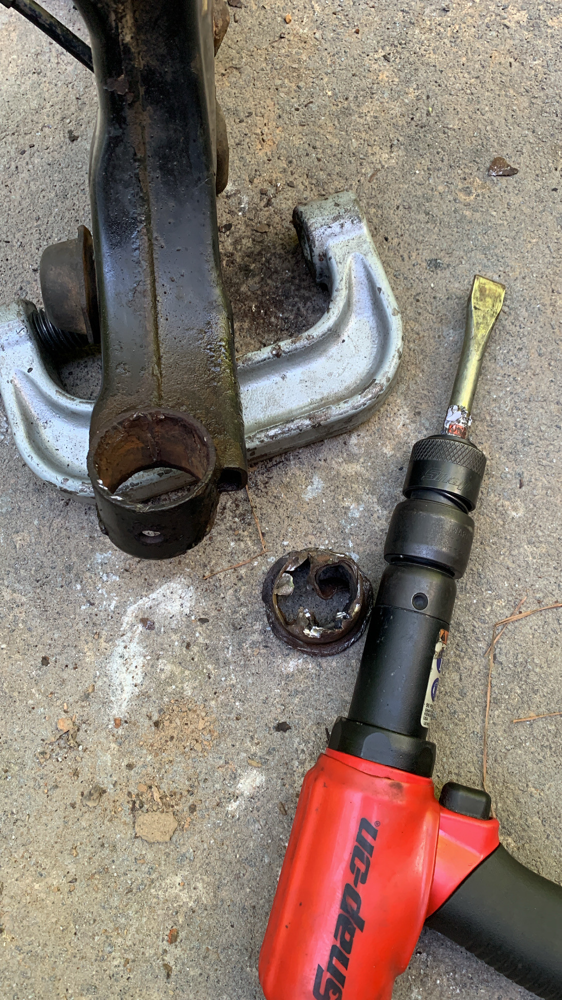

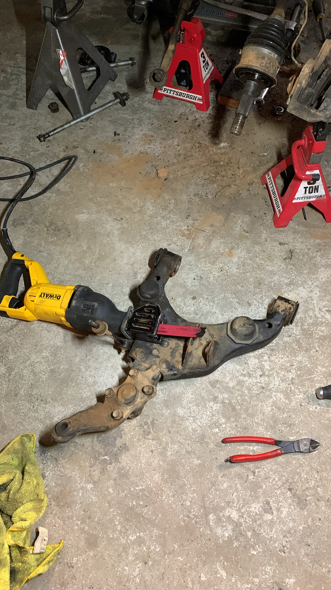

Currently the new rear suspension is in besides the new upper arms. As you can see in the photo one of them snapped when I dropped the axle down to install the rear springs lol. Decided to go with the 333 fab cam eliminators while I was in there messing the front LCA's. Glad I did too as the passenger side cam adjusters were seized to the bushings and I had to cut that arm out. The old bushings were pretty rusted in place as well. Ended up heating them up, pushing the rubber out and had to cut the sleeves out with the air chisel as the 20 ton press wouldn't budge them. New Whiteline bushings are in just waiting on the cam eliminators to show up and I can wrap the front back up. Excited to see how it drives after all this, should be much better!
Any suggestions for an initial camber setting on the SPC uppers for the drive to the alignment shop? Just set it in the middle? Also how are most people running their lower cam eliminators? Seeing some say outboard rear, inboard front, and also outboard rear, front center.

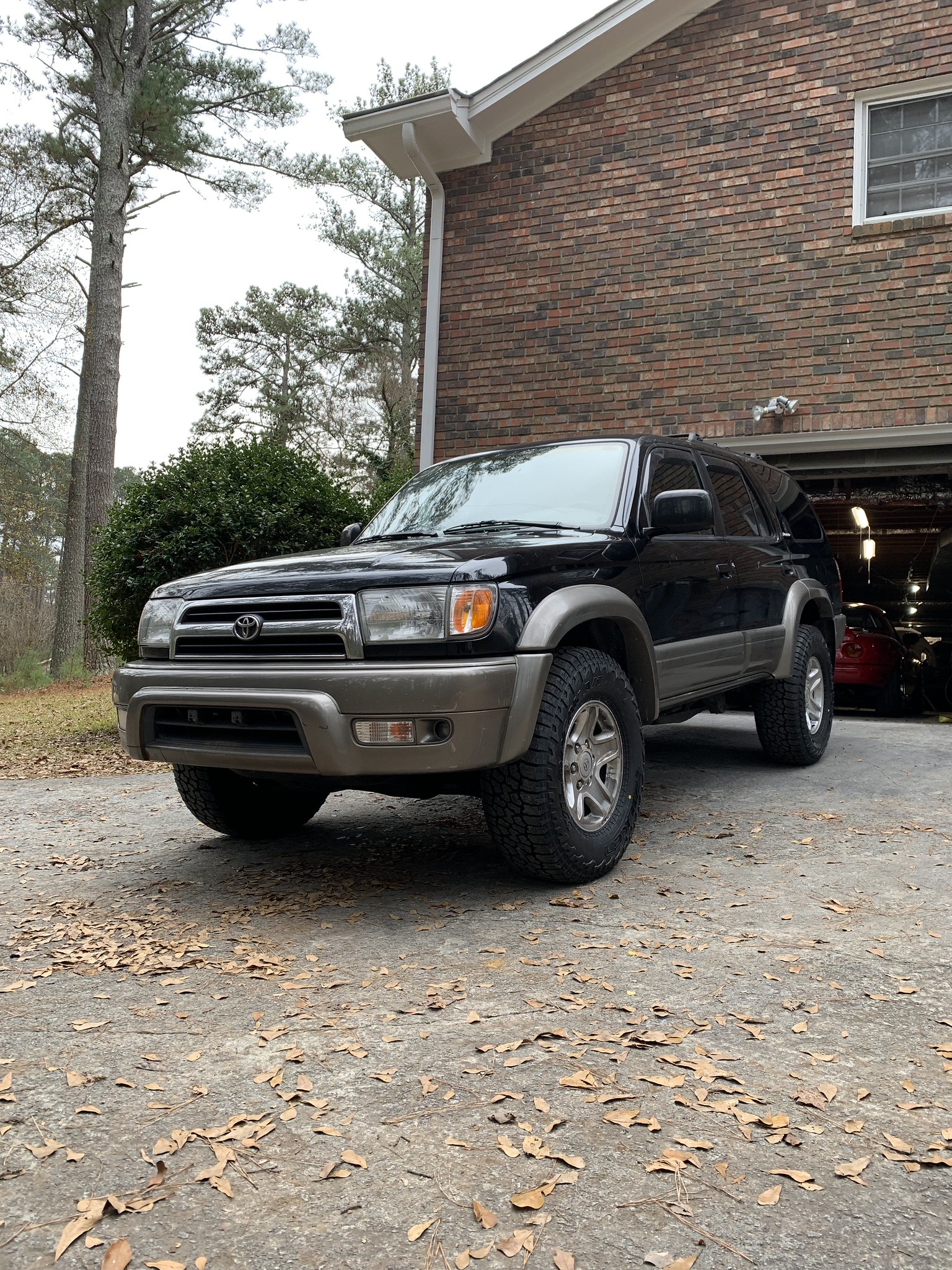

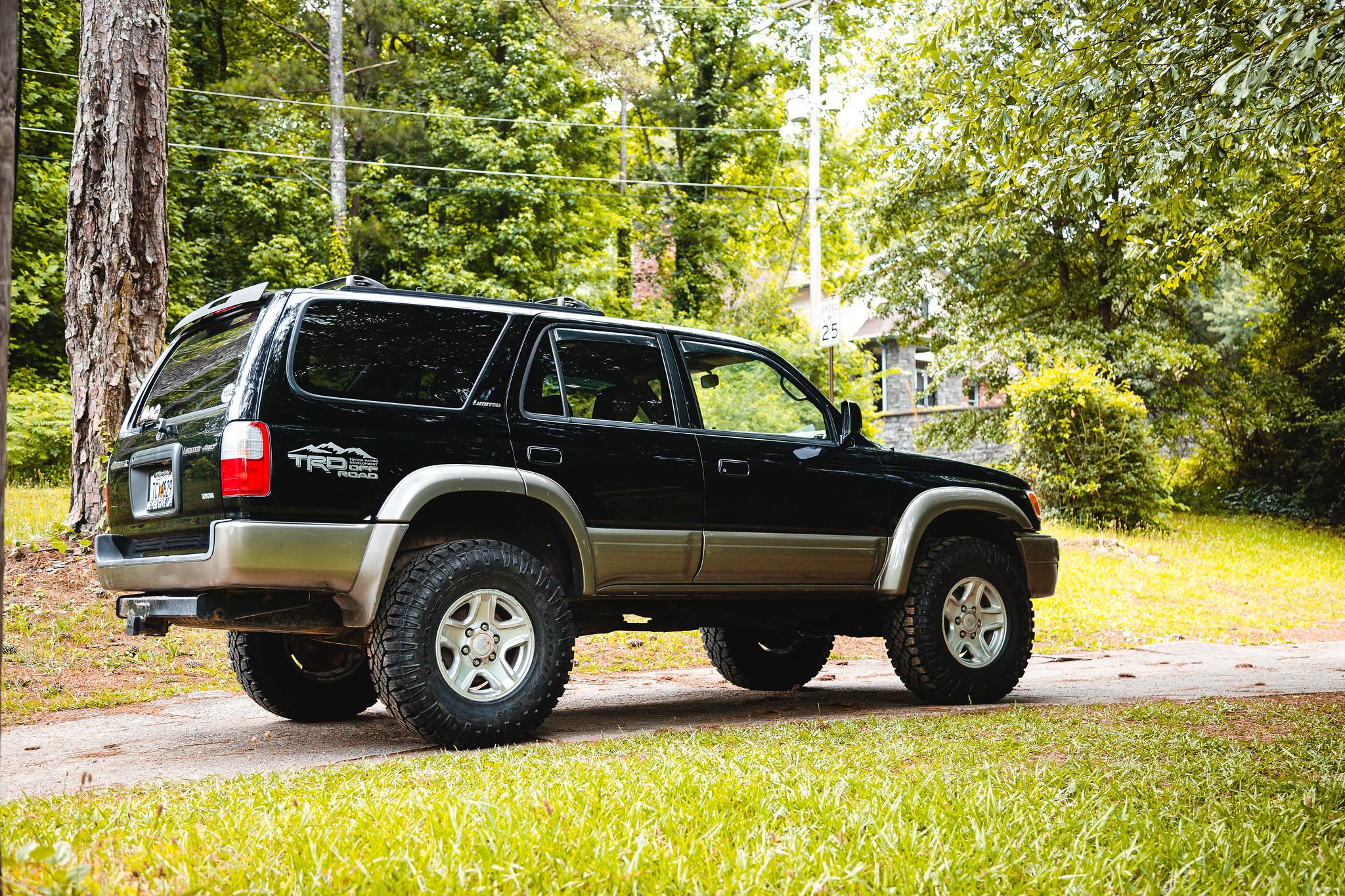

Got it all wrapped up and aligned. Also scored on a trade. Traded my 265's for 285/75/16's. This truck rides a like dream now!

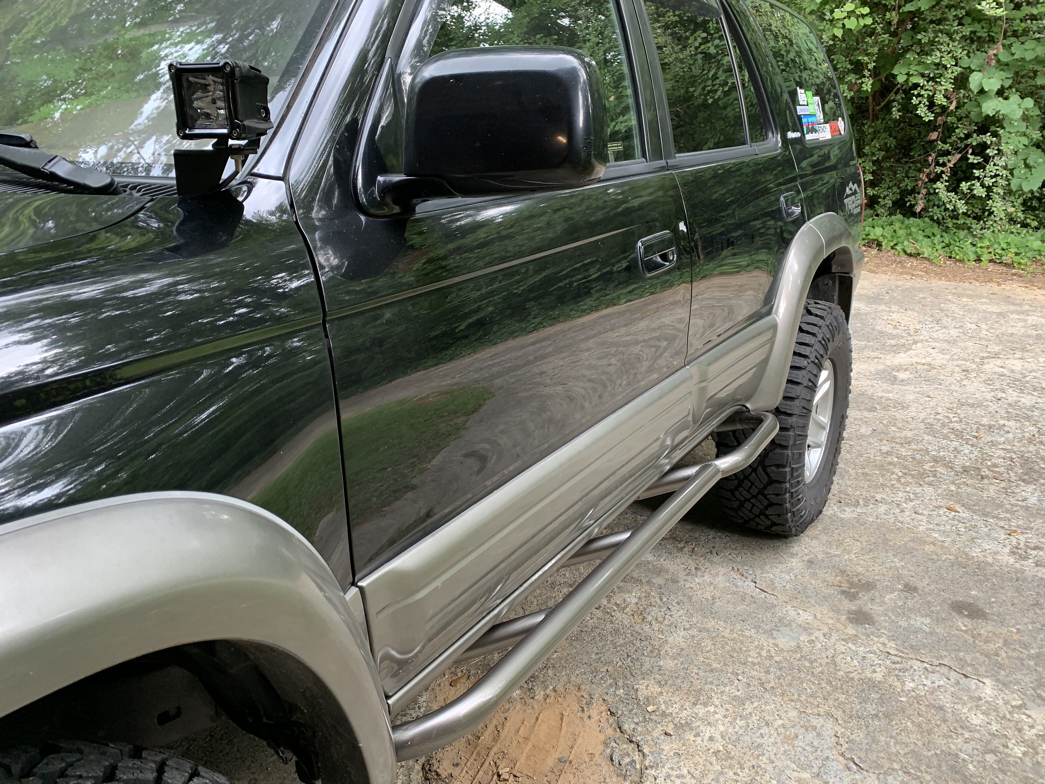

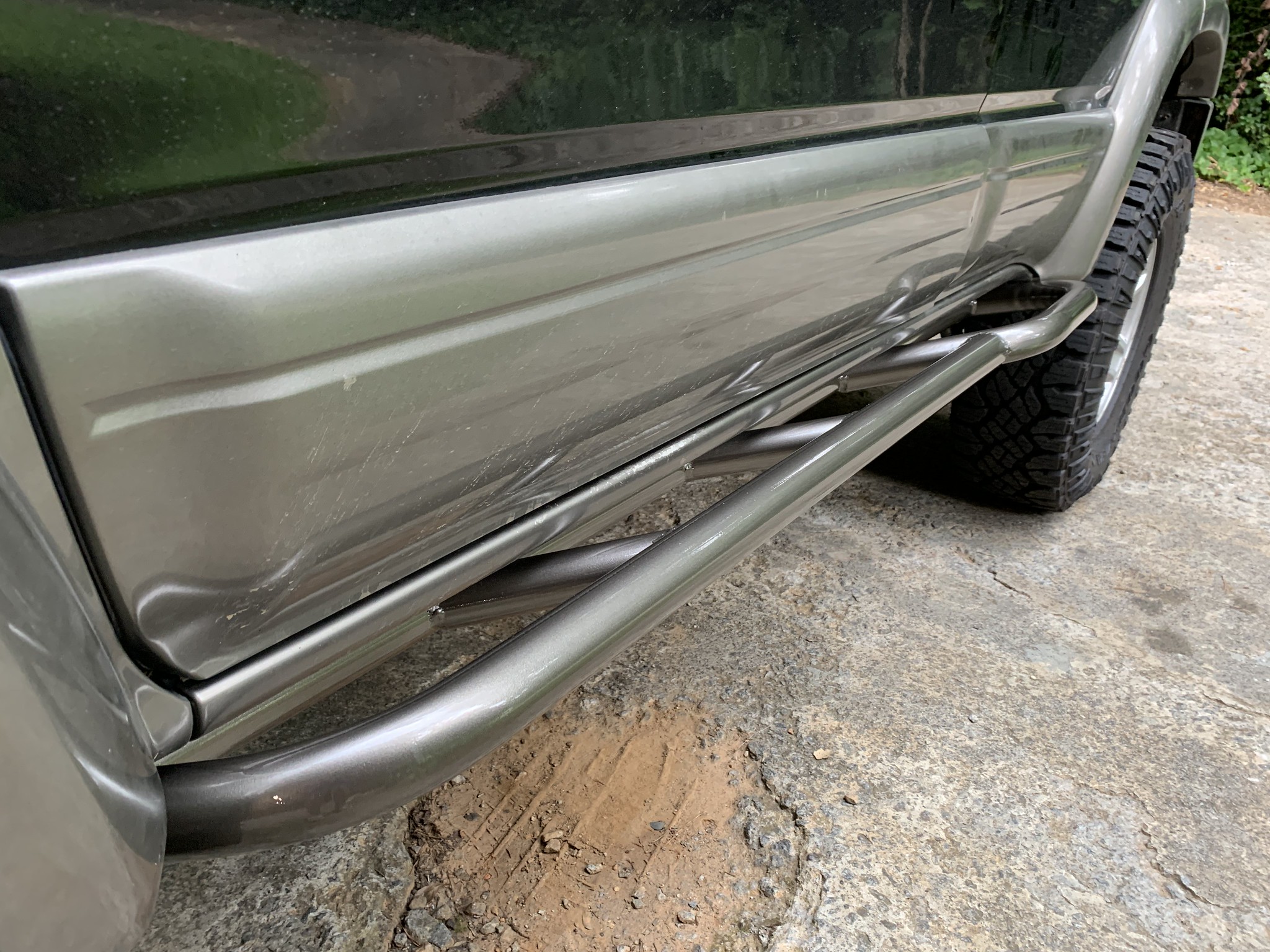

Sliders done and painted. I painted them the same color as the lowers. Might be a little too nice for sliders lol, but I think they look clean.
Also started installing some ditch lights, CBI brackets, auxbeam 8 gang switch panel. Just need to actually run the wires from the lights to switch panel now.
