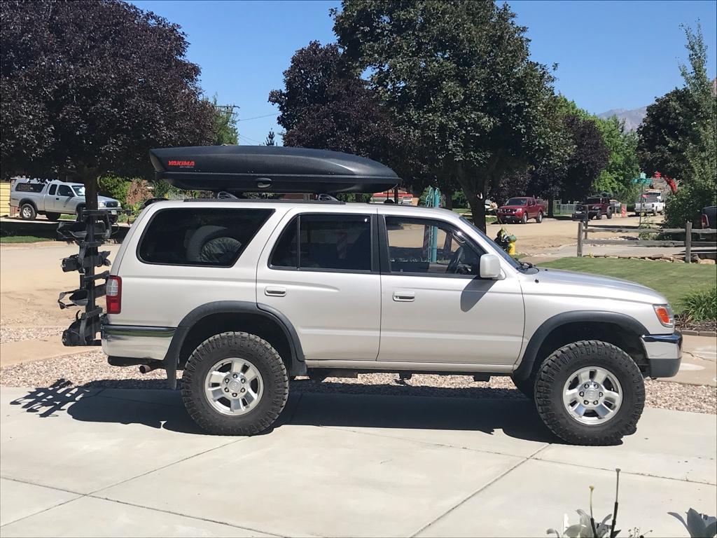

The variable rate springs from Dobinson’s are highly recommended. Nice when unloaded, but resist squat on road trips with weight. I carry 4 people, 4 mtn bikes and gear and it sits level. It will be a 2.5” lift though. I have ‘99 talls in the front the lowest 5100 position which is about 1” lift. So I have slightly more rake built into it. But I carry a constant 100- 200#. Less in winter without the bike rack. It looks good
This pic has a 100# rack, and a built out platform/drawers with gear in it 150# + and not sure what was in the roof box.
