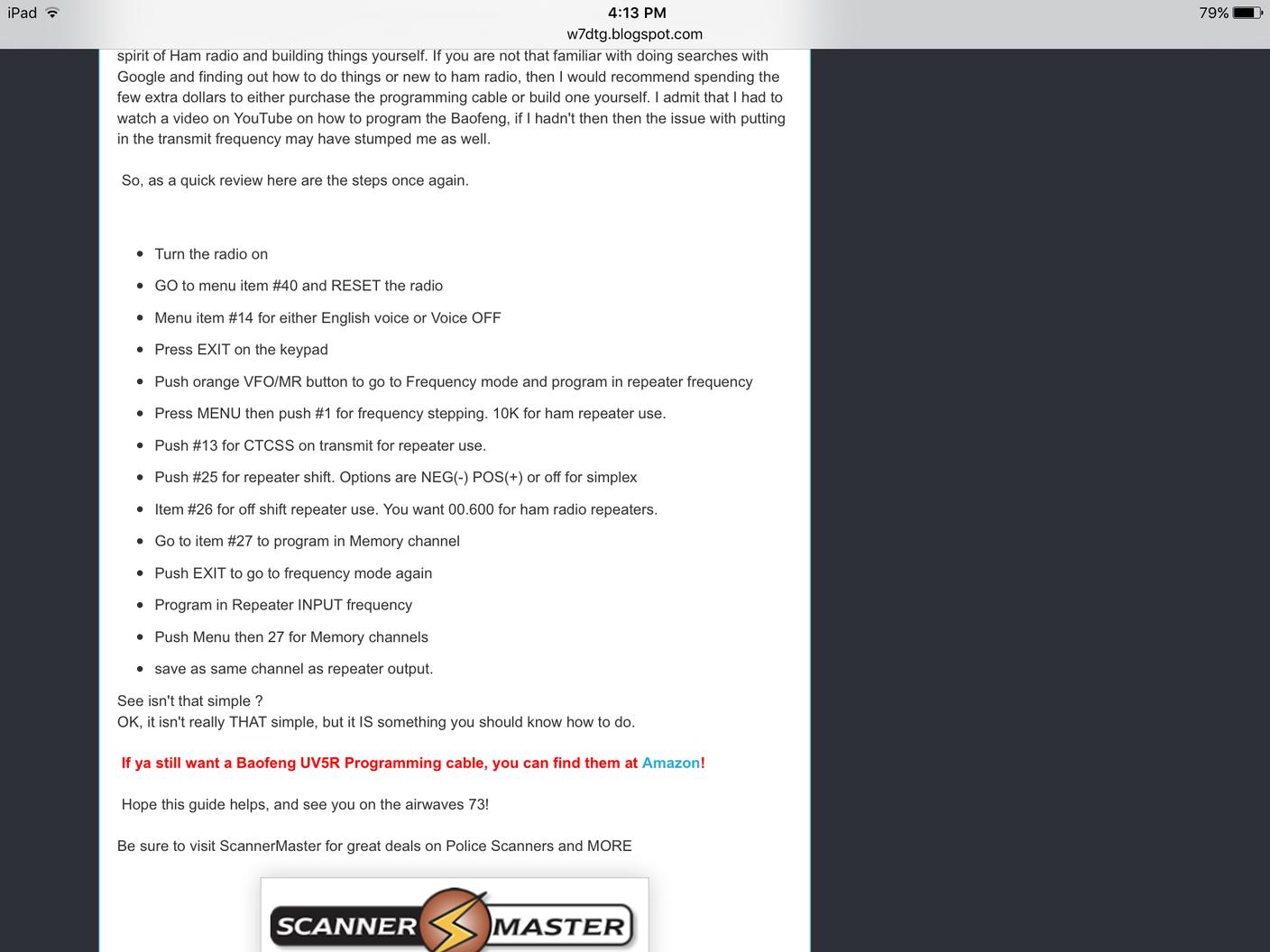

Program Baofeng
Here is a ..how to manually input programming your Baofeng handhelds.
I just tried it myself to see if it would work and it does perfectly.
The whole detailed step by step is located here
W7DTG That radio dude: An idiots guide to programming your Baofeng radio
And this is quick version from that page
My only question is the freq. [MENTION=60694]TheSentinel[/MENTION] has it as 467.6875 the freq is only xxx.xxx So it it 467.687 pl 67?
Its because its a top secret frequency that only I can use.
So what's the right freq? As top secret as it is, I like to be prepared before I get somewhere =P
edit: nevermind. You need to set the step to 2.5 so you get the 5 on the end. I was going based on Miah's instructions.
Yes. It's a narrow band frequency. You technically could just not add the 5 and it would still work, just not at 100%
