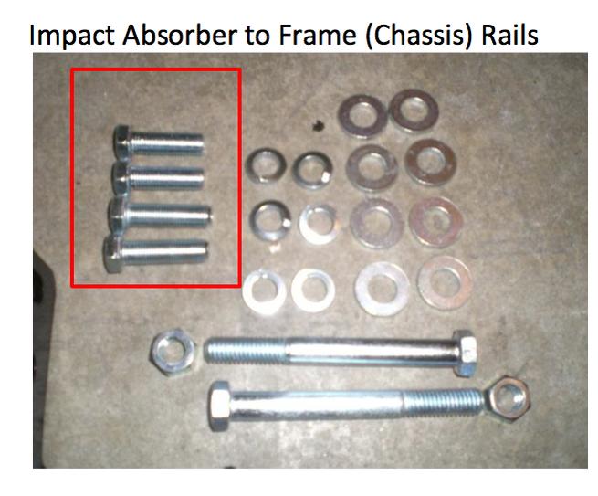

Installing a ARB front bumper on my 3rd gen mañana.
I bought it used and I did not get the hardware that bolts the ARB impact absorbers to the frame. Wondering if anyone knows the specs on the four bolts?
I searched online but didn't come up with anything.
Stock bolts probably won't be useable I'm assuming.
Any help would be greatly appreciated.

What he said ^

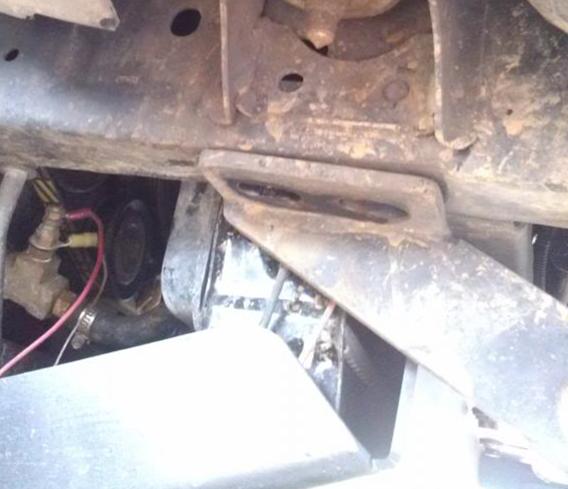

Alot of the hardware goes unused because when you stick it on a tacoma you have to use the frame extender boxes (or atleast I assume). I had alot left over from my install, and two and a half years later it hasnt fallen off once!
The long bolt you have to drill a vertical hole in the frame for, both sets of big bolts are for the frame extender piece which we dont use. Unless you cut it up to make the endcap like I did.
<a href="https://www.flickr.com/photos/102663750@N03/9859039383" title="Endcap by Tyler Carvell, on Flickr"><img src="https://farm6.staticflickr.com/5538/9859039383_0d4216dd19_z.jpg" width="640" height="480" alt="Endcap"></a>
This picture also shows the placement of the vertical bolt.
