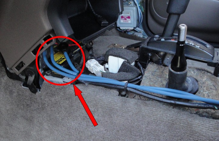

Nope. The airbag sensor in 4runners are located in the center dash below the stereo and Qyota is right. They are just accelerometers
What the greenmonster said. Here is a picture of the deceleration sensor in a 97...black box with the yellow label. It's mounted on the transmission hump just below the center dash.

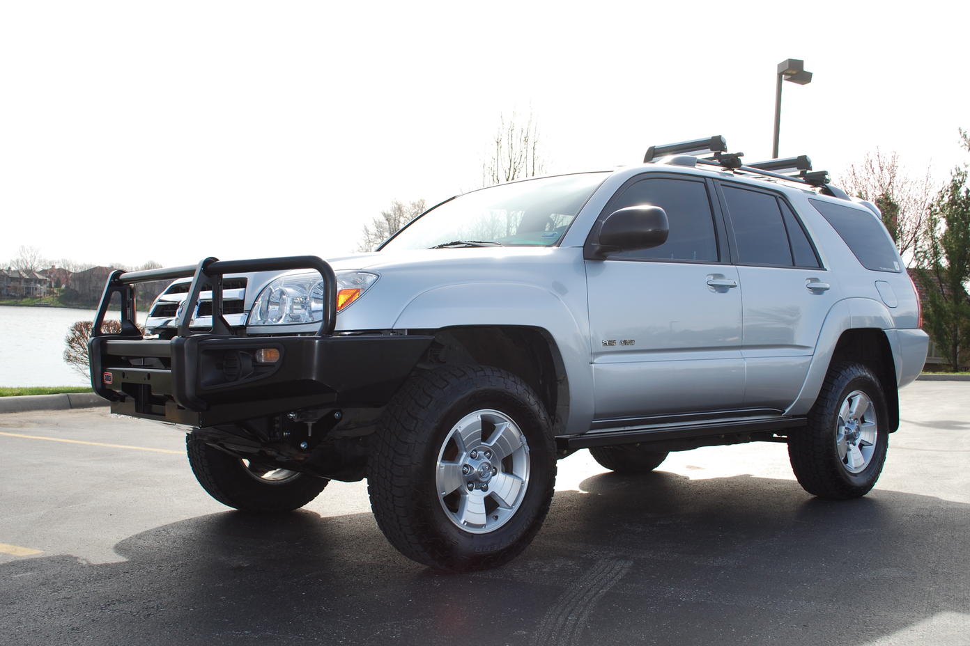

Just installed my ARB bumper a couple days ago. Very pleased with how it turned out. I was also torn by the shrockworks and ARB but decided on the ARB because of price and no wait time. Using the dough I saved to by some lights for the bumper.
