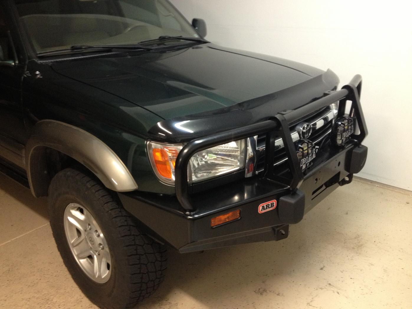

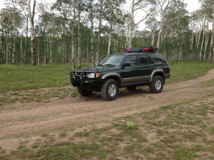

Finally got around to installing my ARB bumper and PIAA 520 ion crystal lights. There was quite a bit less cutting of the frame than I thought I would have to do. It was a pretty easy job overall.

I didn't notice any extra rake, probably because I don't have a winch so the bumper only added about 50 pounds.
Gotcha. I doubt I would add a winch myself if I were to install the same bumper. I've been waiting for one to go up for sale locally at a good price, but no such luck. It would just be more comfortable to drive our back roads with that thing mounted up front.
I just saw that you have 881's up front so I'd probably follow in that direction since I doubt my '99 tall coils would hold the extra weight as well.
Thanks for sharing!

The install was very easy. The hardest part was cutting the frame end caps off but that wasn't too bad once I had measured it many times. Overall it took about 4 hours including the two trips to Home Depot to get wiring supplies.

It's super easy. With a hacksaw and a drill you can install it in your garage. Only thing I needed anything more for was the endcap mod. And that's only if your doing heavy winching (some don't even do it then)
No you are probably thinking of the TJM bumpers. The ARB bumper is technically a Tacoma bumper, to install on a 4Runner you need to cut the mounting plates off the front of the 4Runner frame.
I miss my TJM. Sucks they quit selling them in the US.
Looks good though. Now you need to get a license plate to cover up the spot for the winch.
So you just cut the frame endcaps off and leave the boxes open? I thought it was best to weld the frame boxes closed?
There is an "end cap mod" where guys have welded a piece inside of the box ends to help strenthen the ends of the frame.
But the 'standard' install is to leave the box ends open. The ARB has brackets that slide onto and partially 'encapsulate' the ends of the frame, and then attaches to the factory bumper and tow mounts on the frame as well as a bolt that goes through the frame end from top to bottom. I personally think it's pretty stout that way. Unless you are doing heavy duty winching I think it's fine. For the occasional $hit i'm stuck I need to give myself a tug winching should be good.
