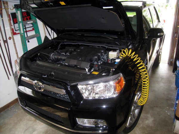

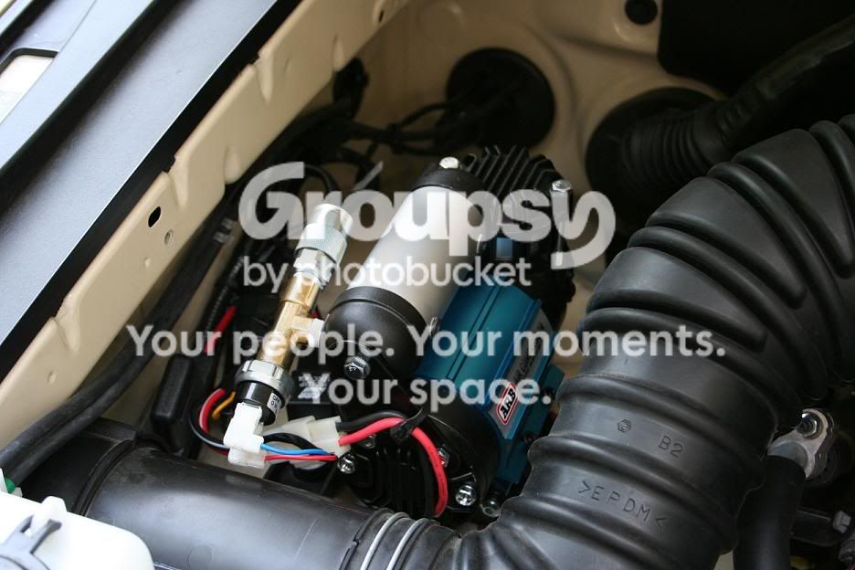

Here is a pic of it installed on the FJC I used to own. The foot print of it is pretty small and I had it tucked behind the air intake hose.

I found on the 2010 4Runners there is a nice spot right behind the passenger headlight area.

Plenty of room behind the intake like you had it on FJ . You just have to be creative to make a shelf or brackets.

I can attest to that fill-up speed. Mine is essentially the same system mounted in a tool box. From 20 psi to 32, it takes 1.5 to 2.5 minutes per tire depending on conditions. I was certainly tested with the engine-mounted version, but laziness prevailed.

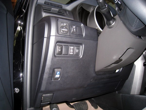

Just got my ARB comp today. Wired it already, and mounted the switch in an empty slot on driver side to left of steering wheel. It works! I am going to locate it right behind the fuse box on the driver side, but I can't figure out how to mount it. Does anybody have pictures of how they mounted their compressors or similar things under the hood? Harper7, yours looks pretty sweet (on the other side), but how does it connect to the vehicle exactly?

ARB Compressor Installed

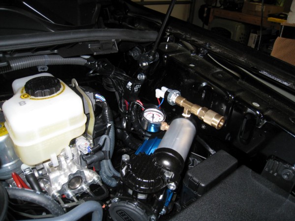

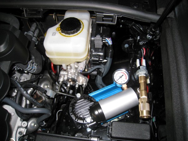

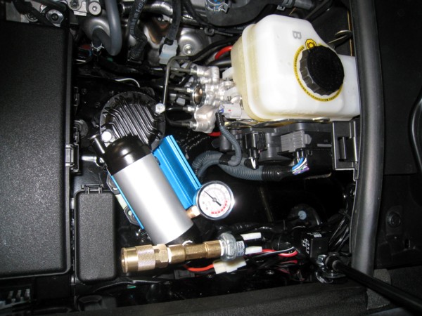

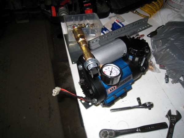

Installed today. Pumps up the factory Bridgestones in about 3.5 minutes per tire from completely flat to 40psi. Ability to add ARB lockers later! We shall see how it does on my incoming BFG 275/70/17 AT KO tires. Pics:

Looks awesome man. This is exactly what I plan to do, although I expected to go in the same spot as Harper. Was there a reason you chose the right side as opposed to the left?
Thanks man! The reason I chose that spot was three-fold.
1. I want to put a tool box in the spot where Harper7 put his.
2. My spot is closer to the battery and to the firewall hole that goes to the dash switch, which is easier to wire up.
3. I like that it is on driver side versus passenger side.
Hopefully my choice of location won't cause other problems down the road.
-Dan
