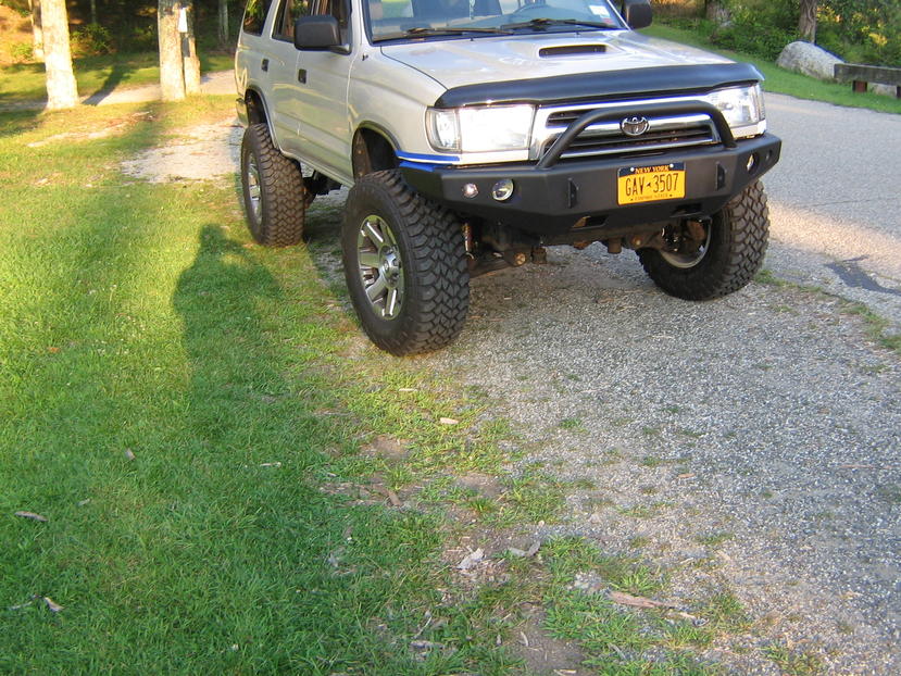

i h8 to humor these sort of posts but it was a good reason to post a pic of my RIG...... this pic exemplifies my bumper gap from my 1.5" body lift

thank you for the photo. i never saw that gap before. it's hard to put a judgement on it. (not yours but in general)
I have a 1" BL waiting for installation. Trying to get an idea of what I'll be getting into so I won't be surprised.

i'm planning on tending to my gap
but this is just an example of what can happen with a body lift which can happen to any bumper type if you don't plan accordingly.
i must admit you need to modify the TACO ARB bumper for a BL as there is no ARB produced remedy. the other brands will make it easier to install with the appropriate compensation for your BL

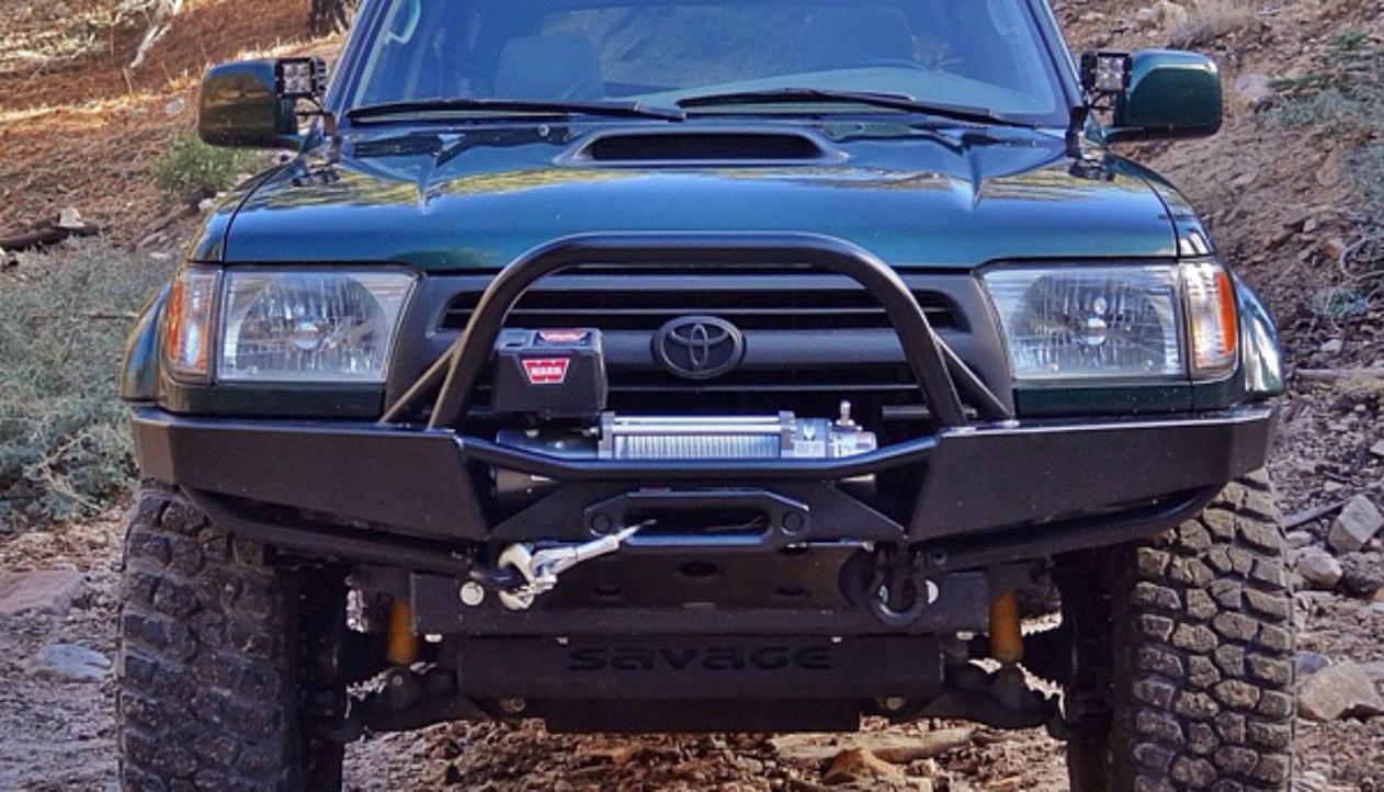

Here's the Addicted OR plate bumper - no regrets at all.

Everytime you post a picture of your truck I come one step closer to ordering one of their bumpers...
That's funny because I was in your shoes a year ago and every time I saw a pic of [MENTION=88391]NateMob[/MENTION]'s rig with the AOR I said the exact same thing and then the group buy came along and it was a done deal. :thumb:
We do not do body lift bumpers on our Plate version. Its much too hard to modify each set of wings to add in the height and having 4 jigs for each bumper is counter productive. And, I refuse to raise up the mounting system and winch plate for a body lift. It will add too much leverage on an already inadequate frame when winching.
