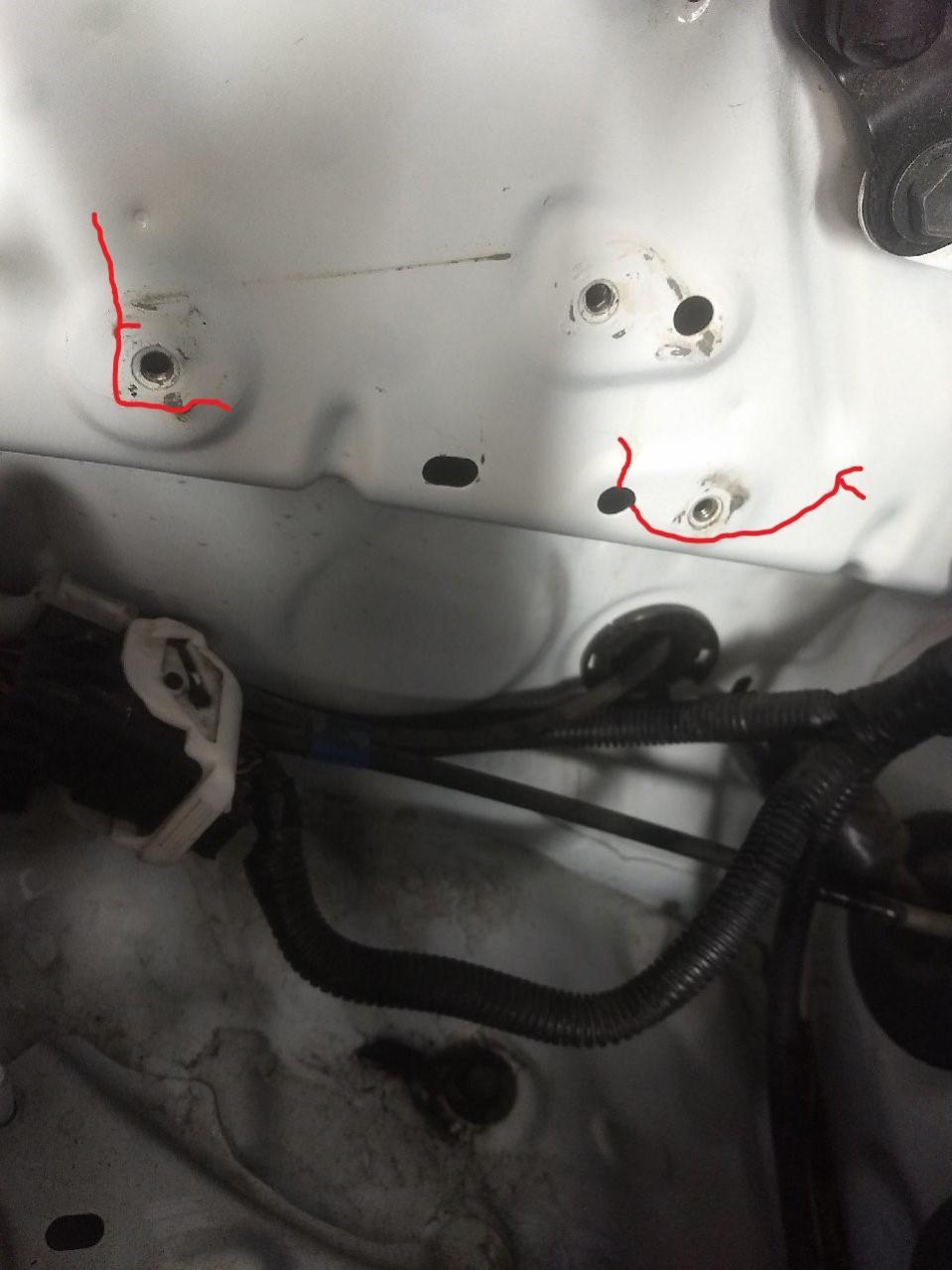

I used a 4x4 labs bracket on the passenger rear and after two (2) years it cracked out the inner fender. Looking for a different solution.
