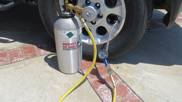

Twin ARB compressors sounds good, I took a less expensive route since all I do is air up after a run.
Home brew CO2, half the cost of a Powertank

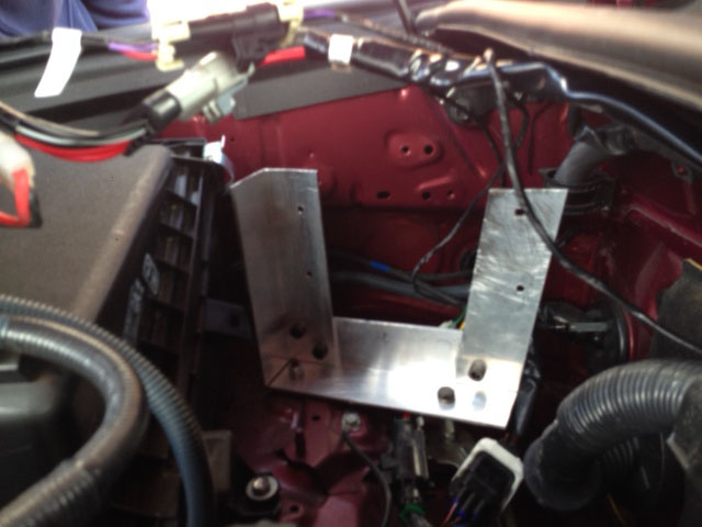

Okki
Two pieces of 2" angle aluminum and a single 2" piece of flat.
I really wish there were a after market bracket but this works, 6 months, so far so good, uses factory mounts with no alterations necessary. No room for a tank though. Considering putting one... somewhere
sorry for the crappy pic..

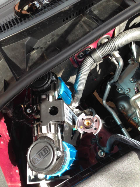

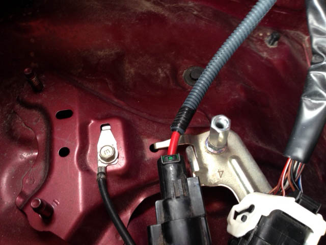

Thanks JRandom... What are the hardware specs to mount there nut and bolt wise and to get it raised over the harness?? I was originally picturing something mounted to the actual firewall/fenderwell...
I am not sure there is enough room to mount it flush against firewall.
I just used a single 1" threaded barrel to level out the bottom bracket. That gives enough clearance after you relocate the power inverter feed line.
