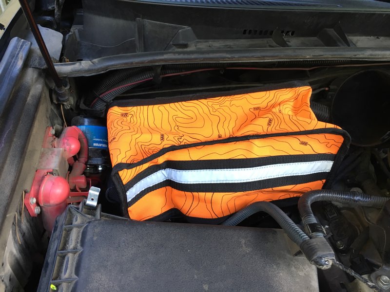

Mines mounted on the opposite side, but I have had no issues, but then again I threw a cover over mine when not in use.

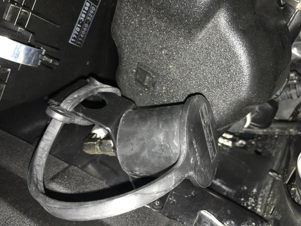

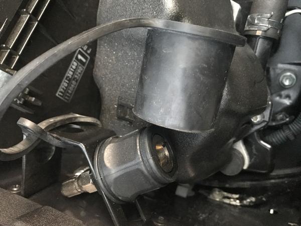

I would protect the hose coupler with a simple cap I got from Amazon. Grainger also sells it. Parker Hannifin Dust Protection Cap H8-66M.
sidko-albums-sidko-s+4runner-picture48987-parker-hannifin-dust-protection-cap-h8-66m-used-protect-arb-quick-connect-hose-coupler.jpeg
sidko-albums-sidko-s+4runner-picture48988-parker-hannifin-dust-protection-cap-h8-66m-used-protect-arb-quick-connect-hose-coupler.jpeg
