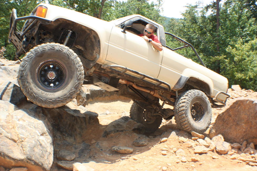

(speaking ofcourse about a somewhat off-camber hill/rock climb like this... IMG_5487.jpg)
had he only had his front locked his right rear tire would have cought the rock in front of it in the pic and begun to spin leaving it up to the front tire and that right rear spining tire to pull him up.. which wouldnt happen unless he had momentum behind it which you wouldnt want to just slam into an obstical like this...
as soon as his rear tires push him a bit further he then has his front tire in the air back loaded to the next rock to assist pulling the ass end up the rocks behindh im..this guy has his rear locked and his front is stock open center however he has 4.56 gears only difference being he welded his rear spider gears to gain the rear "locker" lol so his isnt selectable its just always locked in the rear lol.
