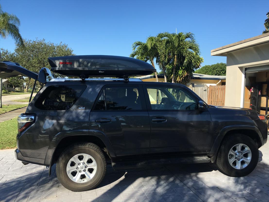

Yes, it will work, but aftermarket is way better for all of the reasons [MENTION=91899]Jhalko[/MENTION] just gave you! Here is my setup, I personally liked the 53" Thule Aeroblades but the Yakima ones will work as well. Virtually no mpg difference and/or wind noise. Just take the OEM ones off as with both sets on it does create drag.
