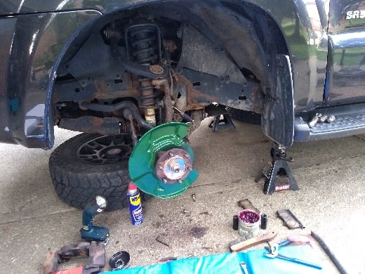

Heres a pic Imgur: The magic of the Internet

Replaced mine a few weeks ago. Very easy to do. Pulling the hubs is easier than you think. I found a set on Craigslist for $80 from a guy who green Rust-Oleum'd a brand new pair because he didn't trust the Toyota paint anymore. He sold his 4th gen before installing them.
