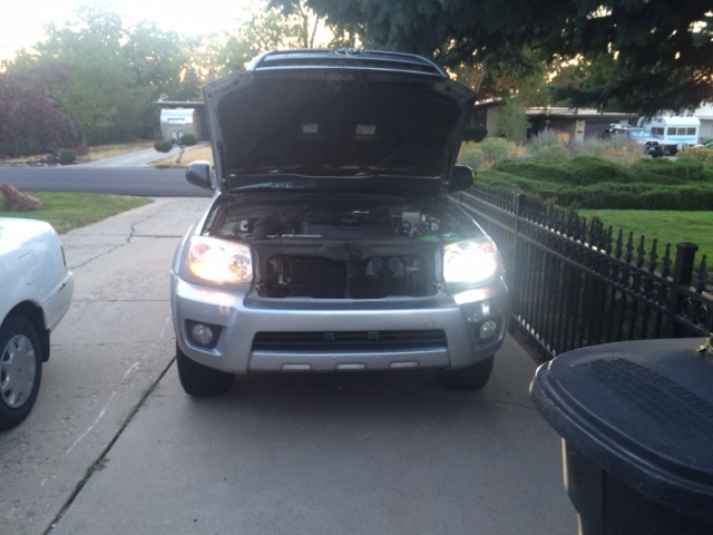

I have a 2006 that I decided to install HID's in a few months ago. I absolutely love them. I got some 5000k's off of amazon for around $60.00. I liked them so much I ended up getting some 3500k's for my fog lights.
Here's a pic of the difference between the 5000k and the stock halogens.

Did you move the squirrel finders around?
