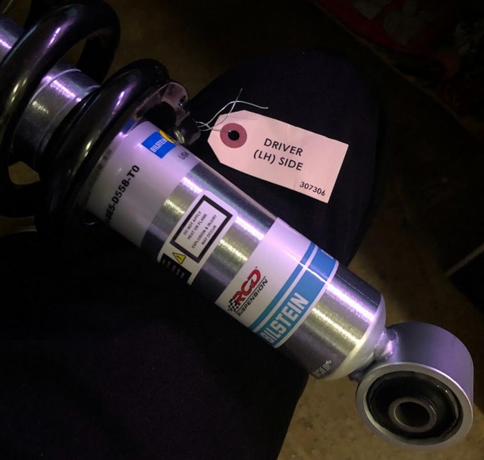

My fronts were labeled - i don't recall if my rears were. I found a photo - this is an 881 front pre-assembled by Wheeler's.

Just to close this off - the 880s are not side specific, but the 906s are. Wheeler's said they used the 1/4" spacer for the front drivers side strut. I didn't install one - there may be a very slight lean to the driver's side in the front, but I don't really notice it say I may just leave it.
