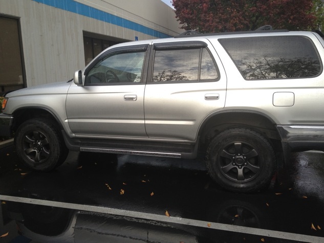

Here is a pic. As it sits. Its a 2002. Stock front springs. Rear ome906. All bilstein shock strut. Strut are set on 3rd notch (middle groove). It still has a rake as you can see. A bit over an inch.
I like how it sits now. The front got a bit stiffer after i set it to the 3rd groove. I throut it felt perfect on the second grove. But there was too much rake for my liking. Keep in mind more rake causes more nose dive when braking. Its best to have a balanced suspension. Right now its well balanced. The rear is still slightly stiffer. But. Not enough to bug me. Btw the front are tundra struts.
