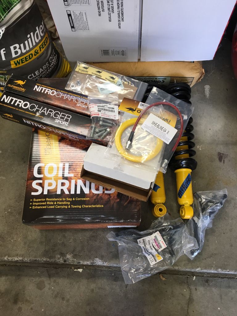

Ive been really happy with my OME OME 881/890 with 60073 rear shocks (soft). It handles well and is not rough at all! I was into this kit for about $1000 once I did LBJ and a few other things.

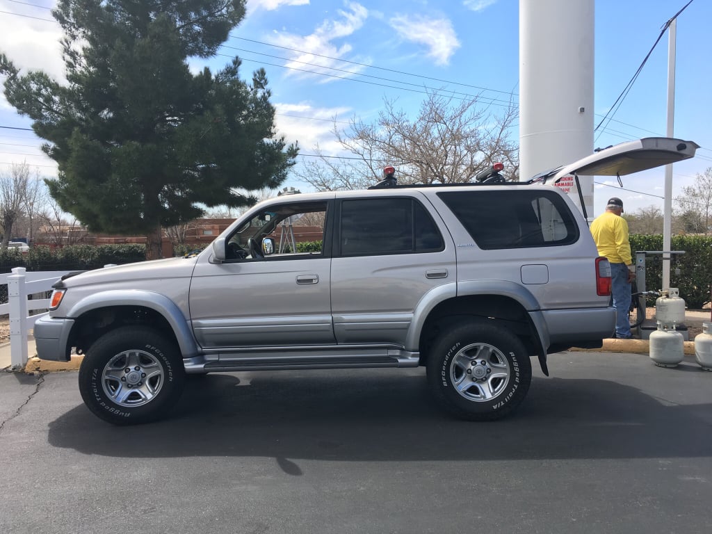

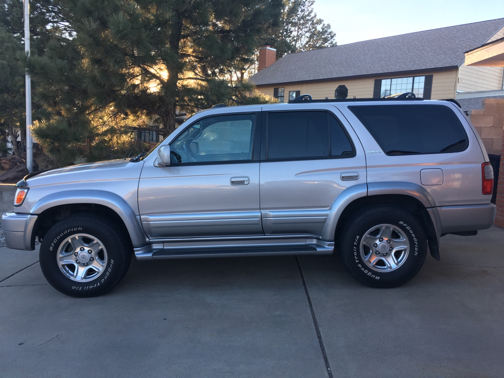

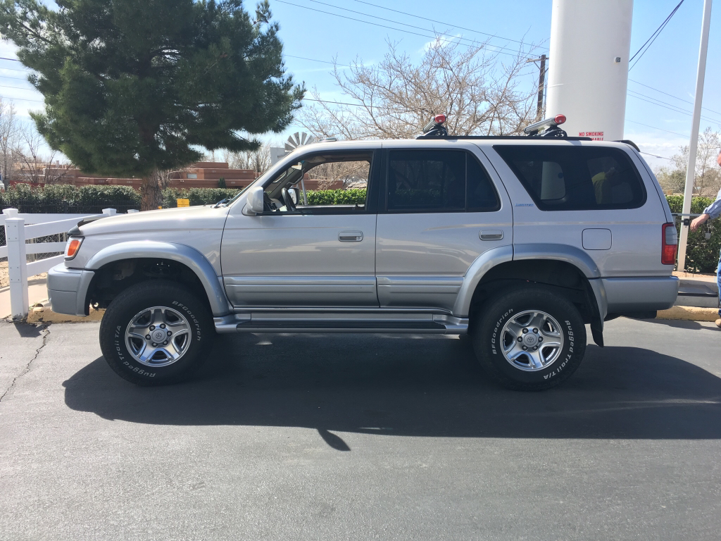

I have a 2000, I ended up getting 3" in the front and 4" in the back but I was really sagged out. I am running my stock size BFG's till they are bald (prob another 5000 miles) and then going with 265-75-16's
After
Loaded with about 100 of weight.
Before
