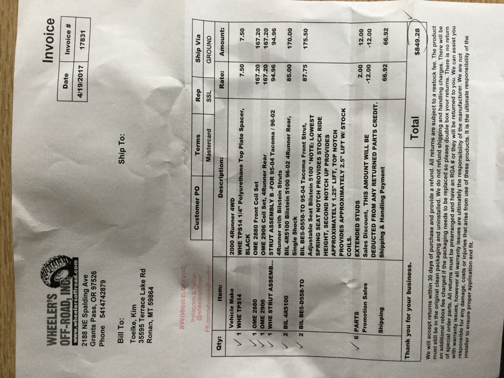

Hi, ktoelke! Could you please let me know the part number of the Bilstein 5100's you installed? I will appreciate your help.
Thanks
Thanks
Sure, ordered from Wheelers fronts are 4R5100, rears are BIL BE5-D558-TO. Wheelers shows two 5100's to fit. One is 0-2 lift, the second, which I chose, and which is a little less expensive,
is the 1.5 - 3" lift.
