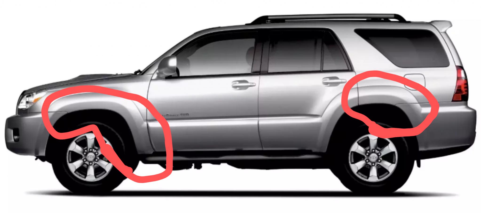

So my lift gate got the infamous rust coming through due to the water getting trapped. I found a 2004 that is the same color as my 2008 in a junkyard a couple of hours away. I also need to replace the two wheel flare moldings. Are those three parts interchangeable between 2004 and 2008?

I believe they will physically clip into place, but they are for certain different profiles. The 03-05 flares are are more flat and subdued, whereas the 06-09 flares are larger, stick out wider, and more bubbly shaped
