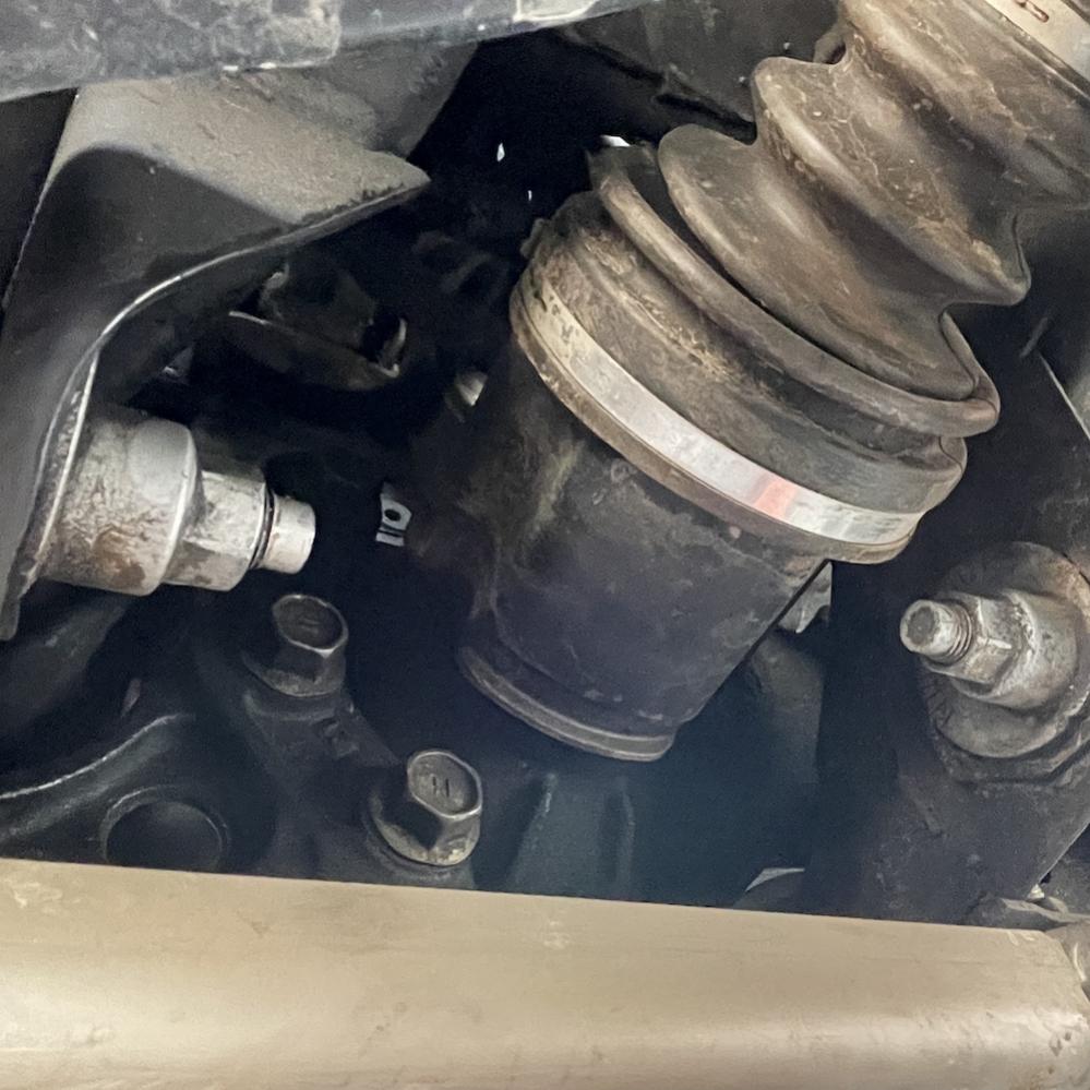

Good news! It looks like the shop put a Toyota reman cv axle on and so far no leaks from the diff. Here’s some photos of the new one. I also added a photo of the driver side cv axle that’s original.

Apparently Endlessblockades cv axles are silver as well. Waiting for him to chime in or post a photo. I’ll tell you this, it’s definitely more heavy duty looking compared to the last one they put on there and matches the original.

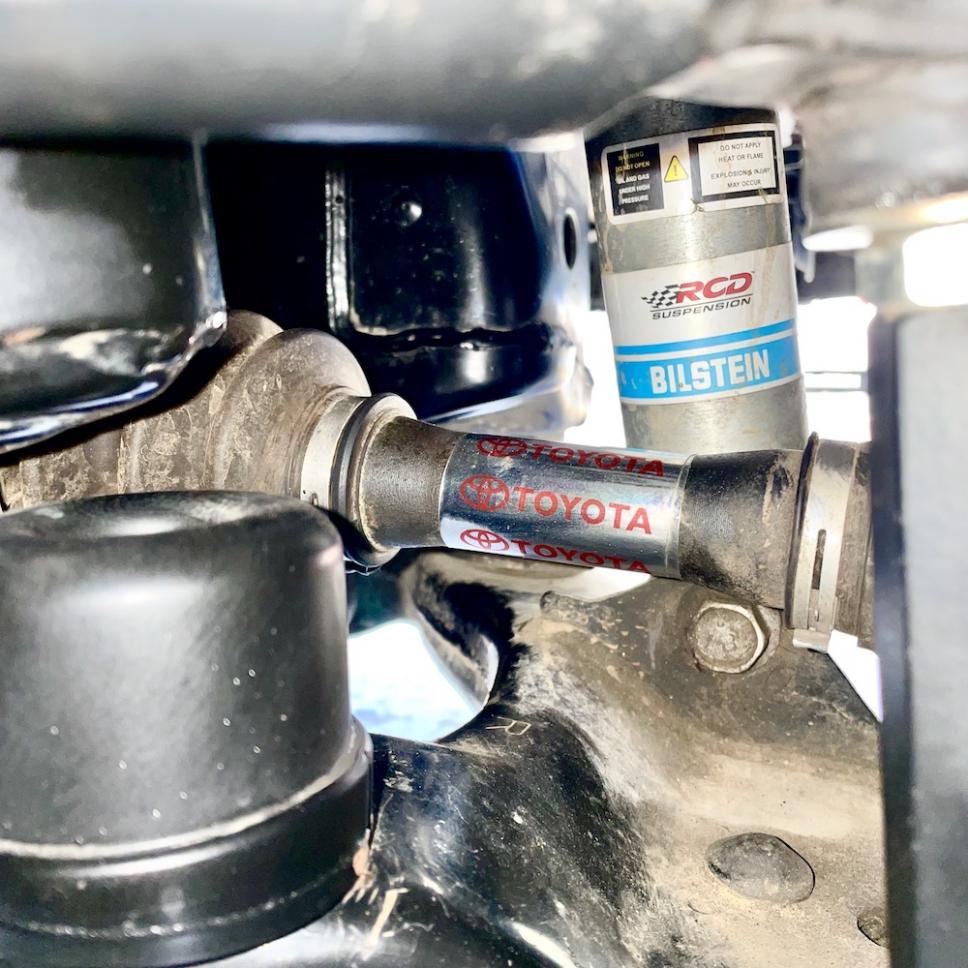

I don't know if these will help. This axle's over a year old but a more recent one I have looks identical. The axle has some surface rust or dirt - but you can see the slapped-on silver sticker and the inner boot. Sorry for the wait for such crappy pics. I'm attaching a transfer case skid tomorrow if some better pics would help. Bottom line is I don't know if these are legit or not - only had these 2 done....

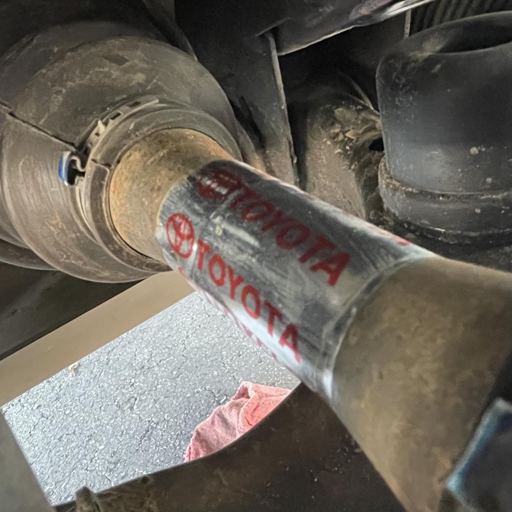

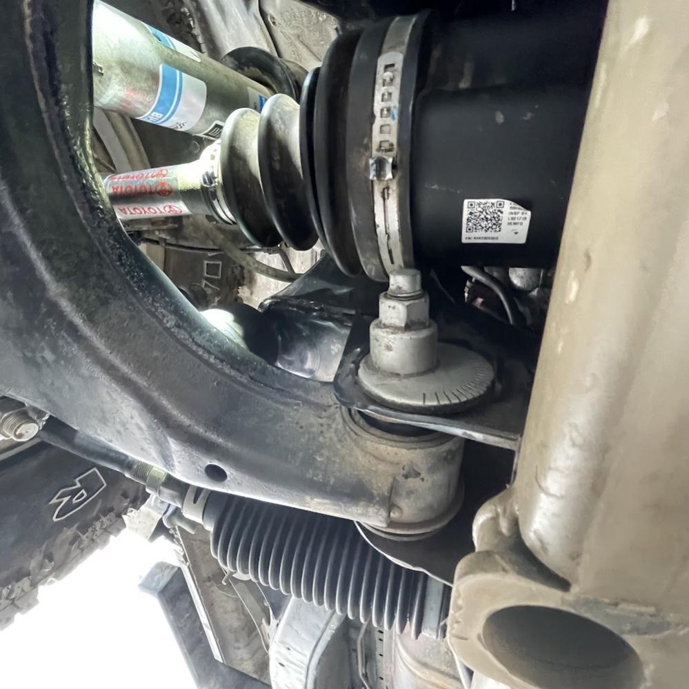

WTF - there were there for a minute! I've never had an issue posting pics here before.
Maybe if I put in my Photos and use embed link:
Black painted inner joint (don't see the outer joint), crimp style cv boot clamps and a sticker on the shaft.
That's how i remembered Toyota made a shaft.
Could it be times have changed on the Toyota reman process requirements? Unpainted joints, fold over lock style boot clamps and no Toyota sticker on shaft.
Yep someone said the inner joint was painted and I wanted to show that. This one is less than 6 months old. I didn't even notice the QR code til I wiped the dust off it. If it's unpainted and totally generic and sold as an OEM re-man, I'd find it a little sus....

Well the shaft looks like an OEM on yours and is clearly showing it’s a Toyota oem axle. I can honestly say, I don’t know for sure that mine is a OEM reman. All I know is the ones the mechanic put on are definitely closer to size then the previous ones they put on there and clearly look smaller and aftermarket.
