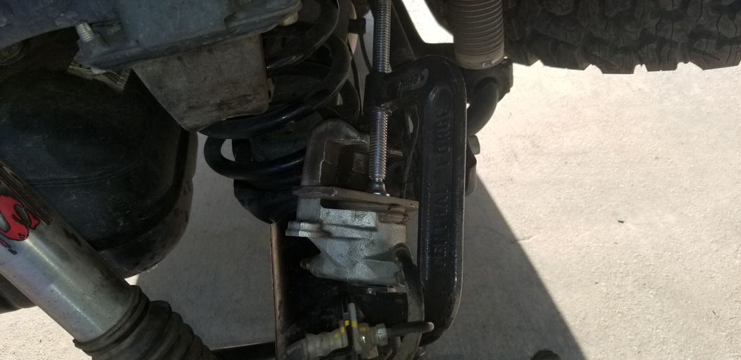

I used an old trick to get the caliper piston back in place. A 5" c-clamp and a piece of scrap steel. This just took a couple minutes including stopping to snap a pic. I did remove the cap on the master cylinder tank first.
I then pulled the other three spacers and it's done.
