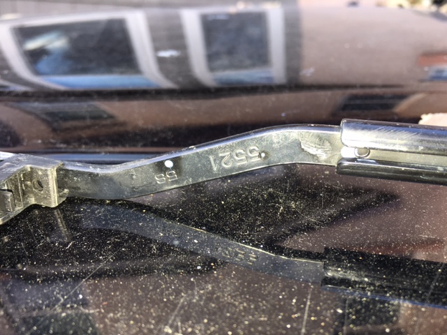

Hey all, I had to take my windshield wiper arms off today to clean under the cowling. I realized I didn't mark which side came from which side, but the arms do look a bit different. One looks a little longer than the other.
Is there a driver's and passenger's side specific arm? Any way to tell other than just re-attach them, spray some fluid and see if it matches the old pattern?
I believe the arms are side specific, they should have a mark in the casting that says L and R I believe.

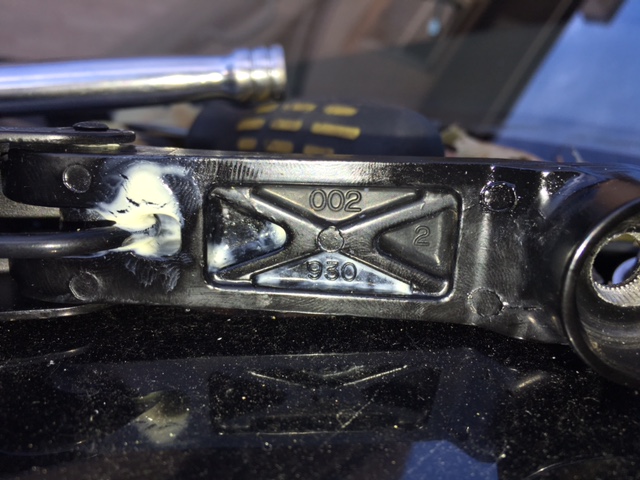

Dang! I could have sworn I looked all up and down the inside of the wiper arms at the markings. I thought all I saw were numbers (that were the same between the both of them), but I'll go check again for an L and R. Thanks!
So, funny story, there aren't any L or R markings on the inside of the wiper arms. They both have the same markings. Thoughts? Is one supposed to be longer than the other/can i just go off of that?

My '99 calls for p/n 85211-35080 on the right side and p/n and p/n 85221-35080 on the left. When the blade is on, you can see the driver's side blade makes a greater angle to the arm. The blade on the passenger side is closer to a straight line with the wiper arm.

I didn't see the p/n's on the arms. I looked. But I think if you put them on the wrong sides, the angle of the blades to the bottom of the windshield will show to be dramatically wrong. Just do it, you'll see.
Do you think those part numbers are stamped somewhere on the arms?
The one in that photo has a 5521 on it, see if the other one has a 5511. Based on what Durk posted I'd bet the 11 goes on the right and the 21 goes on the left. The part number has probably just incremented due to a revision or some other minor change.
Now that's some logic! Good call. I could have sworn they both had matching numbers, but I'll pull 'em off again to check. Other than that, I'll just look at the angles I guess. I kind of think I have them backwards now. Hah. Trust me, I'm going to label them with a sharpie once I figure this out.
Well, you have a good idea, but it's backwards. Now that it's daylight, I can see mine is marked 5521 on the right (passenger) side, and 5520 on the left (driver's).
Hmmm....strange that those numbers don't correlate at all with the actual part number. I wonder if that PN is just for the section of the arm it's stamped into.
Either way, I guess that's problem solved.
Sweet, so I put the 5521 on the passenger's side and the 5520 on the driver's side. I think that's actually backwards from what it was before, so I wonder if that explains some of the funkiness I've had with windshield wiper performance.

Just in case anyone runs into this in the future...(and to help the SEO terms in this thread)
Driver's side windshield wiper arm is 5520 and the passenger's side windshield wiper arm is 5521.
