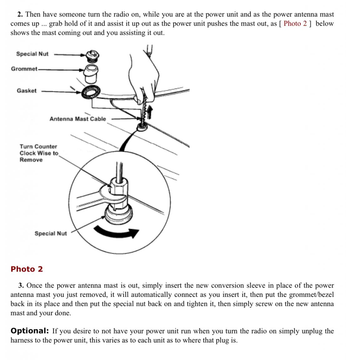

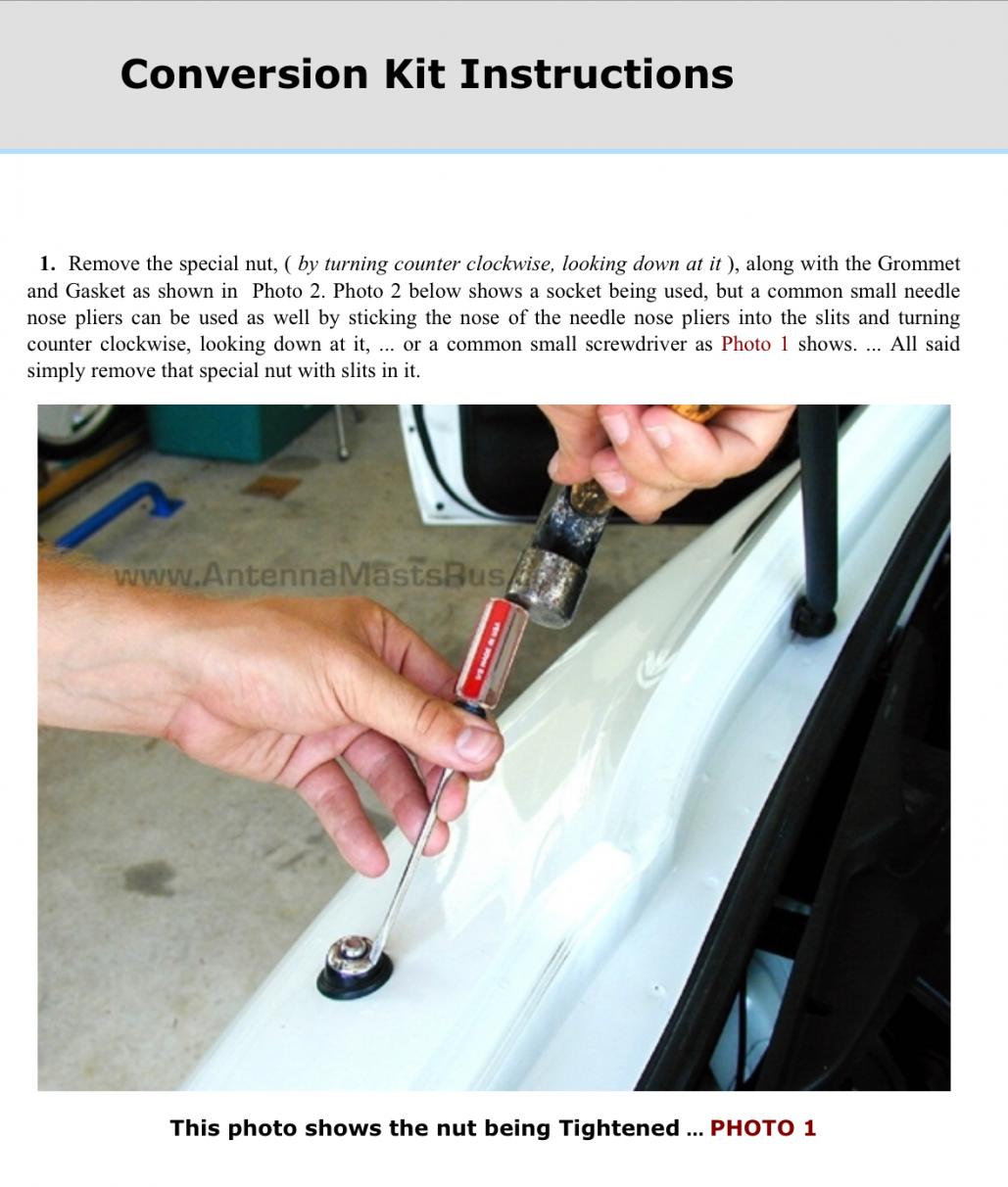

So My power antenna went up and up and out yesterday and now i need this. Can you please provide the install process of this.
ThanX
Click on the link in post #18.
Select 96-02 4Runner and follow to the link for installation instructions.
It literally takes a minute to install.

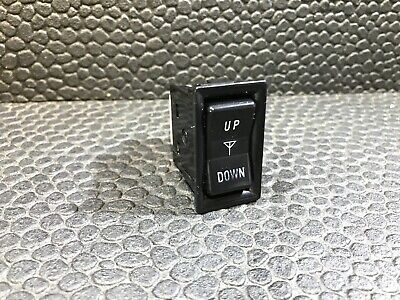

Always use Landcruiser switches for that o.e.m. look.
