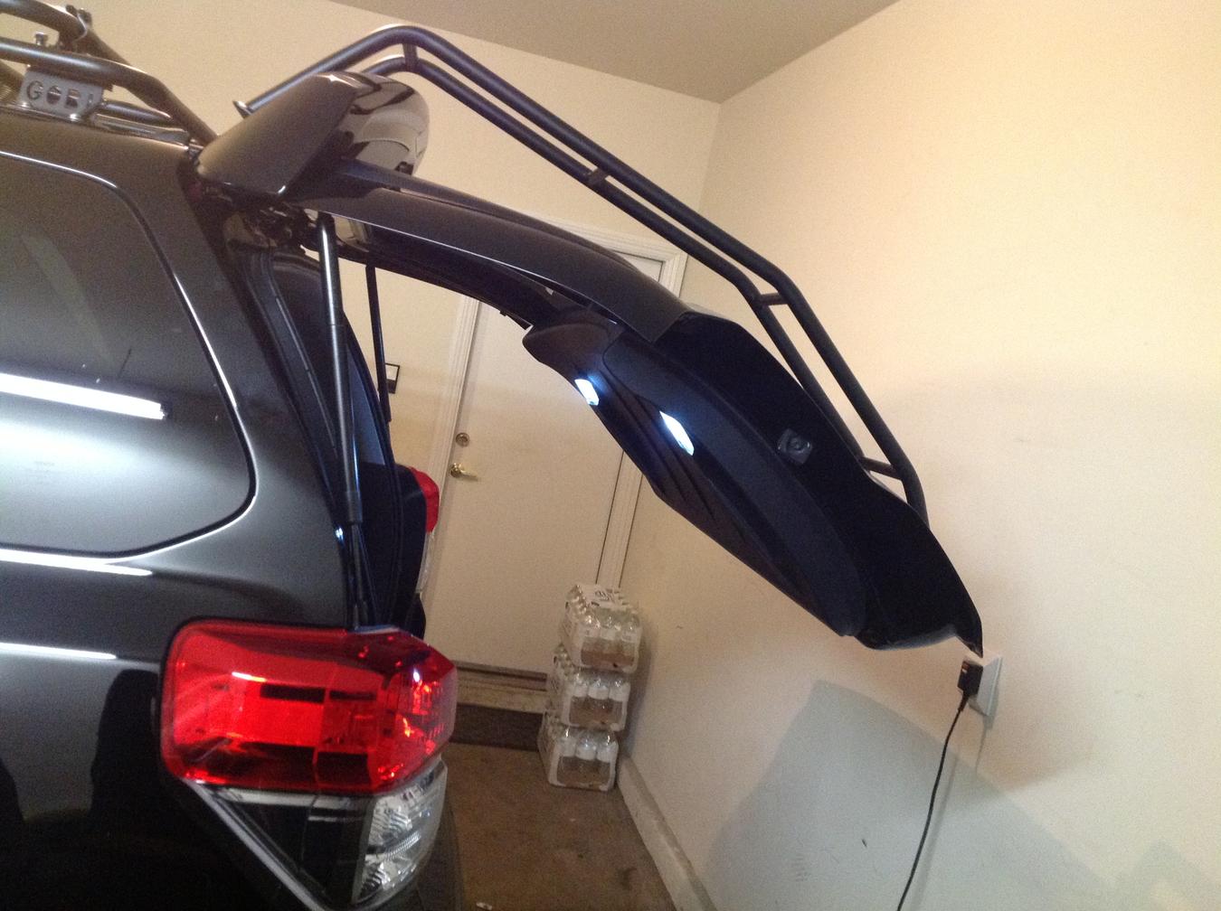

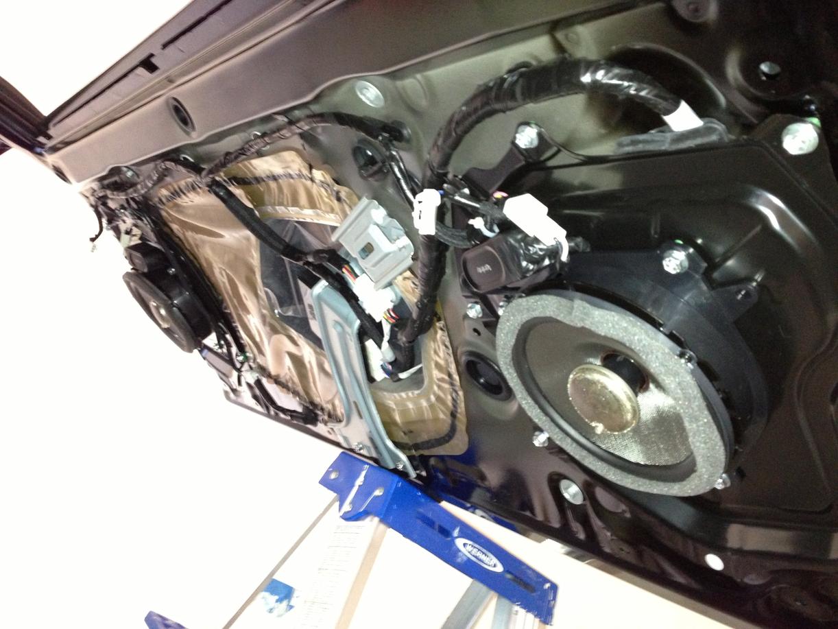

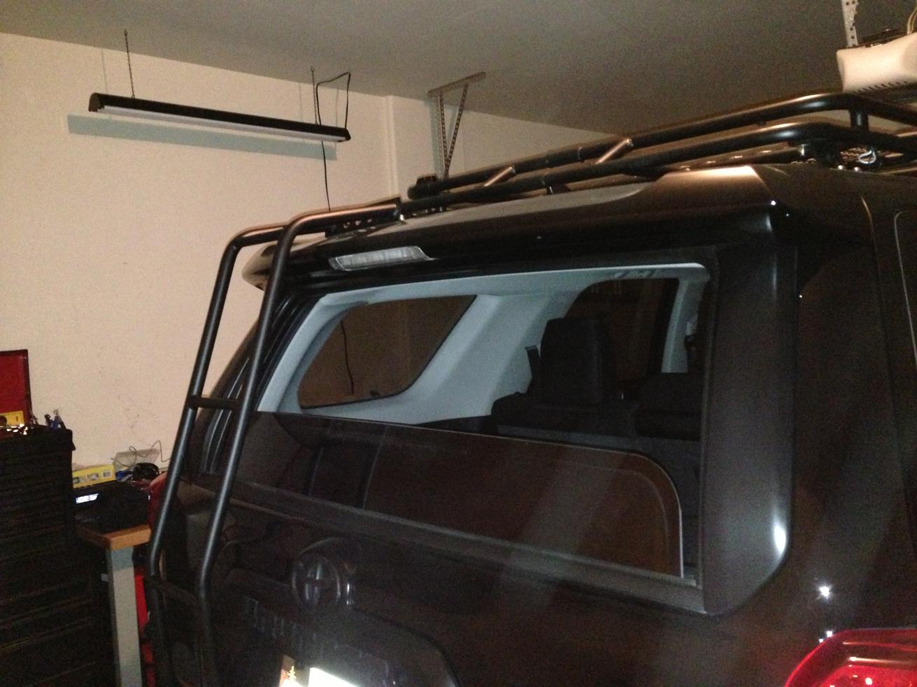

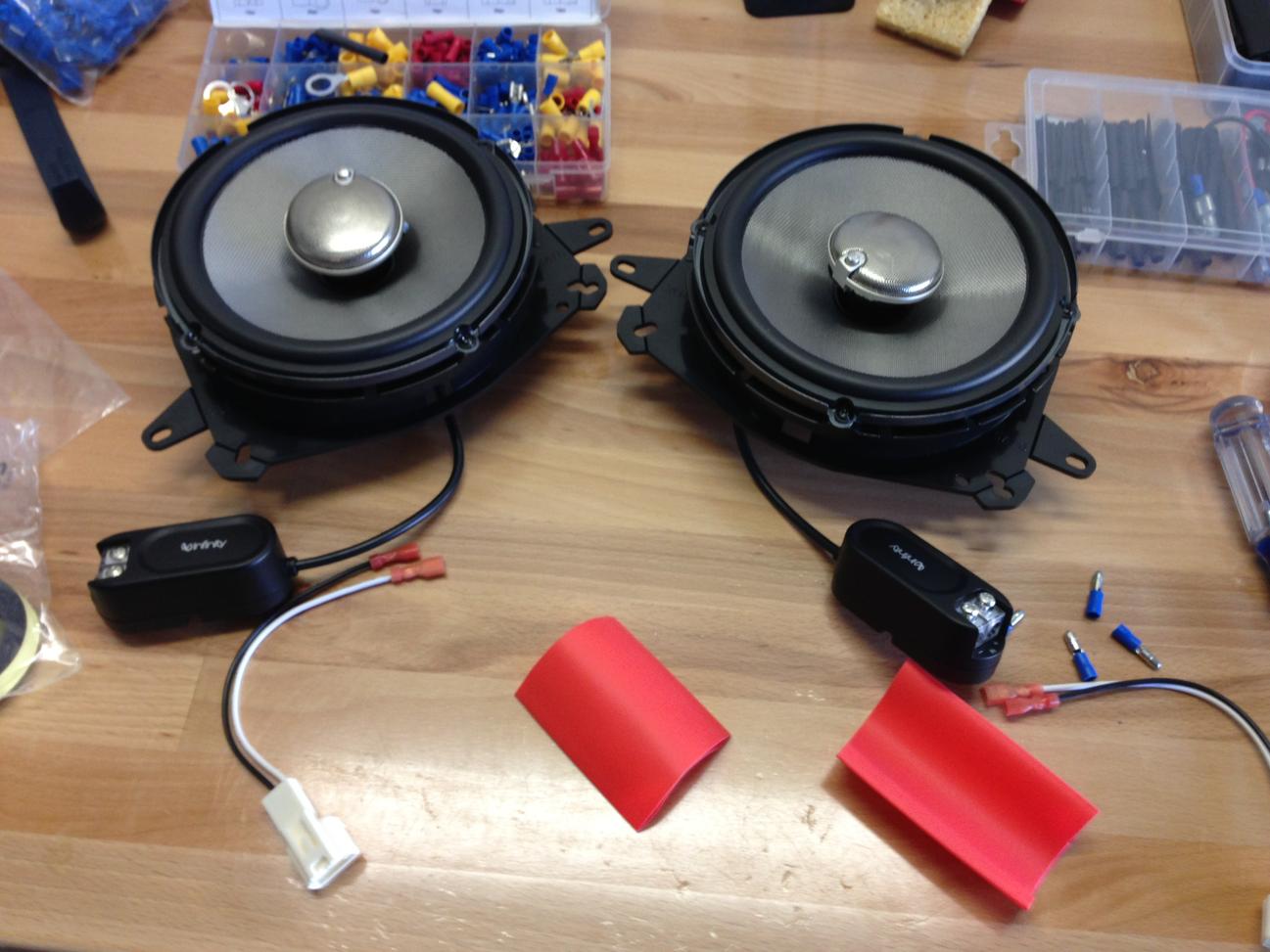

Instead of gutting the stock speakers to mount the kappas I tried using the speaker adapter plates I got on amazon... terrible idea... so looks like the speaker is too deep and hitting the window or maybe the cross over connected to the speaker came lose and is interfering with the window..Or possibly my fat arm going through that tiny speaker hole to lay the sound deadening broke something or maybe the sound deadening got put where it could interfere... back to the drawing board

New stuts needed thanks to the Ladder+Speakers+sound deadening...

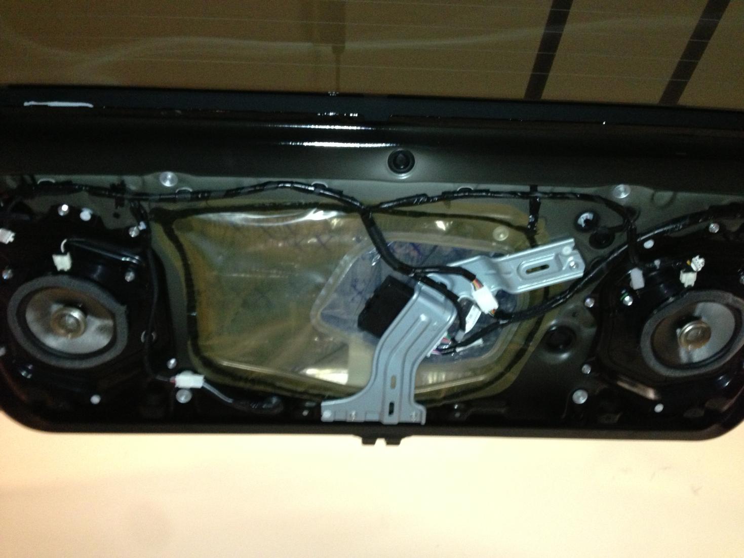

So lesson learned...the crossover was getting in the way of the window not the actual speaker. I wrapped the crossover in boommat and used double sided 20 pound tape to keep it attached to the inner side of the rear hatch which made it too thick....Quick fix took off the boommat and attached it above the speaker. Window works and the panel popped back on with no problem.:beer:

but in this circumstance the double sided tape is just to keep the Kappa crossover in place... it is in there nice and snug between the panel... It's just me going overboard with the tape to try to ensure no vibration from the speakers... I am so surprised and amazed that I have now ripped apart my panels multiple times (usually because I don't do it right the first time) and they are like the legos you played with as a kid, they pop right back together.
