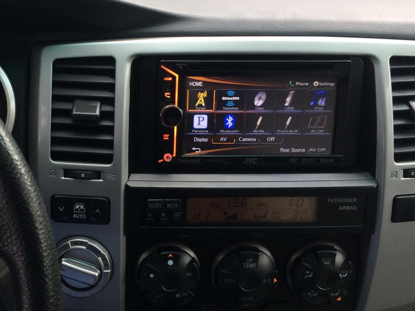

I finally figured out what my problem was... One of the pins in the in dash harness was bent so it wasn't supplying the unit with power. I got it installed and I am happy with the result. Next up is to add some USB ports inside the console.
