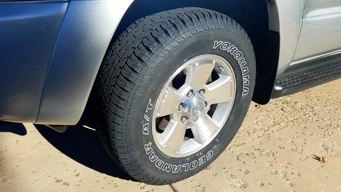

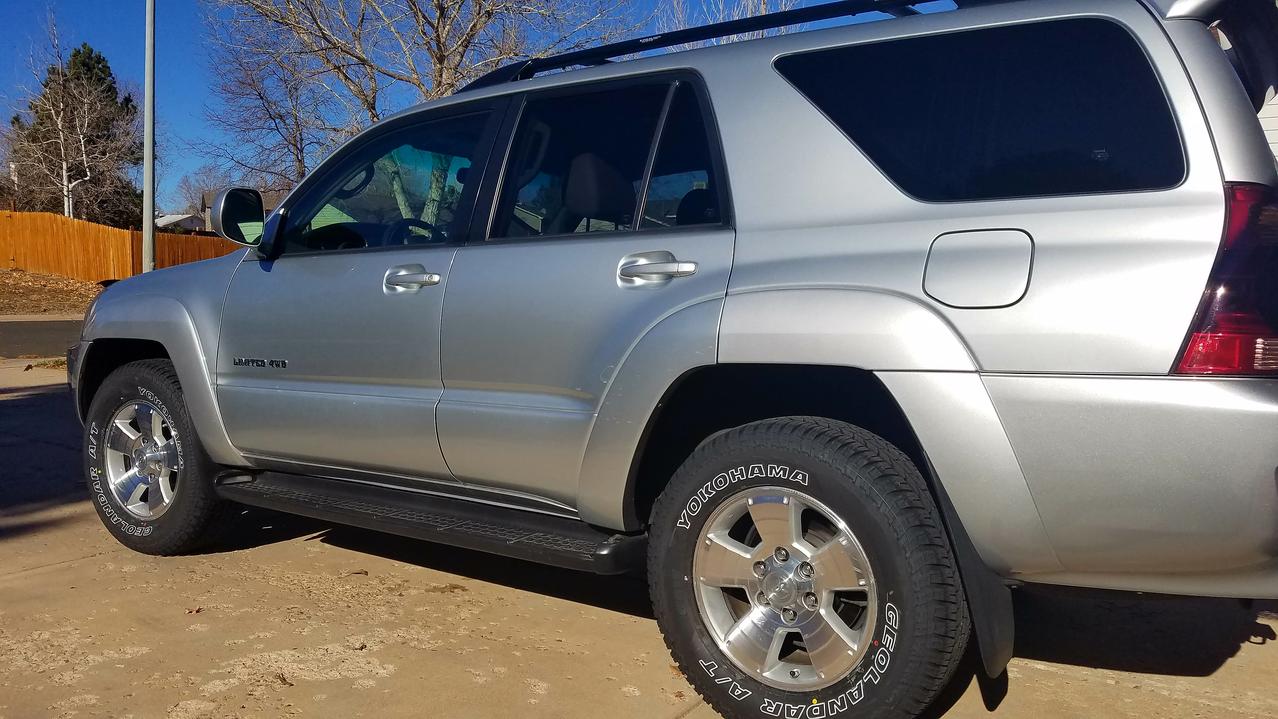

Yokohama Geolandar A/T G015
Baby got a new pair of shoes this past weekend
