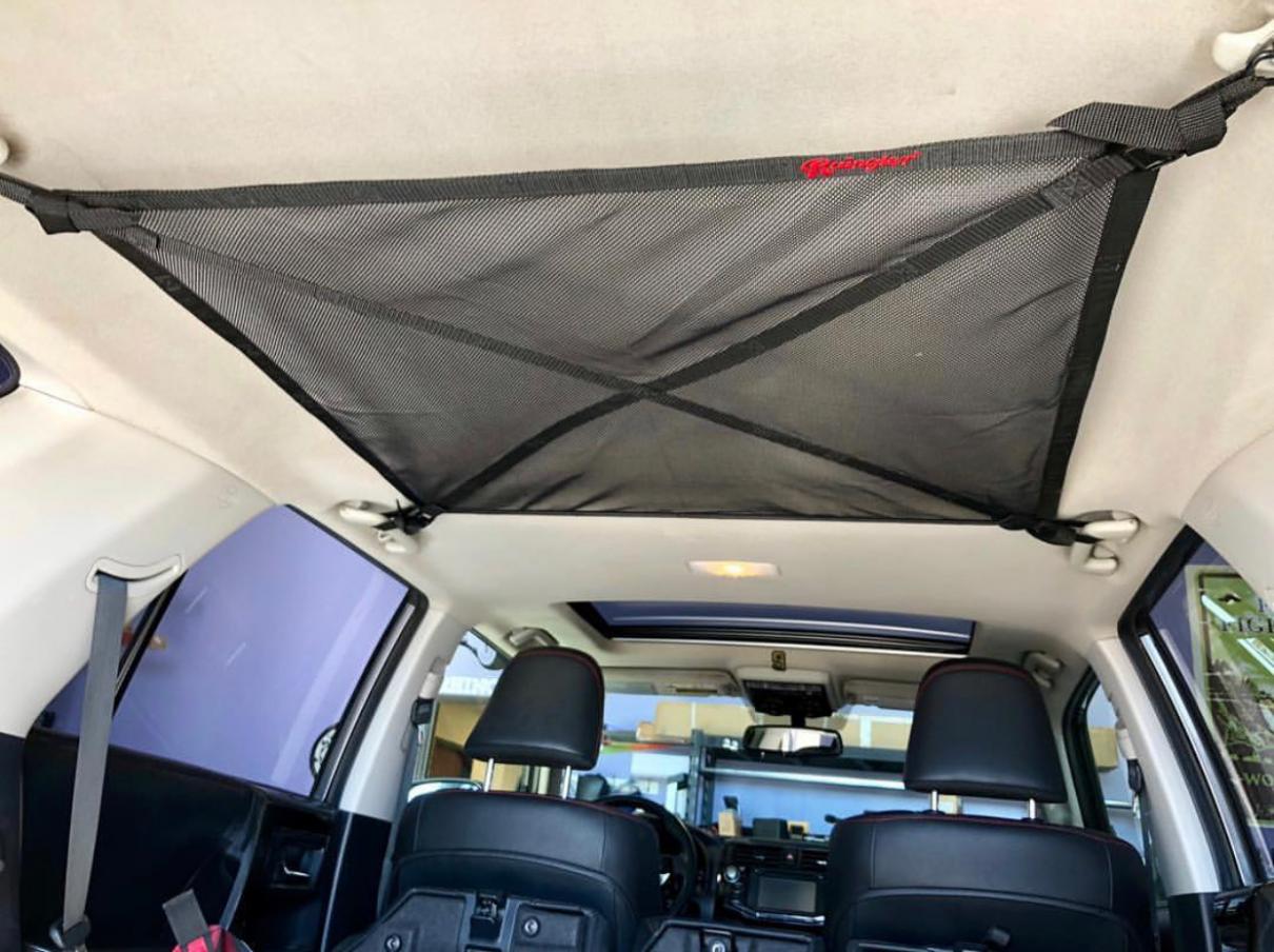

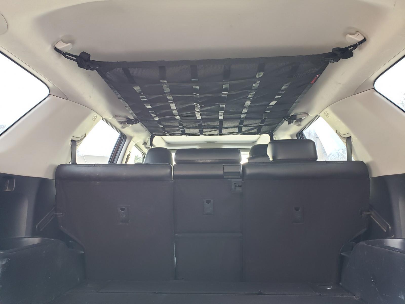

I picked up a Raingler net last year sometime and its great. I did buy a second elastic net to go over the Raingler - stuff tends to bounce out when you're offroad.
Whatever is in that net will turn into a lethal projectile in an accident, so only put shit you wouldn't mind hitting your head at 60mph in there.
