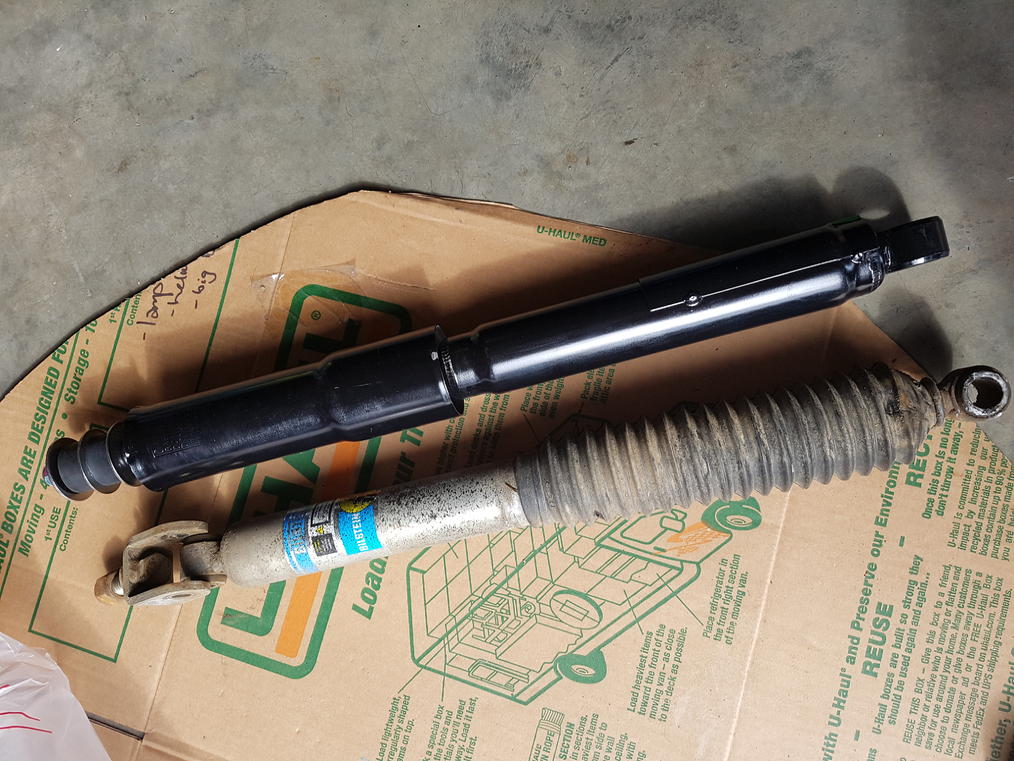

Did the swap yesterday. Used 2" OD stainless fender washers rather than the pricy OEM ones. 80 bucks cdn each for the shocks and 8 bucks for the washers.
