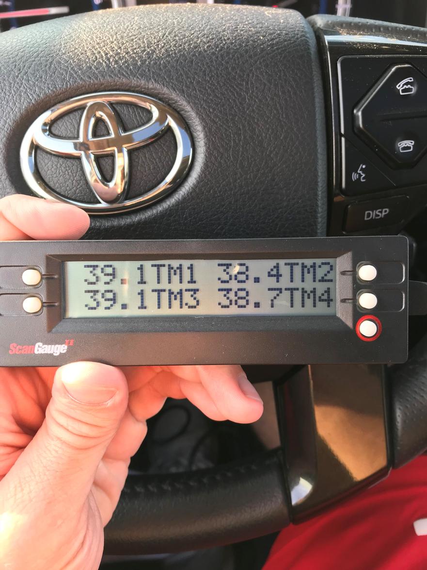

Hoping my first thread on the forum here is of benefit to a lot of you!
Over the last few months I've been working with the great people over at Scanguage trying to get some new software codes for our 5th gens. One feature I wish the vehicle came with stock is the ability to read out the Tire Pressure on the dash. I emphasized how beneficial this could be for all 5th gen owners when airing down, airing back up or just seeing where your PSI stands day to day without having to pull the gauge out.
Well the engineers at Scanguage delivered just that which works with OEM TPMS sensors! After a week of testing it out I can attest to the accuracy of the software by comparing to the hand gauge multiple times.
The people at Scanguage would like to extend the offer to any 5th gen Scanguage II owner to send in their system and get the software installed for free. Below is the email I received from the tech support rep with the details.

Hi Everyone,
I'm James DeLong, and I'm the engineer that worked on the Toyota TPMS XGauges.
can you ask if this is available for other Toyota vehicles? Second gen Tacoma here..
I believe the Tire Pressure XGauges we've come up with will work on Tacoma's from 2006 - 2015. If your Tacoma is within that range, feel free to send it in and we'll update it.
I think there's a decent chance what we've come up with will work on most Toyota's with TPMS. If anyone has a non-4Runner Toyota/Lexus/Scion with TPMS feel free to contact us at [email protected] to ask about updating their unit for free to test out what we have. Would love to test this out on as many Toyota/Lexus/Scion vehicles as possible so we can be sure it works well.

Reads spare tire TPMS? I am assuming yes.
I believe so. The parameter ID supports 5 tires. The vehicle I had to test on was simply reading 0 PSI for tire 5, but that's because it didn't have a spare I assume.
I'll send the XGauge for Tire 5 Pressure to ehcanadian see if it works.

you have TPMS in your spare?
OEM wheels for 4th gens do and seems Scanguage stated 2008 and up, this would include 2008 and 2009 4th gens.
Honestly, not sure about OEM 5th gen, 2010+, wheels.
