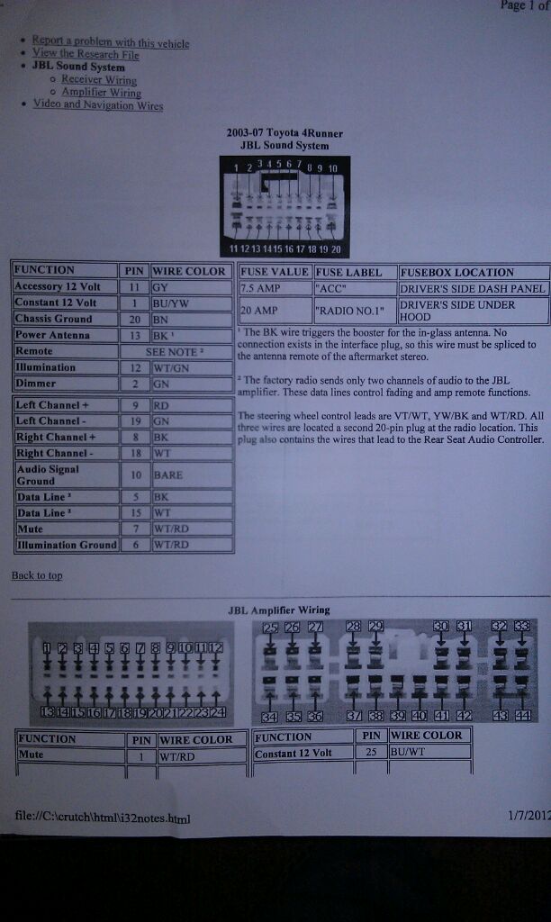

For aftermarket sub install & leaving the stock sub as is,
If you pop off the panel in the trunk exposing the sub you'll also see an amp. Get yourself a quality line driver and tap into 9, 19, 8, and 18 going into the amp. I wired my line driver and amp remotes to the 12v outlet in the back.

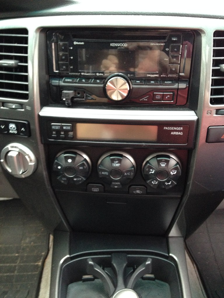

This is the one I'm thinking about getting:
Kenwood DPX500BT CD receiver at Crutchfield.com
Also, I'm ordering the LED kit today.
