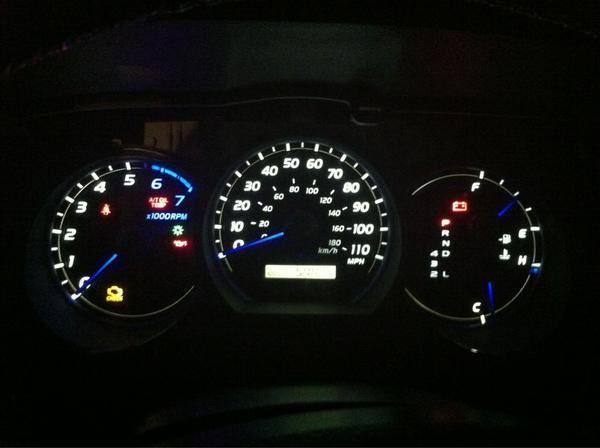

On a side note, if you are concerned about your H/U matching your OEM lighting, you might want to first consider whether or not you plan on doing an LED gauge/HVAC light swap in the future. Many of us, here on T4R.org, get LED light swaps for our gauge clusters and HVAC dash controls. I'm not sure if you have seen this yet, but essentially, you can change the color (blue, red, green, white or even a combination of colors as in the photo below) of all your gauges, switches and controls, via LED's. Here is an example of white with blue:
I paid about $220.00 to have my gauges, HVAC and steering wheel controls changed to a white and blue combination and it was worth EVERY penny. Just something to consider if you would like to get away from the OEM amber/yellow scheme. Here is a link to a thread that has some examples:

Those light swaps are BEAUTIFUL...I will definitely be doing this to my 4Runner down the road. Doesn't look too involved but I think I'll start with a new HU and figure out the LED swaps down the road.
