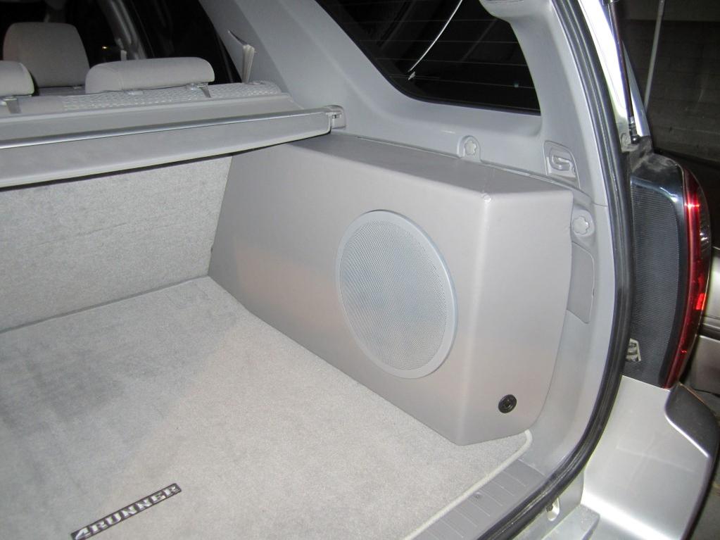

Only ones with the factory JBL system came with a sub. If your door speaker guards say JBL then it did. Other 4runners with the lower quality system have a storage compartment in place of the sub in the rear right panel in the cargo area. Not sure about RDS, but if you're redoing the system, I doubt that matters much. Buying an RDS compatible head unit will reduce your options.

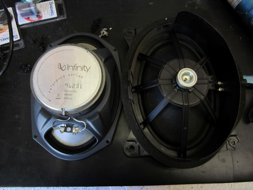

I just went through this with my 06. I settled on Kicker Speakers based on their performance vs price and built a custom subwoofer enclosure to retain the truck space. I'm extremely pleased with the results and would highly recommend you replace the stock speakers in addition to the head unit.
Pioneer MVH-X560BT Digital Media Receiver
Kicker DS35 3.5" 2-Way Front Doors
Kicker DS693 6"x9" 3-Way Front Doors
Kicker 11DS60 6.5-inch 2-way Rear Doors
Kicker 10C124 Comp 12-Inch Subwoofer
Details and Pics Here:
http://www.toyota-4runner.org/4th-gen-t4rs/175749-pparretts-06-v8-4wd-sr5-build-2.html

1. I guess I assumed the 10 Speakers + Amp + Sub was part of what made the JBL six disk system from my '05 sound so good. Could I get away with an upgrad to the HU and new speakers in just the same spots? Note: I have dogs (and I value my own hearing), so I like to turn it up sometimes, but I don't need to go crazy.
2. I take it there are no amps that could be fit into the storage box I have on my non-JBL T4R (i.e. the right side of cargo bay where JBL systems have no storage). I haven't seen anyone do a mod like this in my research so far. Is this because there are no components small enough to fit, or because most people who would bother with this mod want performance that exceeds that provided by components that would fit there?
