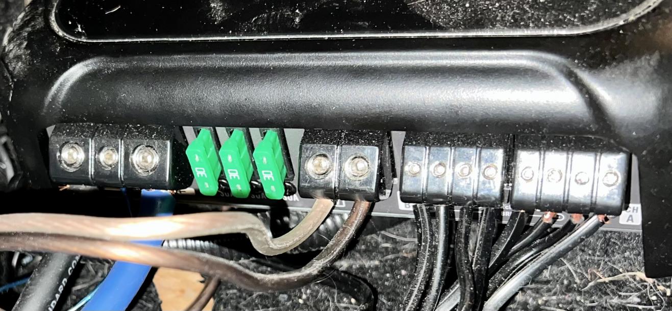

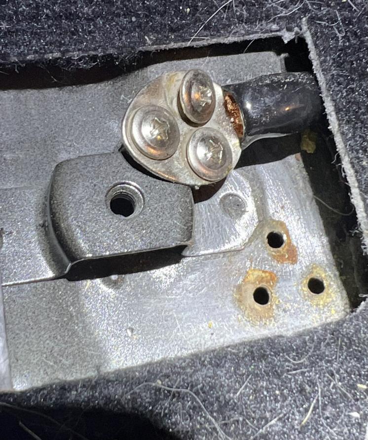

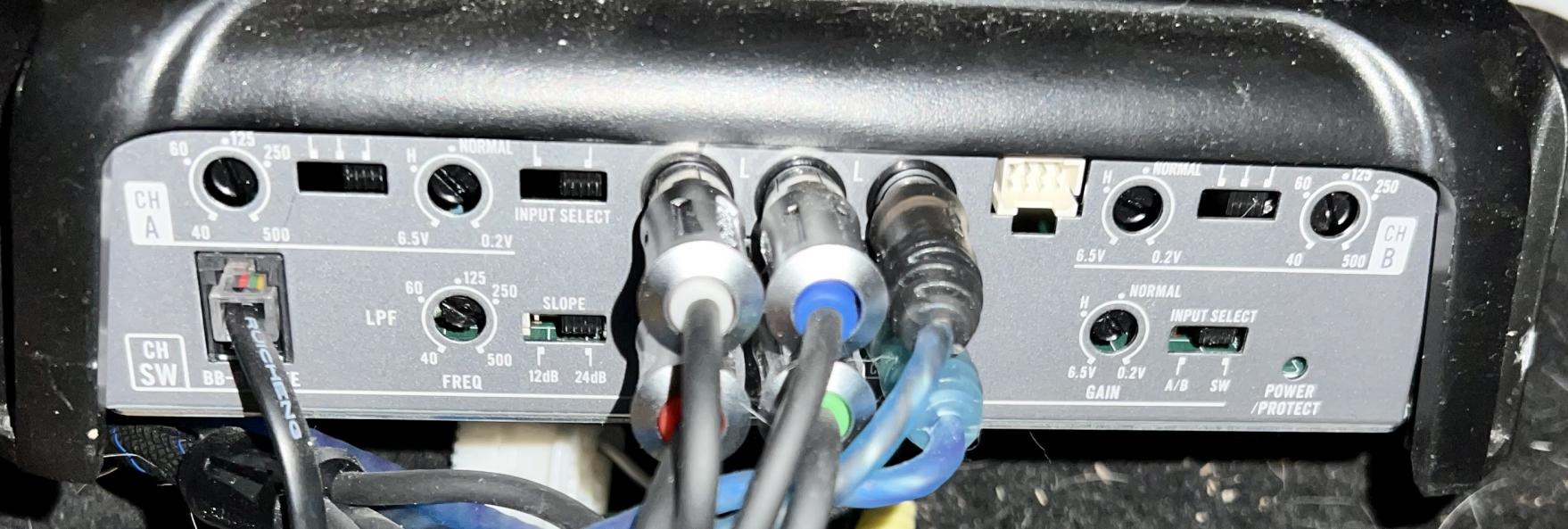

I haven’t been able to work on it since Saturday because I got the flu. Any suggestions or help would be greatly appreciated. I have attached pics with the amp connections and ground for amp. I can take more photos if it would help to troubleshoot. Thank you very much everyone!

On a side note, I *HIGHLY* recommend that you clean up the wiring around your power and speaker terminals. I'm seeing some loose wires around your power and pulled out speaker wires.
Look into getting wire ferrules (example from Amazon) and heat shrink tubing. Your wires should look something like this:
https://www.f150forum.com/attachmen...minal-ends-amp-power-connections-photo696.jpg
for the smaller speaker terminals, look for a ferrule kit that includes the crimping tool.
First one of those 2 big wires connected to the back of the unit looks like it's overheated and is discolored. Next I'd redo those grounds - clean off the rust and remove the coating on the metal buy burnishing or grinding it off so you have good ground contact. High resistance ground can cause overheating. Check your work with a meter. It should read almost a dead short (your ground connection to another known good bare metal ground point. Once you have that fixed, then coat ground connection to prevent rust or corrosion with some sealant - nail polish works.

Second thing, that ground is ridiculous and unsafe, please redo the ground and find a proper way to mount to the chassis. I have my amp mounted under my passenger seat, and found a ground in the passenger side pillar where the seat belt is located, I used that ground and it's worked great for years.
