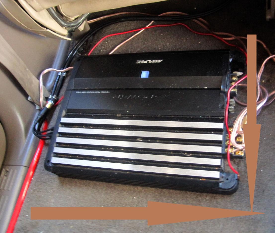

So I was test fitting the Amp under the passenger seat and noticed that there is a large depression close to the trans tunnel, presumably where the rear heater stuff would normally go, and I was wondering how others had handled this when mounting their amps? Should I use a piece of plate or plywood to make a mount for the amp, or should I just fabricate some kind of spacer to allow me to support that corner of the amp? I had also seen where someone suggested using Velcro to mount the amp, anyone got any thoughts on that idea?

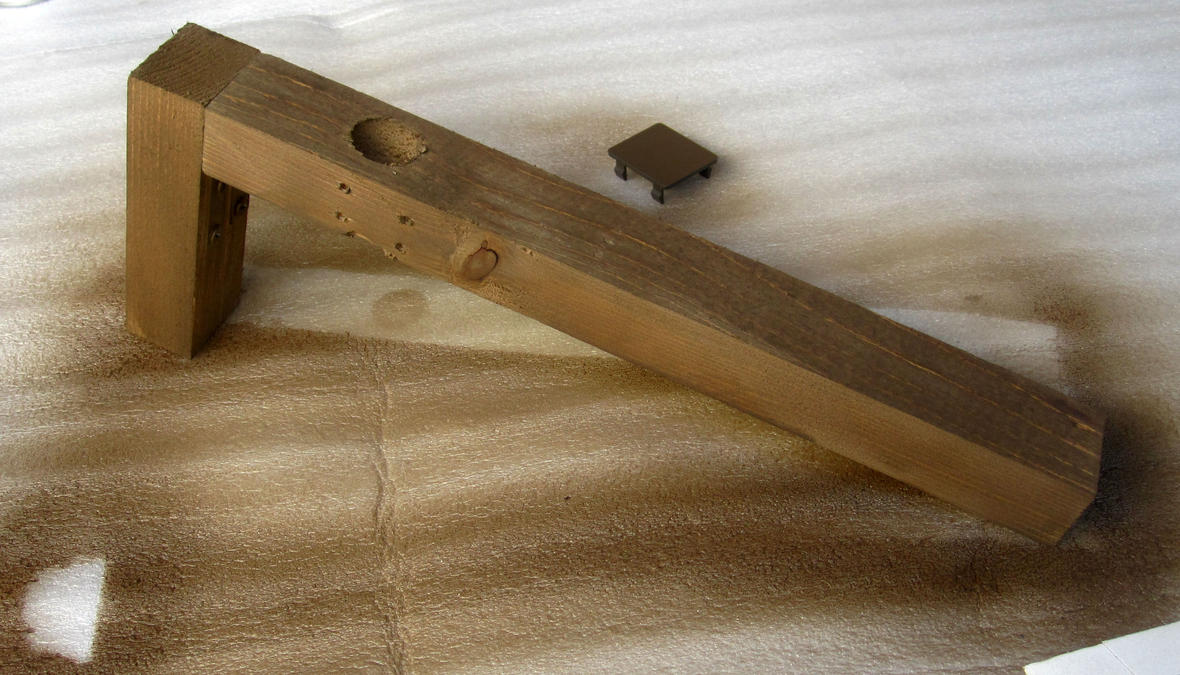

I put mine under the driver side seat.
I used this to make sure the floor appears flat to whoever sits back there ...
The floormat goes over it of course :)

i have a rear heater, so passenger seat was out of the question. I removed the driver seat, mounted my Polk PA 5000.5 underneath
If I had no rear heater, the passenger seat would have been a good choice. Stuff underneath with carpet scraps maybe?
Velcro should do fine, not like it's going to get airborne from under the seat. I used zipties thru slits cut in the carpet.
