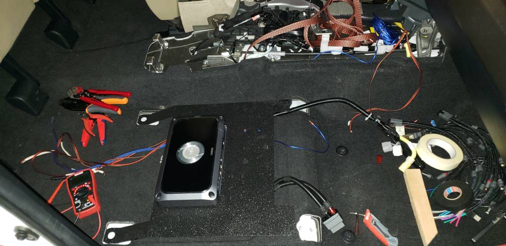

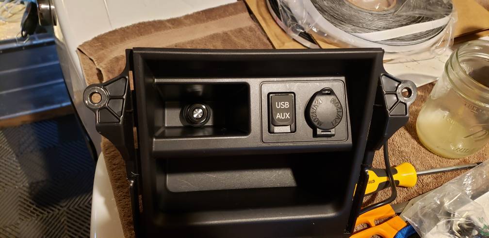

I started out thinking I'd go with OEM Audio+ and emailed them asking a bunch of questions. Then I started looking at Tacotunes...then hit Crutchfield, and thought plug and play...then COVID-19 hit...after ripping all the interior out and deadening, I decided to go the full custom route.
I'm almost done. Speakers are:
Front: Focal Expert PS 165 F (separate 6.5" woofers in the door, and separate tweeters in the dash).
Rear doors and hatch: same speakers, except coaxial Focal Expert PC 165 F.
I have an SR5, so had to get the factory sub enclosure and mounted a JL Audio 8w3v3-4.
Head unit: decided on a Kenwood Excelon Reference DNX997XR.
Amp: JL Audio Vx800/8i with integrated DSP. Feeds 75w/channel for the speakers and 200w for the sub.
Working in the amp now. Just mounted the master volume/bass knob. 20200606_164356.jpg20200606_164449.jpg

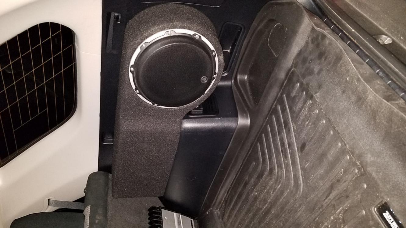

I made custom fiberglass enclosure for rear pocket. In front have 6.5" woofer and tweeter in front door using 6x9 adapters 4" midrange in dash . Rear doors 6.5" woofer and tweeter. I ran all new speaker wires into doors and dash from amp. the factory speaker wire is too small a guage to run amp power through. Not running any speakers in rear hatch i wasn't up to try to get new wires in there. Still have access to outlets.
