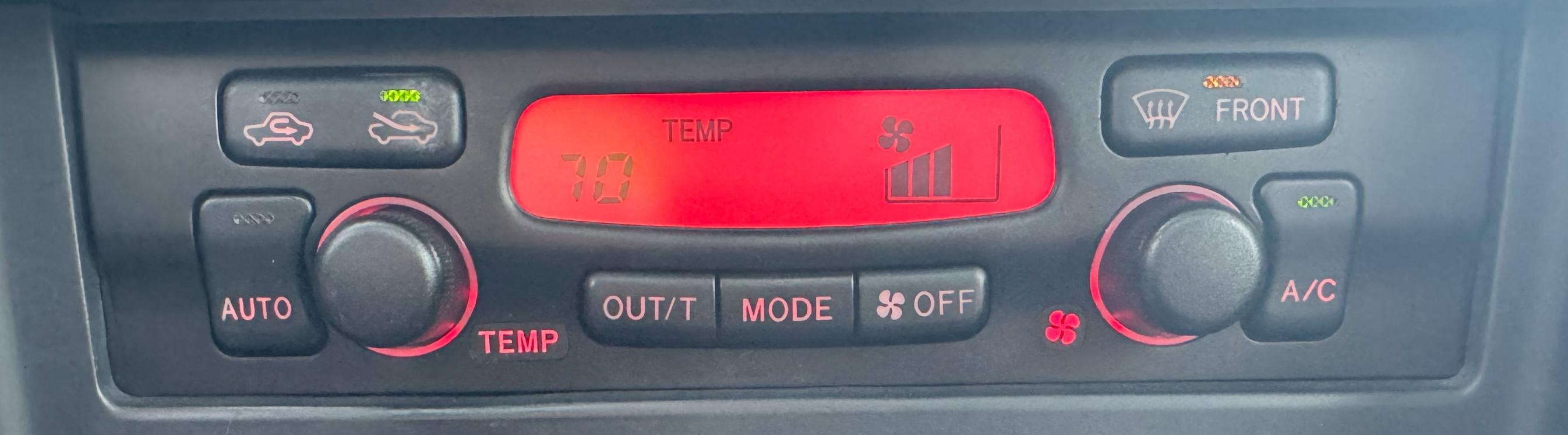

John does it again!! Haven't had control over my AC for around 5 years. Finally got fed up with it and came across this post. Contacted John via email and he got back to me within a day or two.
Turnaround was pretty quick, by the time he received it I think he had it back out in the mail to me within 48 hours or so. Can't thank him enough! Not only for getting the dang thing working again, but also loving the red LED color swap!
