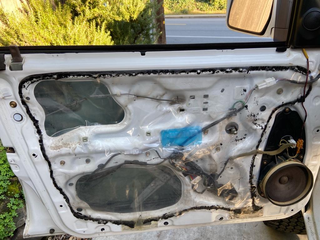

Hi, I’m trying to convert my ‘99 T4R from crank windows to power windows. It came stock with power windows and all of the wiring is still in the doors so it should just be a matter of bolting in the new motors, plugging in the switches, and putting the door panels on.

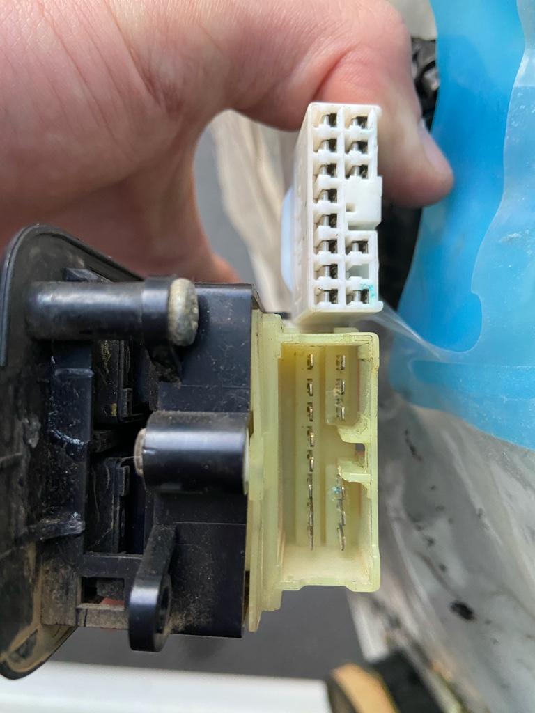

When I got home, I took off my drivers door panel to test out the switch, and realized that they had given me the wrong one. I believe the one they gave me is off a ‘97 and it has a small piece of plastic that stops it from being able to be plugged into my wires. On all of their paperwork there is large print type that states they will take a 25% restocking fee on any item returned. I’m hoping to avoid this and I’m wondering if anyone has any ideas or advice for dealing with this or fixing it. I’m wondering if I just shave off the restricting piece of plastic if it will work? Any help is greatly appreciated!
i believe there were two different harnesses, one had auto windows for both front windows. while the older had auto down only for driver front window. i believes the years are 96-98? and then 99+ should be the same? so you are gonna have to get parts from a 99+

You are right on the money. The harnesses are different on all 4 doors on 99+ after they added the auto function to the passengers side.

Thank you all for the clarification. I appreciate the help. I guess if there’s a silver lining to this it’s that my passengers will enjoy their automatic window.

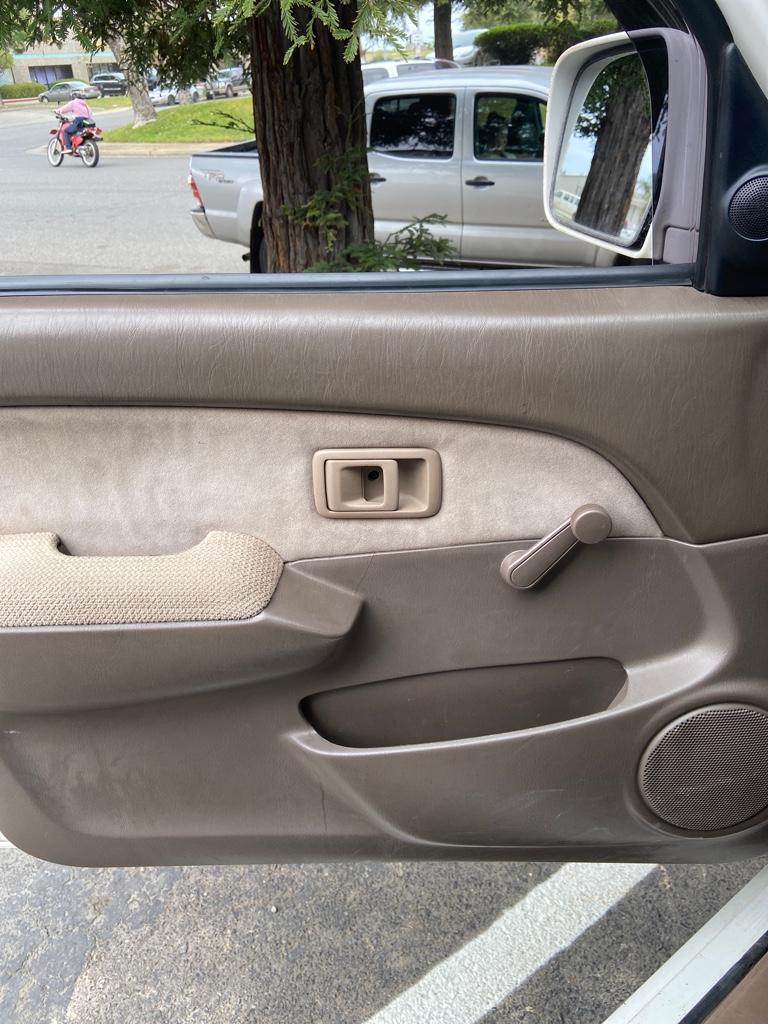

Yeah it’s a very interesting situation. So the truck is an SR5, it came with power windows, locks, etc. The previous owner converted the power windows to cranks, but luckily left all the wiring in. He also disabled the rear window. Since that is a feature I’m really into I’m hoping that all he did was turn on the window lock before removing the switch panel.

I would love to eventually confirm, but it would be my guess that a crank window truck would be pre-wired for the power windows. I'm only assuming that they wouldn't have built different body harnesses without the minimal wiring the windows and locks take for the small amount of 4runners that didn't have power.

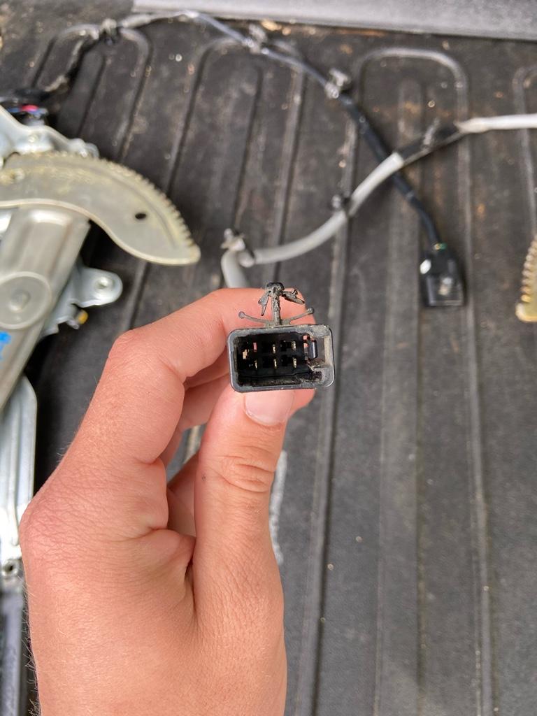

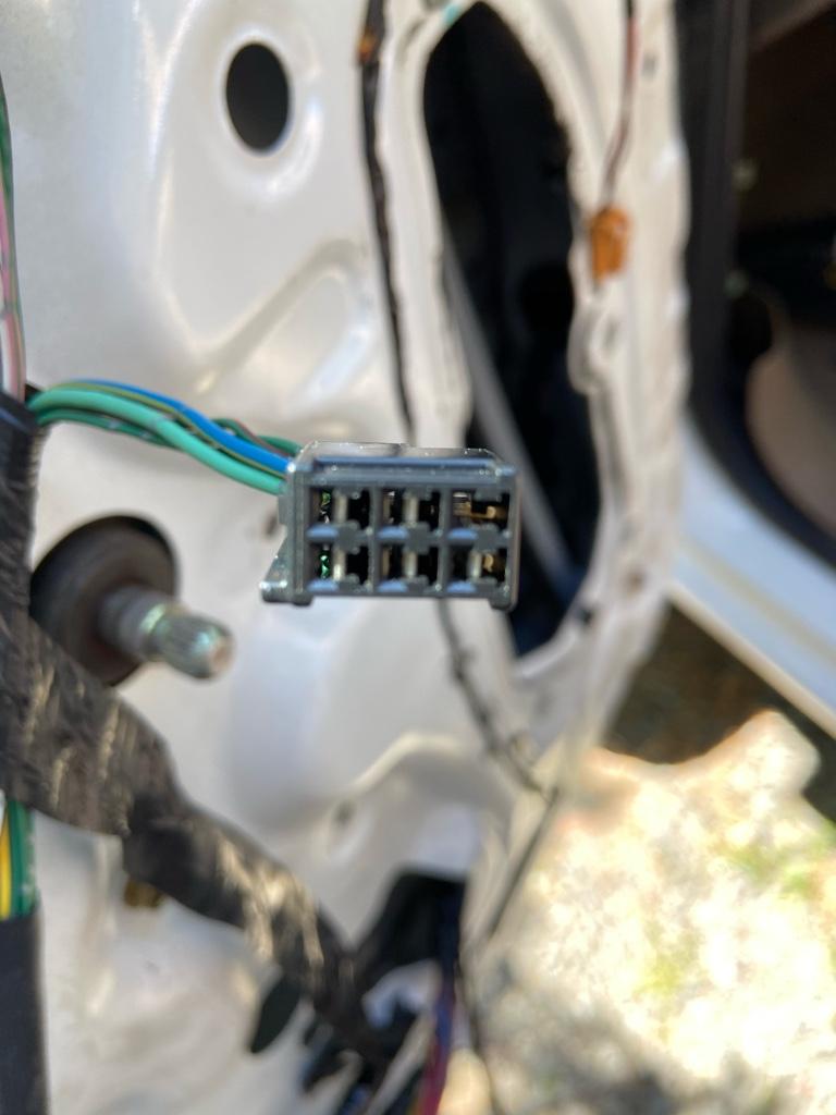

Today my dad and I were doing the conversion and we had an issue with the wiring harness that goes to the motor, from the door. Mine looked like this, and the motor had a white, circular, two pronged connection.
We spent over an hour trying to figure out if this was a result of the PO’s modifications. Finally I did some research and found out that even the motors for the ‘99+ 4Runners are different, due to the auto window function. So I drove back up and exchanged for the right ones. Tomorrow I should have power windows. Hopefully this is helpful for someone in the future.
