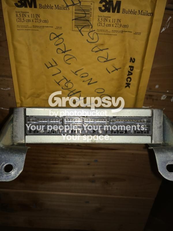

I am having a hard time finding the connectors for the replacement 5spd ECM. found a thread that had part numbers BUT, dealer ordered and they were not correct
98 ECM 5spd 4x4 V6
Calling LKQ tomorrow to see if they can get a wiring harness, but was hoping to just repin the existing harness

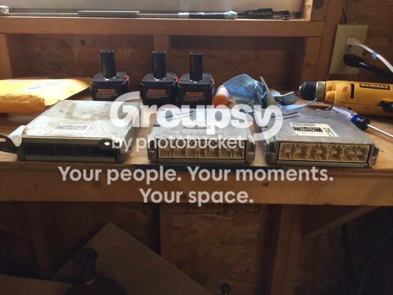

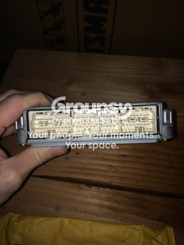

The ECM plugs should be the same between a 1998 manual and a 1998 automatic. I know because I did this swap on a 1998 and just repinned the harness. If your ECM plug receptacles on the ECM are different something isnt right. You may have a Tacoma ECM. The plugs are different between the Tacoma and the 4Runner. Will try to get a picture uploaded for you when I can get photobucket to work.
I don't know how to say it any other way. 4runner. 96-97 manual and auto have completely different ECU. Meaning: different connectors and pinouts.
98-02 it's plug and play between auto and manual.
Ofcourse Tacoma will be different.
I don't see why you couldn't repin. After a repin your only losing the auto transmission pins.
Yeah - fella above was talking about a 1998. If his ecu and wiring dont match up he either has a ecu from a Tacoma or a pre-1997 ecu. I included the Tacoma photo because parts sites often list Tacoma parts as interchangeable.
