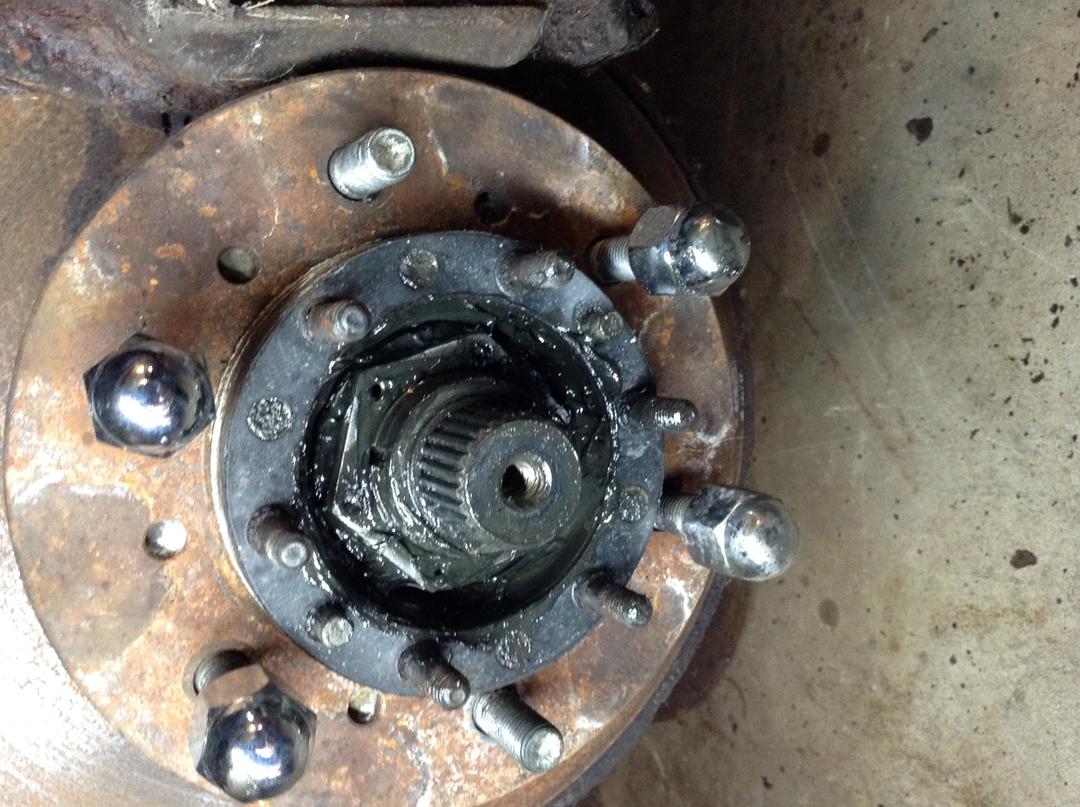

Alright, I'm back again and this time I bought Aisin manual locking bubs to put on my 1988. So I took off the auto hubs and was ready to put on the new ones, then i realized it looked like things were missing. I'm not sure what is missing if you could tell me what i need to buy that would be greatly appreciated thank you. toyota hubs.jpg

If that is all you have you are missing the whole manual free wheeling hub assembly. You will need both the hub base and the cover, as well as the two seals and the bolt/washer for end of axle. I can't tell but you may need the spacer and snap ring but it looks like they are on the end of the axle.
Pics for reference.
http://www.se4rj.com/forum/showthread.php?t=293
I do have the manual free wheeling hubs, but i wanna make sure that this is enough, it seems like i should have lock washers or lock nuts too help the stability. But yes i do have the hub and the for it.
