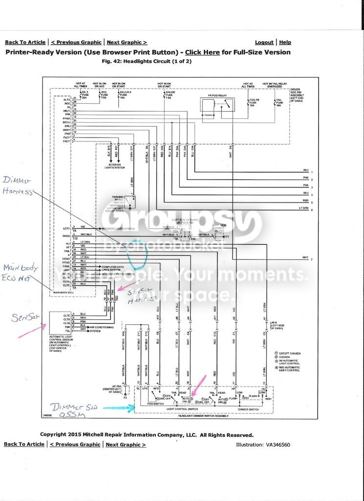

Hi Bimmer-Bob,
I'm leaving this 5'th gen 4Runner 'limited' Headlight circuit diagram here on this thread; hoping that you (everyone) will accomplish your goal. I took a quick look at the diagram and marked the essentials needed to make it work, "see below":
It looks like you'll need only four parts as noted by the I.D. labels in pen e.g., the Headlight dimmer switch assm, Dimmer SW. harness, Automatic light control sensor, and the Light control sensor harness. The Main body ECU Network compu are ALL the same from 2010 to 2015, so no changes needed there.

That's EXACTLY what I was looking for. Thank you! I think I'm going to give this a shot if I can find the parts for a reasonable enough price.
