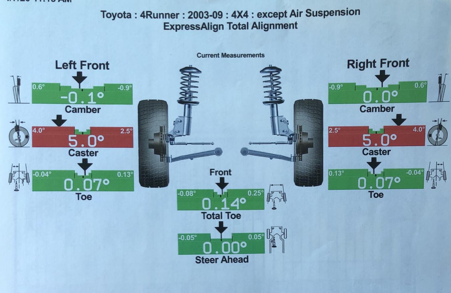

Going to get my Alignment Done this am to adjust my Caster. Since I had No Issues with my Drivers side at 5 thats what I am shooting for for both sides or Close to it.
Caster is set At 5° Both Sides. I will be lifting a little more when I Go with Dobinsons IMS Set Up soon. Thanks to Pep Boys for putting me through so much BS, and doing exactly the opposite of what I Asked. Get your Frame Pulled..Pull your Pecker's you F'ing Dummies and Don't Lie like Mother F'ers to people!!!

Wow you got +5.0 outta the JBAs? I got a bit over 4 on mine, but I didn't ask them to try to push it to the max. Maybe because I'm lifted slightly higher?
