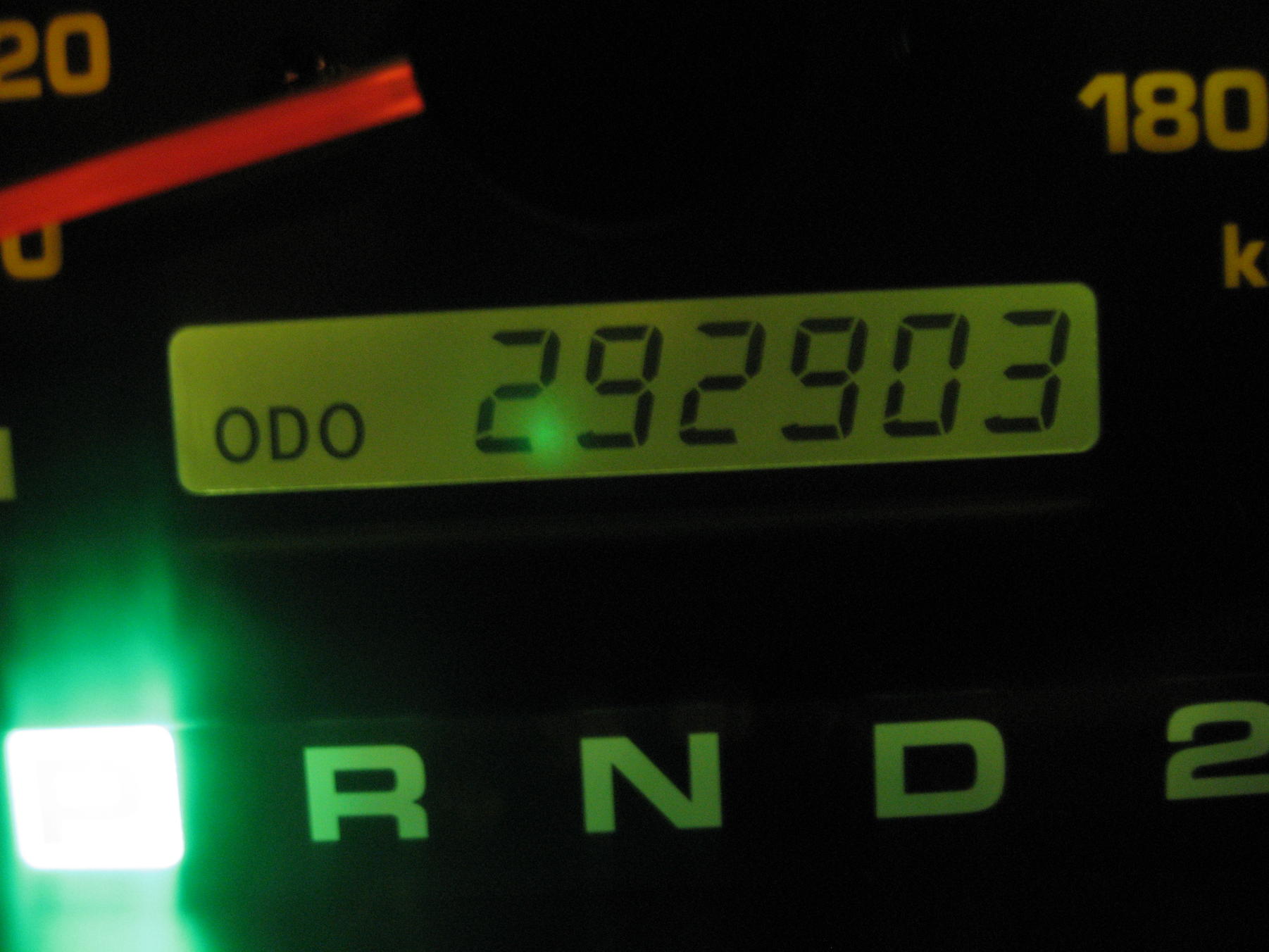

Odometer Picture
Sorry guys its only has 294,000. I put in 394 by mistake. Its still mint condition with mostly original parts. My last one had 390K.How do you post pics?
Odometer pix
Hereis my odometer today
